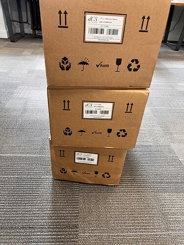

Interesting boxes showed up at the office today :face_with_monocle:

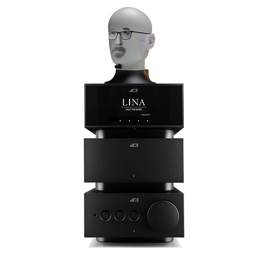

dCS does not recommend stacking their components :laughing:
But seriously, they don’t, yet with the Lina they actually recommend it.
Well I’ve only unboxed the Lina DAC so far and have that paired with the Forge. It’s a very interesting contrast to the Mytek I had on my desk previously. Need a lot more listening time but right now the chain is iMAC —> dCS Lina DAC —> Forge 8/100 —> Utopia and it’s sounding pretty incredible.
I played with the Crossfeed a little bit but that seems like a feature I’ll probably leave off while using it.
