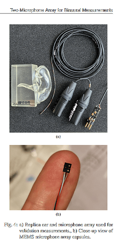

Robust Binaural Measurements in the Ear Canal Using a Two-Microphone Array, 2023 August
In the audiophile community there’s often mentions of “Everything you hear is just frequency response at the ear drum”. However with no accurate ear drum level measurements, and blocked ear canal measurements not painting the whole picture of a person’s HRTF, the debate circles on without resolution.
Researchers at Sweden tried a new method of using two MEMS mics in order to get an accurate ear drum level measurement that works for non Free air equivalent coupling headphones (which means, basically all “normal” headphones we wear)
Could this spark a new step forward in understanding what makes good sound? It certainly looks simply enough that a crafty DIY person could attempt it. Hopefully the more technical minded of the community could have a look at the paper linked above and voice their opinion on this method.

I hope you guys could look into this, maybe contact the authors of the paper. I’d be very curious to see if you could unravel the mysteries of “All sound is just FR at the ear drum”, now that there’s a way to do measurements. Might make for an interesting video talking to the authors and see what they think about this topic, maybe they’ll send you some little mics to stick into your giant head!
