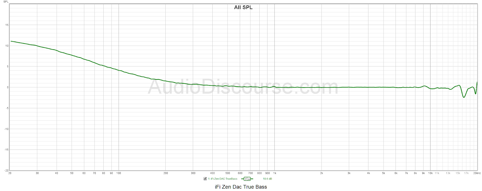

Also on the front of the unit is a Power Match button which essentially toggles low and high gain, a True Bass function which adds a 10dB Bass Shelf starting around 300Hz, and a good sized analog volume knob. Behind the knob is an LED indicator light that tells the user which music type is being decoded.
