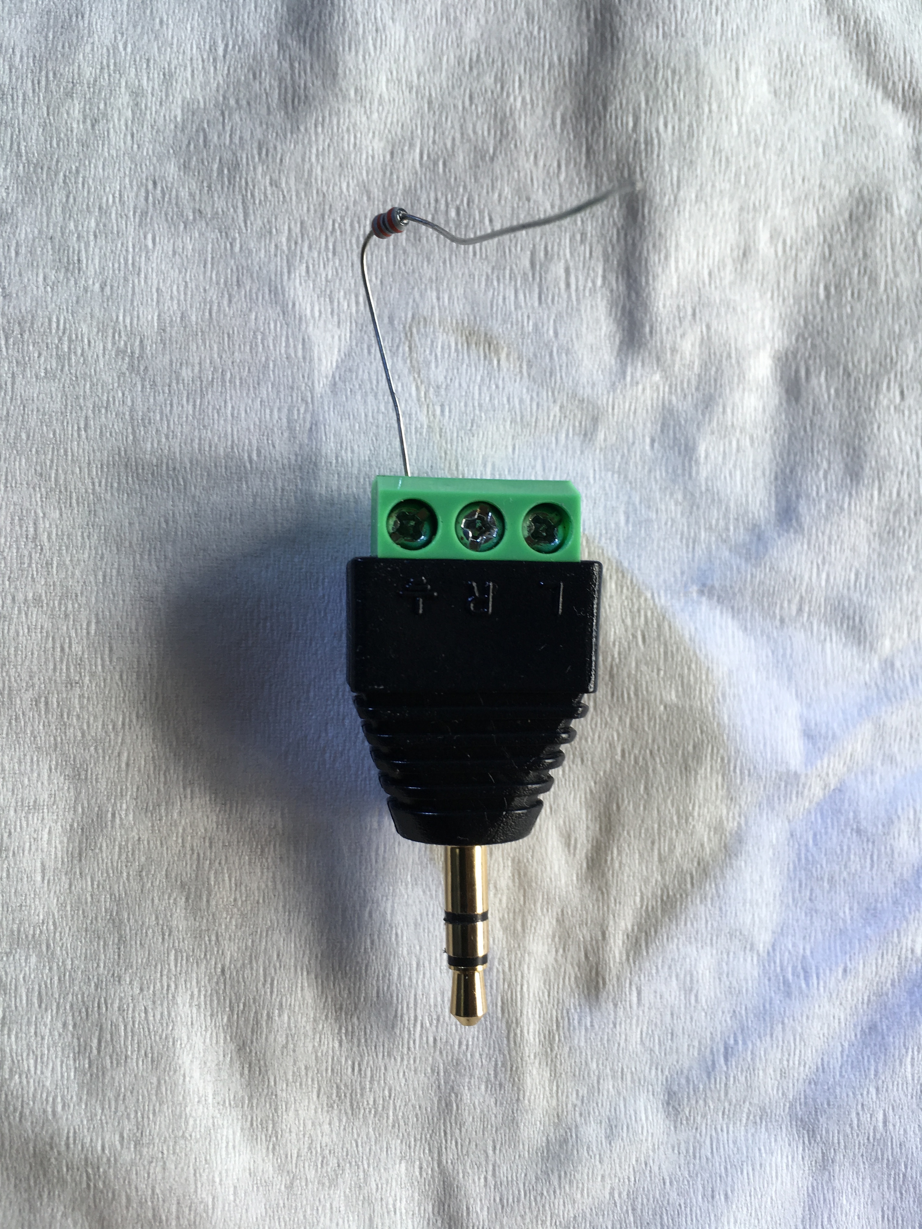

[EDIT] I completely revised this post because I initially wired my test load incorrectly, with the load in parallel to where I was measuring voltage instead of in series. I’ve now corrected and re-measured. This approach also didn’t involve burning any resistors
Disclaimer - I’m not an electrical engineer, nor do I play one on television, nor am I even a competent electrical hobbyist. Don’t try this at home, you might damage your equipment and/or cause a fire.
Since it seemed fun, I ran a little test
First, I constructed a fake 22 ohm load using a screw-type 3.5mm plug and a 22 ohm resistor.
Then I played a 50 Hz sine wave test tone at -3 dBFS using Room EQ Wizard (nothing special about the program, but it allows me to generate test tones).
I then used a true-RMS multimeter to measure the output voltage between the left channel and and the resistor connected to ground, from a variety of devices:
Macbook Air at Max Volume - 1.33 Vrms
Macbook Air -> Magni 3 at Max Volume, Low Gain - 2.601 Vrms
Macbook Air -> Magni 3 at Max Volume, High Gain - 8.63 Vrms
Macbook Air -> Topping NX4 at Max Volume, Low Gain - 1.33 Vrms
Macbook Air -> Topping NX4 at Max Volume, Low Gain, Bass Boost On - 2.33 Vrms
Macbook Air -> Topping NX4 at Max Volume, High Gain - 3.60 Vrms
Macbook Air -> Topping NX4 at 2 Vrms -> Magni 3 at Max Volume, Low Gain - 3.97 Vrms
Macbook Air -> Topping NX4 at 2 Vrms -> Magni 3 at Max Volume, High Gain - 12.53 Vrms
Macbook Air -> Topping NX4 at 3.39 Vrms -> Magni 3 at Max Volume, Low Gain - 8.26 Vrms
Macbook Air -> Topping NX4 at 3.39 Vrms -> Magni 3 at Max Volume, High Gain - 15.13 Vrms
Then I calculated the gain for all of the amplifier scenarios scenarios by dividing the output voltage by the input voltage:
Macbook Air -> Magni 3 at Max Volume, Low Gain - 1.96
Macbook Air -> Magni 3 at Max Volume, High Gain - 6.49
Macbook Air -> Topping NX4 at Max Volume, High Gain - 2.71
Macbook Air -> Topping NX4 at 2 Vrms -> Magni 3 at Max Volume, Low Gain - 1.99
Macbook Air -> Topping NX4 at 2 Vrms -> Magni 3 at Max Volume, High Gain - 6.27
Macbook Air -> Topping NX4 at 3.39 Vrms -> Magni 3 at Max Volume, Low Gain - 2.43
Macbook Air -> Topping NX4 at 3.39 Vrms -> Magni 3 at Max Volume, High Gain - 4.46
So on low gain, the Magni 3’s gain does not go down with input level, however on high gain, it does seem to go down a bit with input level, especially once you get past 2 Vrms in.
P.S. It was also interesting to learn that the NX4’s low gain is in fact unity (1) and that the bass boost at 50 Hz is nothing to sneeze at.
