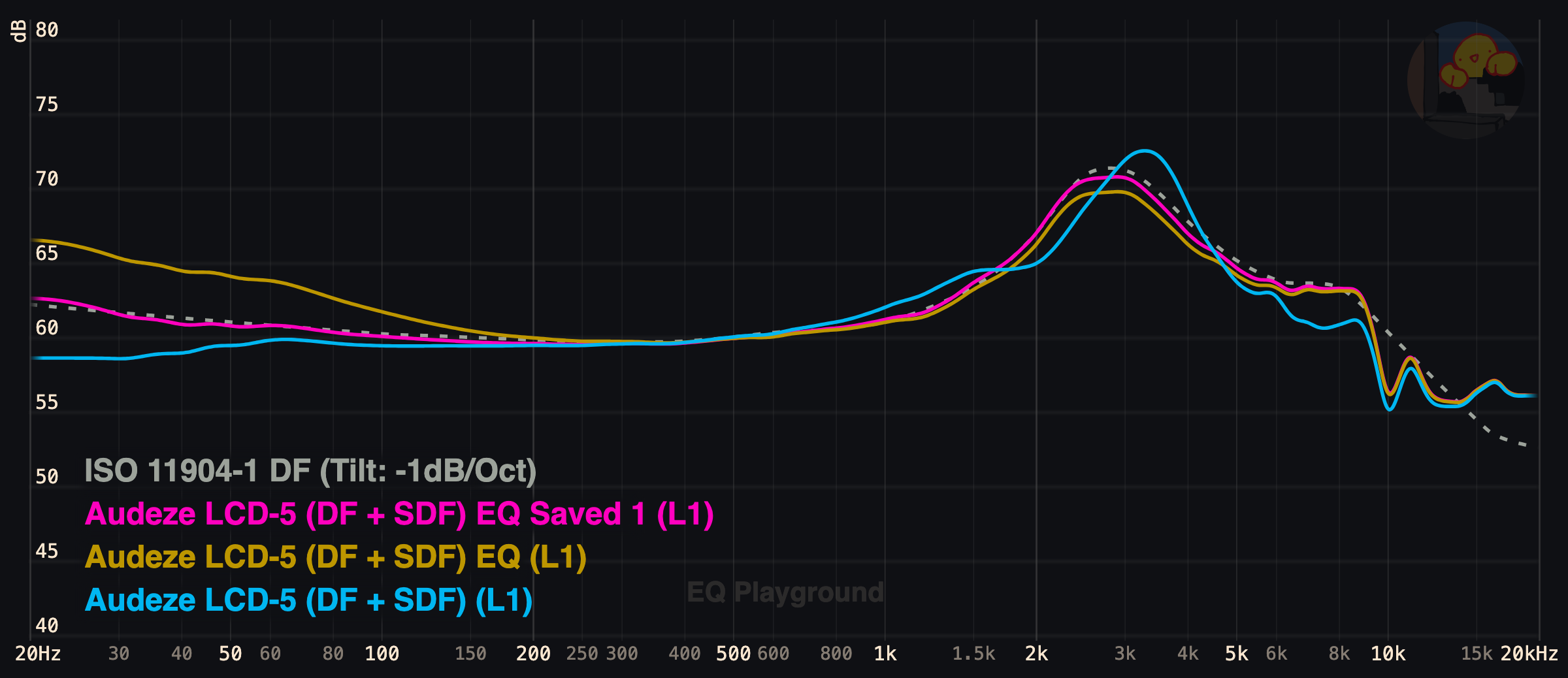

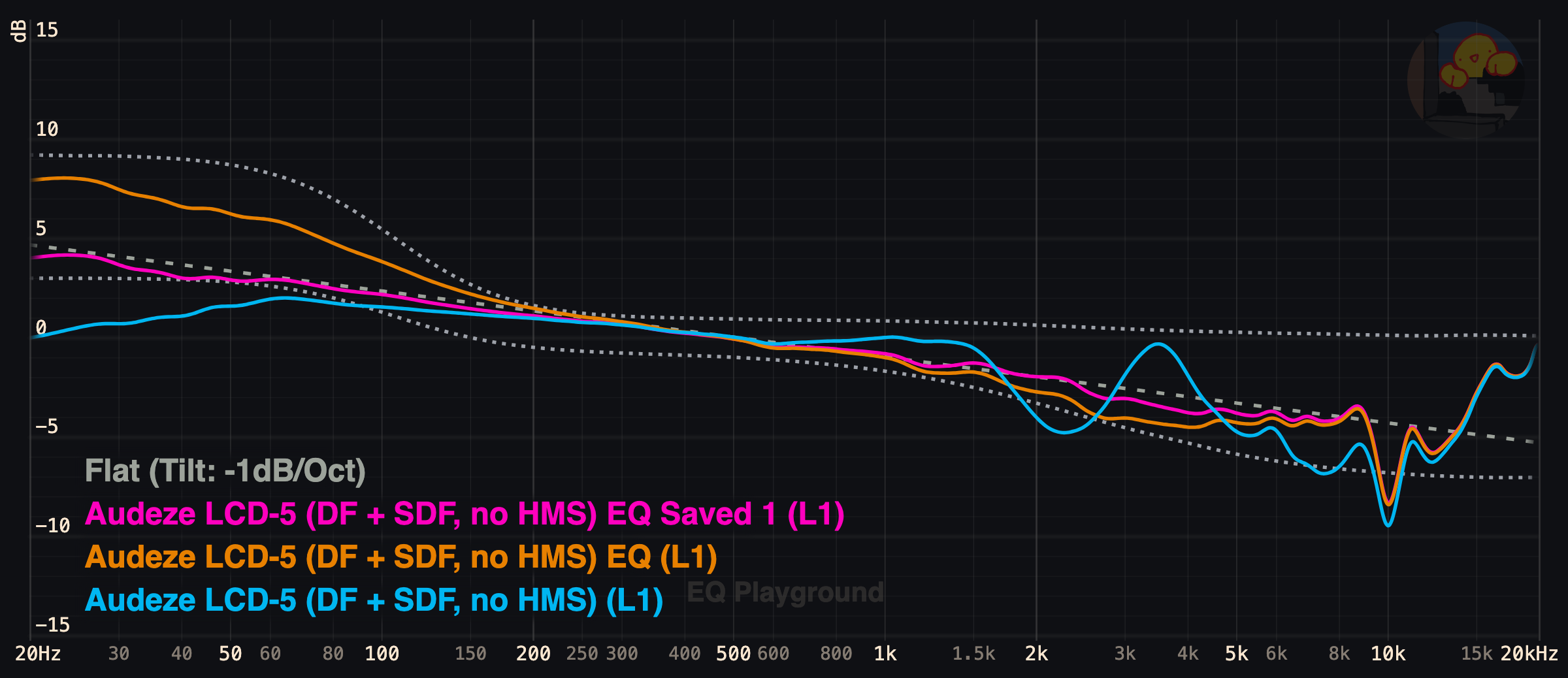

Hello audeezer, feel free to sniff this bad boy if you’d like:
Preamp: -7.9 dB
Filter 1: ON PK Fc 20 Hz Gain 4.0 dB Q 0.700
Filter 2: ON PK Fc 100 Hz Gain 0.3 dB Q 1.400
Filter 3: ON PK Fc 1350 Hz Gain -1.8 dB Q 1.400
Filter 4: ON PK Fc 2250 Hz Gain 3.7 dB Q 2.000
Filter 5: ON PK Fc 3550 Hz Gain -4.6 dB Q 2.100
Filter 6: ON PK Fc 4800 Hz Gain 1.2 dB Q 2.400
Filter 7: ON PK Fc 6000 Hz Gain -1.3 dB Q 4.200
Filter 8: ON PK Fc 7200 Hz Gain 3.0 dB Q 1.400
Filter 9: ON LSC Fc 89 Hz Gain 4.0 dB Q 0.600
Filter 10: ON PK Fc 2800 Hz Gain -1.0 dB Q 0.800
Adjust gain of band 9 (89 Hz) for B A S S
Adjust gain of band 10 (2800 Hz) for overall intelligibility and texture, as well as potential shoutiness
If you’d like to adjust overall treble level, add a PK filter at 7000 Hz with a Q of 0.2 and adjust gain to taste.
Blue is without the last 2 bands activated, purple is with them activated.
If thou need’st make further adjustments or remove bands, do feel free! Interested to know how it compares to the other EQs you have.

Did u derive these contortions from a sample heard or via other apparitions?
I’ve heard a few units and these are the changes I felt necessary. Full disclosure, I’d probably make more fine grained adjustments in the treble than I gave you (would cut around 10kHz for sure) but this should at least be a decent starting point.

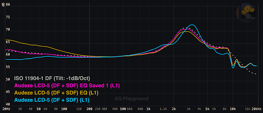

Last evening I trialed.
Your guesstimate well dialed.
I tested and revisited many I have collected over time with immediate toggling, capable through HQ Player client with and without my preferred HQP modulators.
The 10 band as posted was used. A very pleasurable result with emphasis on bass amplitude and midbass support. Presenting traits I would describe as round. However, round may have many meanings. While enjoyable, this presents as slightly bloomy but not boomy or muddy in any way with tactile qualities still retained. However, in totality, overshadows the midrange compared to the Accurate Sound filter. Which remains elusive in any other experience I have had to date.
With the 10 band along with other HQP filters and modulators, there were settings that became better than with my standard HQP preference, lending to the idea that further dialing in shall be possible with the tool at disposal in any setup. Along with further EQ tweaks, there is high chance of approaching favorable preference.
Most others are rather enjoyable such as those from as Resolve v3, AudioTool, Essential and other presets.
In comparison, most notable was bass level or presentation relation to midrange.
I imagine sub bass relation and level could be variables in from source gear, heads and headpiece.
Essential has more recess in midrange and more sub emphasis.
Resolve v3 has more prominent trebs.
8 band blue line is severely lacking tonal weight.
Interesting notes, thanks for trying it out!
And yeah, I think since most of the EQing I’d done wass about rebalancing by boosting bass vs. LCD-5’s forward upper midrange, you wouldn’t get the same effect as Mitch’s EQ (which iirc is flat bass and a significant reduction to the 2-5kHz region).

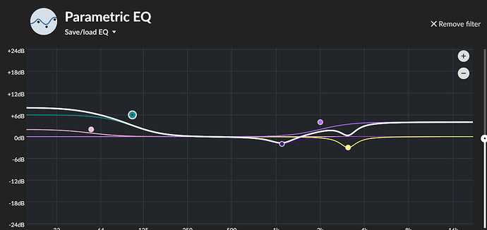

@metal571 I’ve searched everywhere but couldn’t find your EQ preset for the LCD-5. Could you please share it? I really liked your EQ profile for the LCD-X among all the ones I’ve tried, and I feel same will be true about the LCD-5 EQ
I’m enjoying your EQ profile, it’s the only one that really captures the changes I was looking to make, I just made a few adjustments, on the bass I used Andrew’s low shelf filter as a start but with less energy. 42hz 1db, 83hz 3db. Then from 1350hz onward I used yours but changed 3350hz to -3.6db. I would not change anything else nor would I mess around with the treble. Thanks for sharing.
