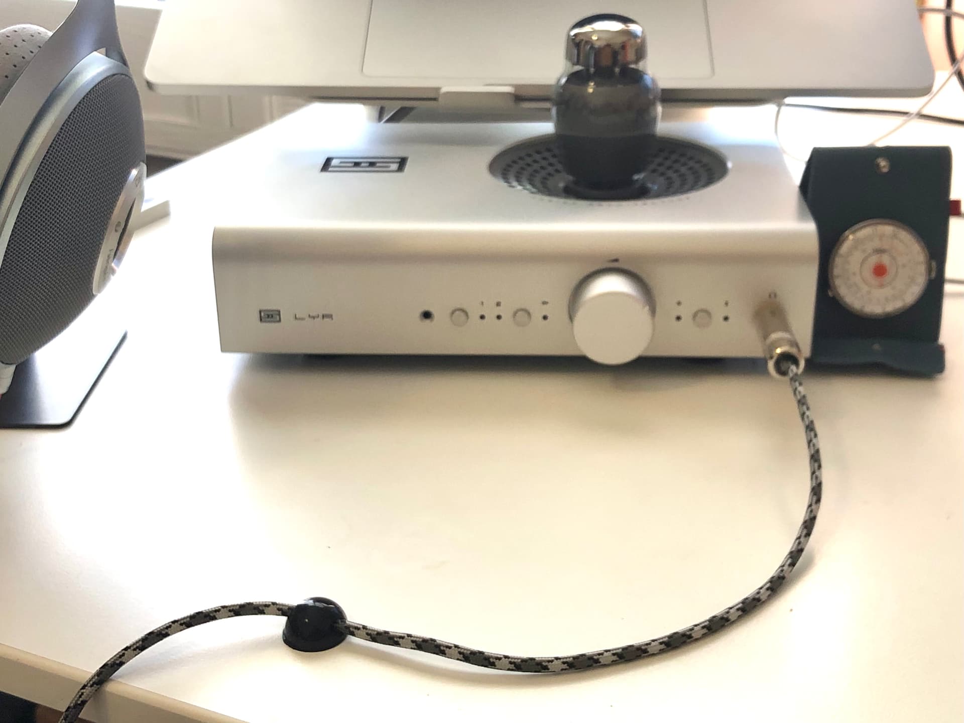

I upgraded the Lyr+'s LRF support as you suggested. I ended up using a set of Isolate It! Sorbothane feet. Sorbothane is supposedly superior to rubber and Isolate It! has a variety of sizes and Durometer (stiffness) ratings to tune the feet to the proper weight and application. I went with the 1" 50 Durometer as the Lyr+ is 6lbs and their website recommends 50 Durometer for audio equipment isolation. I would think 30 Durometer more ideal, but they are the experts.
I also drilled a hole in a rubber foot I had around, ran the headphone cable through it, and stuck it to the desk. This dampens the vibrations from the cable and also moves it further to the left and out of my way:
The combination is not enough to kill the microphonics in high gain, but it does improve low gain microphonics. I’m not sure I’ll leave the cable dampener there - aesthetics again. But the Isolate It! feet were worth the investment.
I’m warming up to Herbie’s Audio Lab Ultrasonic SS as well. I don’t really need to solve the microphonics completely, but I’m curious as to how much of a difference it makes.
I love your cable solution.
If you want to experiment with some more budget isolation solutions, I like these ball bearing isolation feet, which only cost around $20-25 for 4.
I use them to drain vibration from the electronic device into a wood or mdf base (whatever I have lying around) and then sorbothane feet like yours under the wood to protect it from the desk underneath. In your case you’d be getting vibration out of your amp and isolating it from vibration coming from your desk. In theory at least.
