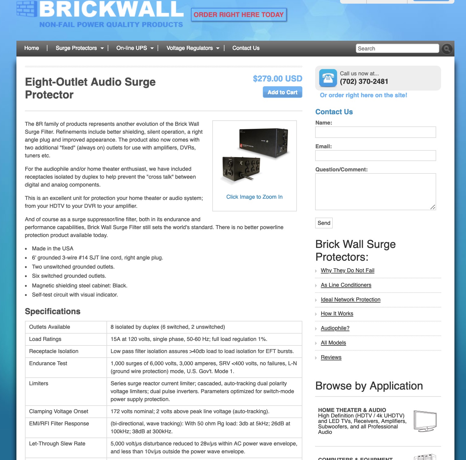

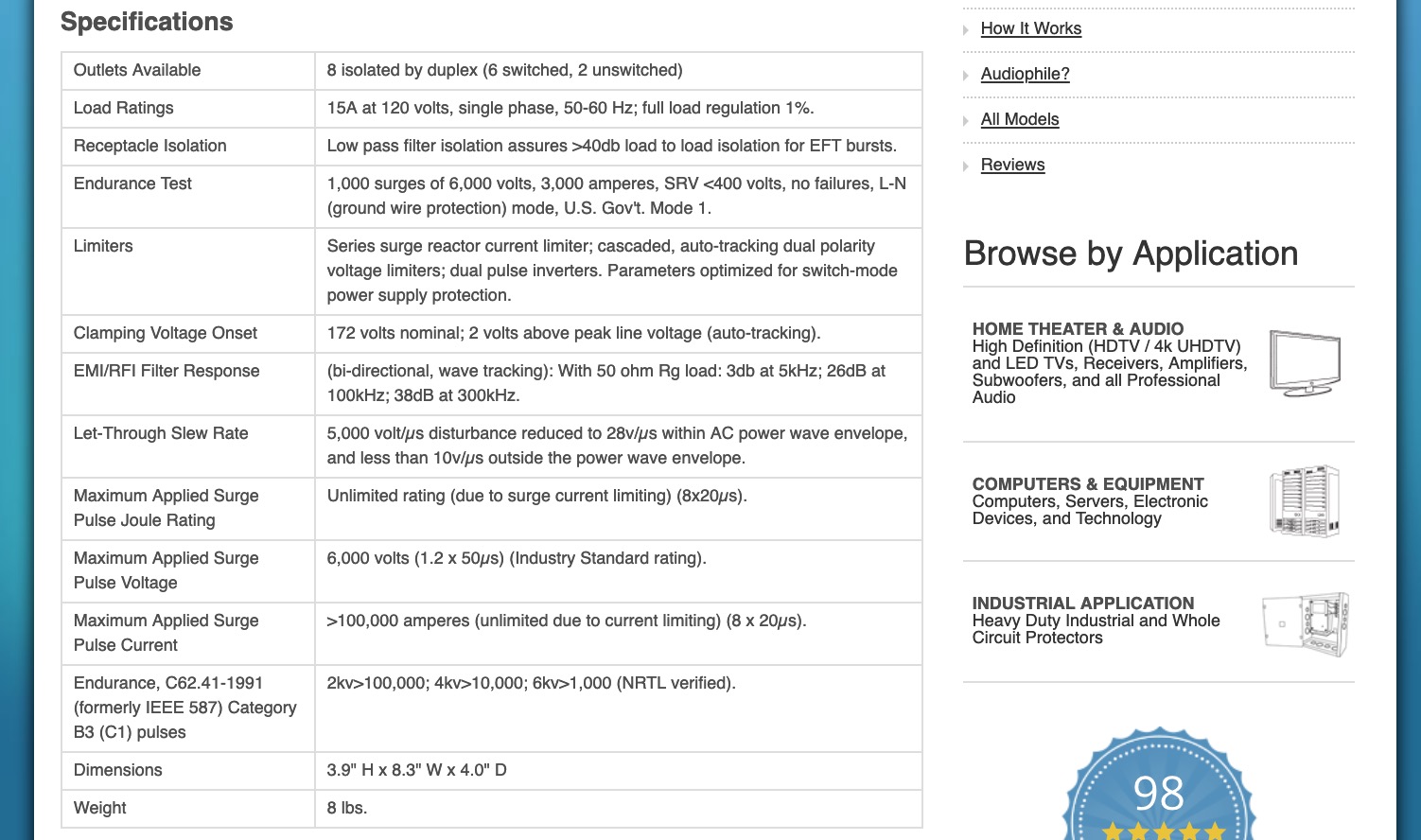

To be of further help, I’d need to know what your “Brickwall outlet” is, as that sounds to me like the socket on the wall.
I’m hoping these images will be enough info:
I have a SMSL SU-8 incoming and I am planning to get XLR cables to run from it to my Kali LP-6 active monitors. I’ve been eyeing the Monoprice Monolith ones but I was wondering if there were any other mass market XLR cables with a braided nylon sheath that would be cheaper.
Curious to hear how you like the SMSL. Considering pairing that with my THX 789 on the way.
That helps.
So, try the following:
  • No cheaters on the DAC or AMP, but one on the Brickwall.
  • No cheater on the Brickwall, but one on each of the DAC and AMP.
  • No cheater on the Brickwall or the AMP but one on the DAC.
  • No cheater on the Brickwall or the DAC but one on the AMP.
If the quietest result is from the first test above, it’s likely to be noise on the ground line from elsewhere rather than a ground loop within the system itself.
