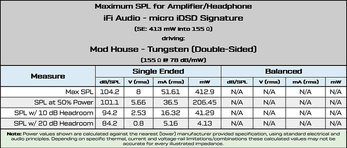

You can use this tool, one of several I created, to determine whether a given amplifier or DAC/amp has the power to properly drive a specific headphone. You just pick them from the lists provided, and it’ll do the rest.
Here’s what you get with the iFi micro iDSD Signature/Tungsten(DS):
What you’re looking for, at a basic level, is that the dB/SPL number for SPL w/ 20dB Headroom is at LEAST your normal, average, listening level. Easiest way to approximate that is to get an app for your phone and use it to measure how loud the output from your headphones is when listening normally (take them off, put the phone between the cups).
For me, that average level falls between 80 and 84 dB, so the iFi would just squeak in. However, personally, I like to see the Max SPL figure somewhere around 120 dB/SPL, as that means the amplifier isn’t running flat out (where performance tends to suffer a fair bit) to hit various musical peaks.
So, in this case, I wouldn’t personally pair this iFi unit with the Tungsten.

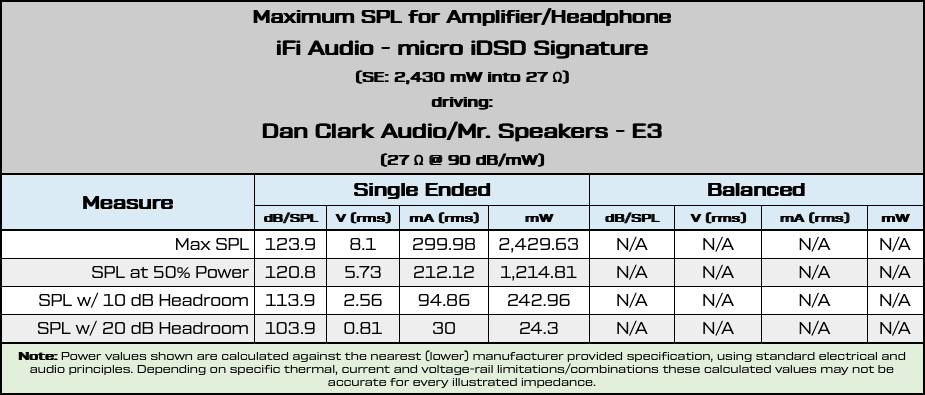

With the DCA E3 it’s a different matter entirely:
There’s plenty of headroom, and the amplifier isn’t going to be working that hard even when it hits the biggest, extended, peaks and crescendos.
NOW … regarding the iFi Micro iDSD Signature here … ALL of the calculations above are based on iFi’s quoted/claimed power output capability for this unit. However, it seems that with the Diablo and Diablo 2 (which seem to be very similar to the Micro iDSD Signature), those power claims are not using industry-standard RMS measures.
You should read what @GoldenSound has to say about this, here.
At the actual measured output power, using the standard RMS methodology, the Diablo and Diablo 2 have less than half their quoted power. If the power output for the Micro iDSD Signature is quoted using the same method, then it would fall well below what’s needed to properly drive the Tungsten.
I can’t say for sure without either iFi clarifying how they get their numbers for ALL their products (and then publishing numbers using an industry standard approach), or measuring them (which I’m not going to do - as I don’t have them available to measure and have better things to do with my time anyway).*
*I may pull all the iFi products from my tool. It assumes an industry standard RMS measurement to do its calculations. If that’s not how the quoted power numbers are derived then it is very misleading - and I don’t want my tools showing things will work for X or Y when the reality is they either won’t, or won’t work as well as they claim. And unfortunately I can’t just throw in what numbers I think should be there - that’s inviting way too much hassle. We’ll see if iFi can/will clarify if their other products are quoted the same way or not and go from there.
