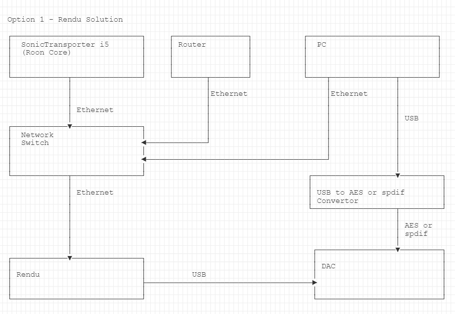

I’ve finally come around to the idea of subscribing to Roon and setting up a music network. After looking at the various video and music subscriptions I had, and consolidating and canceling some of them, paying for the Roon lifetime subscription is somewhat of a wash compared to my previous outlay.
My current setup is Windows PC → USB → Bifrost 2. I’m waiting for the Holo Spring 3 to come out, and will then decide between the Yggy and the Spring. Just mentioning that because the Spring and Yggy have more inputs than the BF2, so waiting for the DAC upgrade may help determine my Roon solution.
I’ve looked at Small Green Computer and I like the simplicity of their plug & play solution, starting with a SonicTransporter I5, into which I can put an 8TB SSD with all my flac files, and then use the MicroRendu, UltraRendu or OpticalRendu to connect to the DAC (see Option 1 picture below).
The only problem I can see with Roon networks (for my use case) is that I still want to play some audio from my PC to my DAC, and it seems the best solution is to directly connect from the PC to the DAC, as I do today. However, all the Rendu models only have a USB output, so I would need to buy a USB-to-IS2 or AES or SPDIF converter to convert either the Rendu or the PC USB (assuming I have an Yggy or Spring that can take one of those inputs). Small Green Computer offer a USB to Toslink convertor for $59, which I could use for the PC.
Alternatively, I think I can get a PI2AES instead of a Rendu, which will connect the network to the DAC using AES/EBU. Then I can continue to connect the PC to the DAC using USB. I would still use the SonicTransporter I5 as my Roon Core. (See Option 2 picture)
Did I get any of that right or am I very confused? Does one of those options look better than the other? Or am I missing an even better option?

Option 2 should work fine.

@PaisleyUnderground if I may offer some words of suggestion and questions?
  1. Do you have a secondary computer that can run a Roon Core?
    If no, the may I suggest two alternatives to the fold;
  • Roon Rock;
  • Innous Zenmini:
https://innuos.com/zen_mini_mk3/
  1. For Roon endpoint wired/wireless, will also solve 2 additional issues: send audio from computer to this device using Ropieee, amd also includes any needed SPDIF/AES output for DAC
  • Pi2AES
That’s is really it.
Thanks @Roark , that’s helpful.
I looked at the Zen Mini, and it looks cool, but outside of the CD ripper, is it any different from the Small Green Computer SonicTransporter I5? The specs and pricing looks to be about the same. The one thing that probably tips the balance for me is that SGC is based in the US, and it looks like Innuos is European? Just thinking about support.
This is where my networking ignorance kicks in, as I don’t quite understand that comment. Are you saying I can use the PI2AES to play non-Roon audio from my PC? So I wouldn’t need to connect the PC directly to the DAC?
