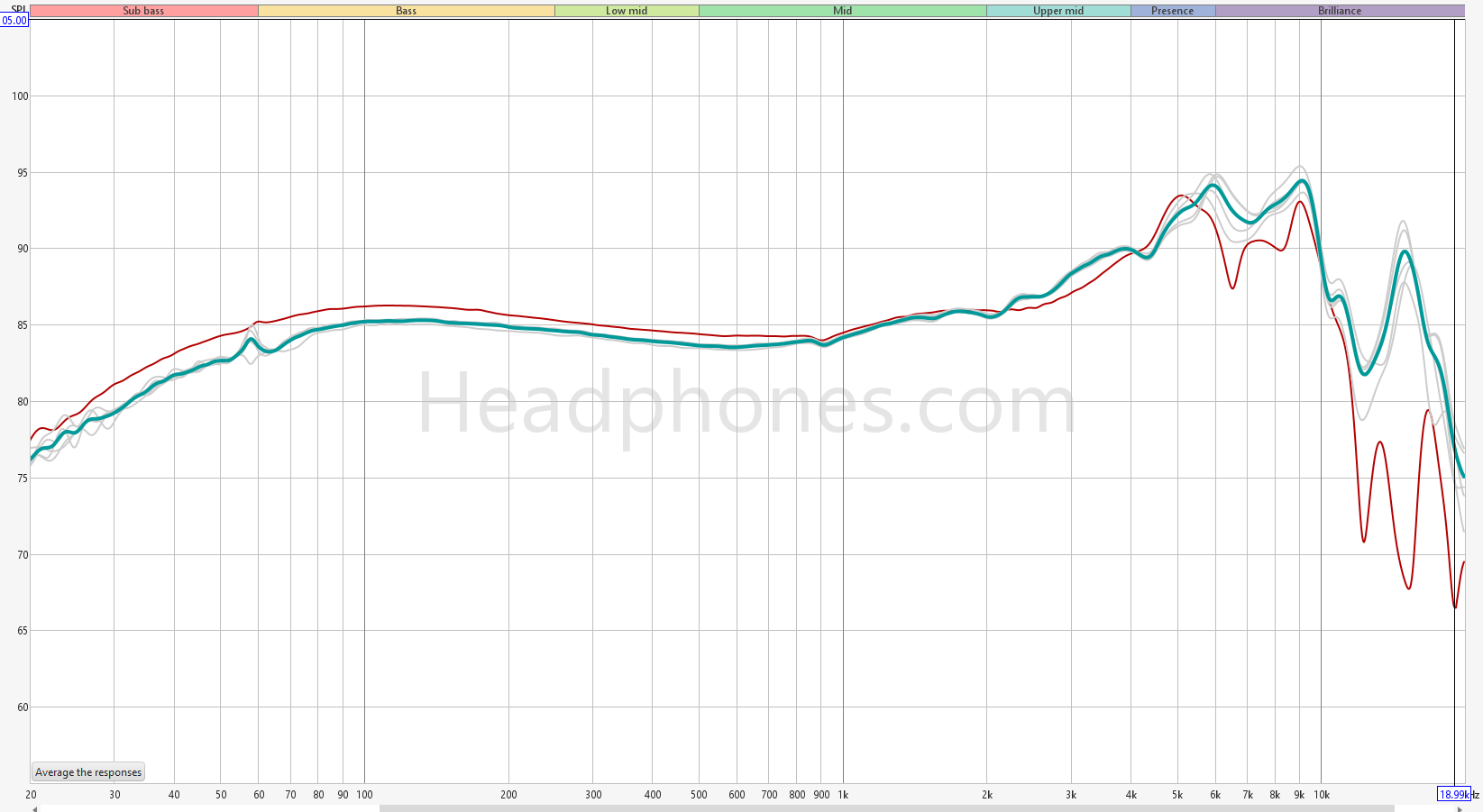

This graph, which shows the difference between the measurement of headphones on the 5128 (green) vs. a group of people (blue), appears to outline the very issues I have with both the DF and FF curves on the 5128, regardless of filters applied. That being:
  • Not enough bass extension
  • Too much 5kHz - 10kHz / sibilance & harshness
  • Weird relationship between mids and treble
I also spent far too long racking my brain over how to use this data to modify a 5128 DF/FF. Do I add the extra treble and subtract the bass from the baseline target so that a person would hear the baseline? Or do I do the opposite, so that the target represents what a person hears? Honestly, I still can’t wrap my head around the logic, so I just tested both. Well, it goes without saying, I absolutely did not enjoy either the DF or FF with the extra treble and less bass, regardless of any extra preference shelf adjustments. With less treble and more bass however, things started to look promising. Both the DF and FF targets sound much more listenable with just this simple transform adjustment, albeit both still sounding a tad too bright for my liking. My preference also very much started to lean towards the free field in this regard, as the mids seemed to integrate much better with the treble.
I also tried to slap on the Harman 2018 filters onto both of these modified targets, and quickly discovered that for once in my life (I am a basshead), I did not enjoy the amount of bass. The overall signature of both became much too boomy and dark for even my tastes, as someone who tends to prefer some extra bottom end and a smooth, potentially warm signature. I then remembered that the post that I had got the population transform from was primarily about relating headphones to the behaviour of speakers in-room. Now, I will depart from what listener used for the high shelf, and I opted for a HS that is 4500Hz, -4dB, 0.4Q. This very closely resembles an almost linear downward slope from 1kHz to 20kHz, a behaviour I have measured from my unequalised speakers in my listening space, and one I have seen mentioned in several forums across the web as being the general in-room response that is preferred by mixing engineers and whatnot, though this may be a baseless claim. I also decided to tack on a -1.8dB peak filter at 3000Hz, just to tame some of the ear gain that I don’t necessarily need.

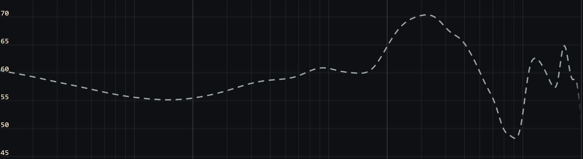

Overall, this leads me to my target for my (closed-back) headphones: A B&K 5128 free field, modified to represent a population’s in-ear measurement, and applying the natural timbre roll-off of speakers in a room:
“What happened to 8/9kHz!?!?”
Well, to me, at least, this curve sounds damn near perfect, or at least the very best tuning I have tried on my headphones. I have checked by going to several songs and videos which I had previously perceived as having harsh sound, whether through the mids or in the treble, and that harshness is completely eliminated. Songs that I already loved the mix on, got an immediate upgrade. I have tried applying the same adjustments to the diffuse field curve, however there is just still too much 7-10kHz, many youtube videos become difficult to watch with how harsh sibilance becomes, and I find this to be true for every target I’ve tried that uses the diffuse field as a baseline.
This target curve also very closely mimics how a good set of stereo speakers sounds to my ears, despite the free field baseline being measured from a 0 degree incidence. I also find it particularly interesting that everything I perceive as harsh and unnatural in my headphones seems to correlate to anything that does not sound to me like listening to stereo speakers.

There are a number of things here but I just wanted to tackle this one first. This isn’t the takeaway from this image. Also, people should probably take that study with a grain of salt, and I’d actually recommend they redo this one with a slightly different methodology/tools. But even still, this one probably needs some clarification.
  1. This does not include the canal effects, so it really just shows pinna differences, which we’d already expect to measure brighter on both the 5128 and the KEMAR-based rigs (this is the only thing to take seriously from this IMO).
  2. The bass extension difference is likely just due to the measurement technician not getting a seal when taking the measurement. So this is unlikely to be a difference in actual performance when seal is achieved, and it will vary quite a bit depending on the headphones anyway.
  3. Both of those graphs could actually sound the same to the individual ‘head’ the headphone is sitting on.
So this doesn’t actually mean that measurement heads need a different baseline to be predictive, it just means the HpTFs trend brighter for those pinna effects, which we already knew. And, I actually have examples on of this same type of data that shows it’s a lot closer than the above image indicates.
Red is on-head, teal is on-rig. You can ignore the low frequency differences, I expect that’s just due to the mic adapter.

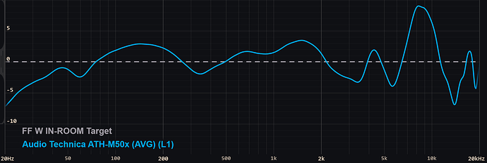

This seems to align well with the problems I personally have with the default tuning of the headphone, FWIW this is what it looks like when compensated to the target curve I’m currently using:
This is also based on a B&K 5128 measurement. I’m currently using the 5128’s free-field response with the filters from the 2018 Harman study (6.6dB bass, -3dB treble, -1.8dB 3khz) as my target.
