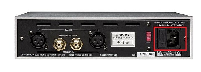

Does anyone know what output voltage cayin Iha-6 and Denafrips Ares 2 are using 5V or 12V as I am looking at a Linear Power Supply to buy and I am not sure which version do I need as I still haven’t purchased them yet and I don’t want to do a mistake ha!
Thanks in advance.
The both come with a standard AC power cable, so they already have their own internal power supply.
I wanted to get external linear power supply as usually the stock PSU’s are just a joke…
Switching wall wart power supplies can be poorly made, but these aren’t that, and I don’t think these internal PSUs are crap. Who told you otherwise?
Just to add to what @Nuance said, it sounds like someone has given you misinformation that any electronics you buy will sound better with a linear power supply. Putting aside whether or not a LPS would help, you would only be able to experiment with this if the amp or dac has an external power supply that can be replaced.
Look at the back of the unit. If you only see somewhere to plug in a power cable (similar to the back of a PC), then the power supply is inside the box, and can’t be replaced. Here’s the back of the Cayin IHA-6 that you mentioned. If you look at the red rectangle, it only takes a cable, so you can’t use a LPS.
If the back of the unit shows that it’s powered by a “wall wart”, or a micro-USB cable (like the Chord Qutest), then the power supply is outside the box and can therefore be replaced. Here’s the back of a Schiit Magni 3, which takes a wall wart.
Your post is confusing because:
  1. Output voltage is not relevant to supplying power to an amp. Input voltage could be relevant except
  2. These amps don’t accept DC power at all. They accept AC power.
  3. There is no place to connect a linear power supply to these units
  4. There is no external PSU at all
Maybe it would be helpful to take a step back and verify your assumptions about the gear you are buying.
Thank you very much for clearing that out. I really got it wrong then, I am bad with electrics so this really helped me understand how wrong I was thinking. This now makes so much sense, basically like @NickZ said it accepts AC power not DC, and like @PaisleyUnderground mentioned I wont be able to use external PSU, I cannot explain how thankful I am for your advises and time to explain to me, I was going to do a big mistake then !
