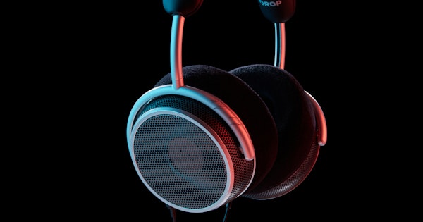

Grell OAE-1 Open Back Headphone
Axel Grell in collaboration with Drop is releasing a new open back headphone, with drivers placed in a radically forward position for an “ultra expansive soundstage”.
He designed numerous models for Sennheiser, including the HD 6xx series, HD 58x series, and the HD 800/800s. His bona fides are well established in headphone design.
This thread is for his new design, the OAE-1.
I think there’s some confusion about this headphone, partly due to the marketing and partly due to the placement of the driver at the front of the cup. From what I recall of Axel Grell’s presentation at CanJam SoCal 23, the placement of the driver at the front is not about simulating speakers in front of you. It’s about the optimal placement of the driver for the lowest acoustic impedance. Low acoustic impedance should give this headphone an open sound with a wide soundstage.
