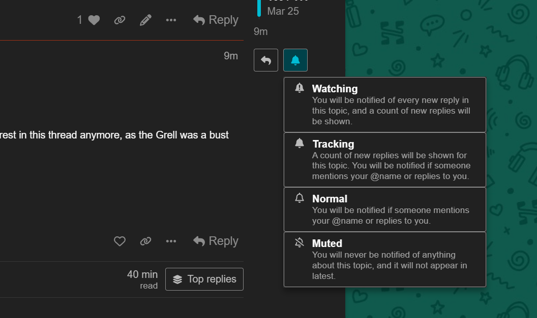

This is for @resolve or any other sys admin person:
Is there any way for me to stop getting notifications on the Grell thread?
I don’t see a way, and I think I get flagged on everything since I created this thread originally. I have ZERO interest in this thread anymore, as the Grell was a bust for me.
Sorry to be a bummer, but the constant notifications are irritating at this point.
Thank you, and happy listening to everyone!
Yes, thank you! I was looking up top, and completely neglected the bottom of the page! ![]()
