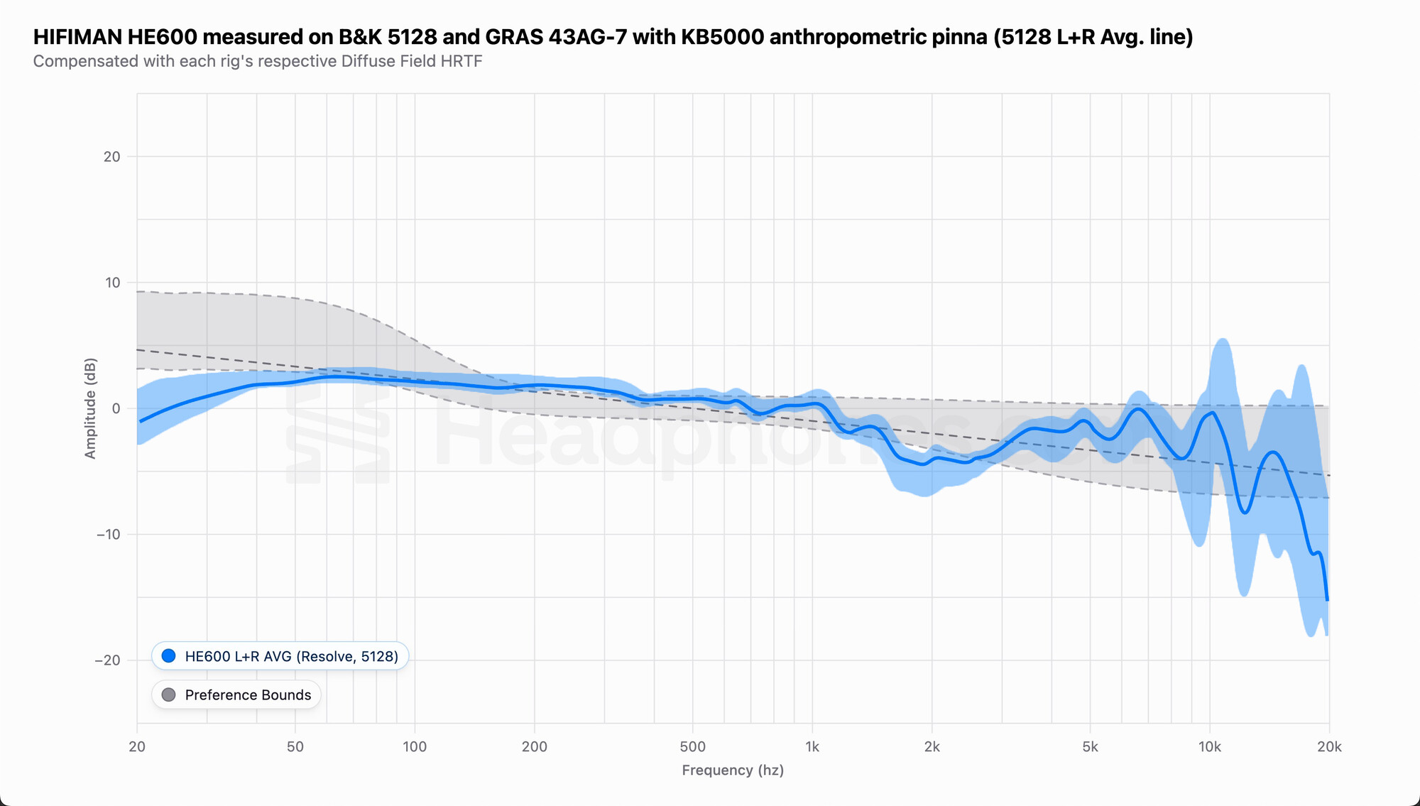

The HE600 does not sound like an HE6—but that’s not necessarily a bad thing. The original HE6 was known for its raw intensity and “blammy” energy arising from elevations around 1 and 4 kHz as well as a very well-extended sub-bass. The HE600 dials that intensity back, replacing it with a more natural overall balance and a more coherent timbre.
Tonally, it’s closer to a Sundara than an HE6, though with subtle refinements that make it feel like a “Sundara Plus.” Bass is better extended than the Sundara, tapering only slightly at the lowest frequencies. The midrange is neutral and well-textured, without the upper-midrange dip found in models like the Edition XS.
The ear-gain region (2-4 kHz) is spot-on, giving vocals and instruments a crisp sense of presence without sounding shouty. Any more energy in specifically the 3-5 kHz band here would be too much, so its good that the HE600 exhibits restraint in this one band.
Treble focus shifts slightly toward the mid-treble, lending cymbals and percussion a strong central “bite,” while keeping the uppermost harmonics smooth and inoffensive to my ear. The result is a sound that feels clear, articulate, and detailed.

Measurements
Unlike larger egg-shaped HiFiMAN drivers, which can show more modal “wobble” in the mids, the HE600’s smaller circular diaphragm behaves predictably and is easier to EQ if desired. It also avoids the mild tonal inconsistencies seen in the Ananda Unveiled and Edition XV.

  2. The tuning was too harsh for rock, which is 90% of what I listen to. This PEQ turned them into my favorite headphones, period. EQ tweaking isn’t normally my thing, but these headphones respond incredibly well to a little tweaking:
    Preamp: -2.5 dB
    Filter 1: ON PK Fc 90 Hz Gain 2.5 dB Q 0.700
    Filter 2: ON PK Fc 3200 Hz Gain -2.5 dB Q 2.000
    Filter 3: ON PK Fc 4590 Hz Gain -1.5 dB Q 2.200
    Filter 4: ON PK Fc 6690 Hz Gain -5.0 dB Q 1.800
    Filter 5: ON PK Fc 95000 Hz Gain 2.0 dB Q 2.500
