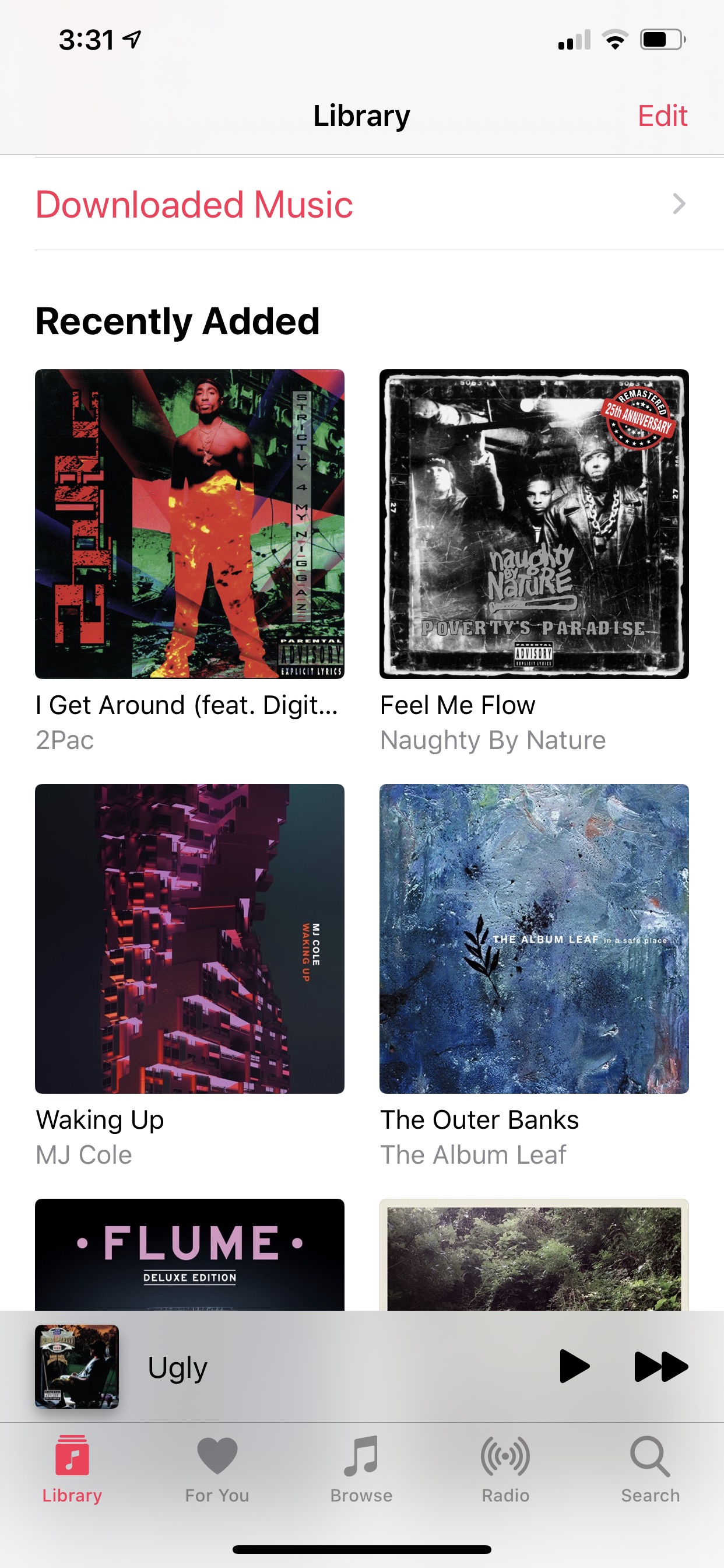

90’s hip-hop rocks! (Fist pumping in my head). :sunglasses:
I use CarPlay and I often listen to the “Hip Hop Classics”. It’s a fun way to find music while in the car.
