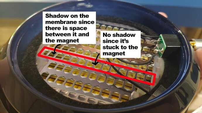

I 100% agree with @Ryan_Ho here. Don’t push the drivers to your ears. If the 2 most likely explanations for stuck drivers are 1) pressing them to your ears or 2) high diaphragm excursion from playing them at high SPLs… I’ve got my money on #1. Of course the jury’s still out on that one.
Somebody over on head-fi.org (username: theangelboy) made this super helpful image to show when a driver is stuck. You should use it as a reference. And thanks to theangelboy for the effort. A++
