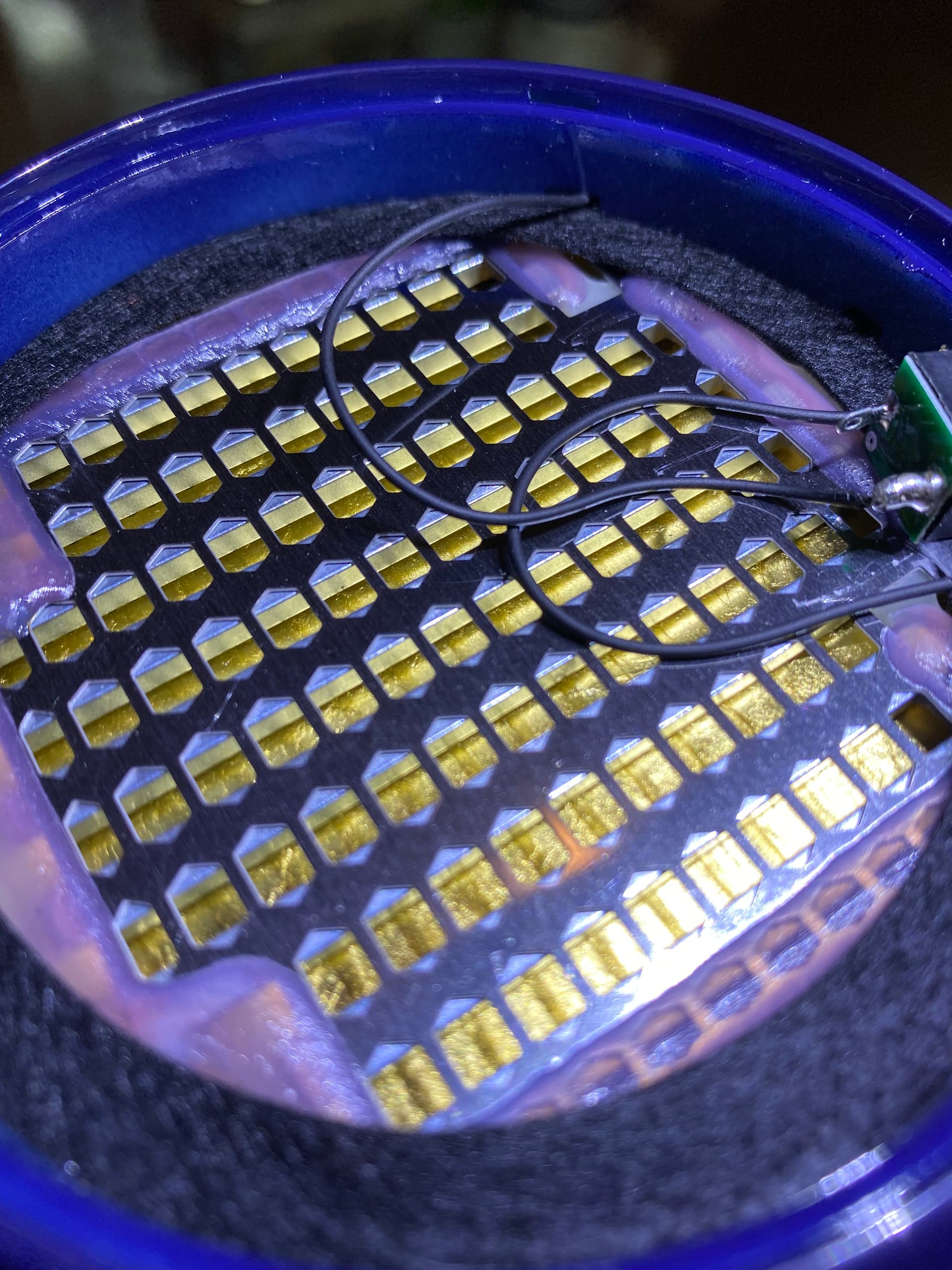

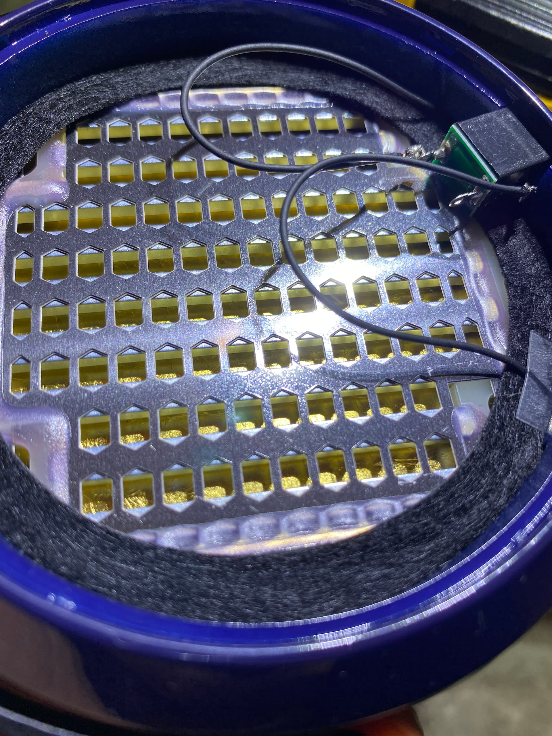

Hey I never opened up my headphones before but how does one tell that it has a stuck / sticky driver on the HE6SE? What should I be looking for? I have the V2 as well. Just received mines the other day and it sounds great with EQ! Really enjoying them.
I do also notice the noise when pressing the driver into my ears. As if something is pressing in and releasing when I let go. That is normal and not a sign of a stuck / sticky driver?
just open the grill on both side it’s really easy and you can check to see if gold is stuck to magnets or not. Checking the other side under the earpads is much harder to do and prob not worth it.
The crinkle you hear is most likely the thin diaphragm flexing it’s normal but i probably advise against doing it too often
I 100% agree with @Ryan_Ho here. Don’t push the drivers to your ears. If the 2 most likely explanations for stuck drivers are 1) pressing them to your ears or 2) high diaphragm excursion from playing them at high SPLs… I’ve got my money on #1. Of course the jury’s still out on that one.
Somebody over on head-fi.org (username: theangelboy) made this super helpful image to show when a driver is stuck. You should use it as a reference. And thanks to theangelboy for the effort. A++
Thanks. It is kinda hard to tell. Not sure if the shadow is due to the lighting from the top part or mines is completely stuck?
left then right
The left one looks good to me as far as I can tell. Can’t really tell on the right side pic. It doesn’t look like there’s enough of a shadow cast to really tell. Maybe somebody else can chime in here?
Do you hear any difference between the left and right sides? Particularly in the bass frequencies?
The driver matching test on here is useful. When my driver got stuck, I heard a clear channel imbalance in the lower bass.
Just curious… when you had one stuck driver and one fully-operational one, how much of a difference did you hear between the two? I’m trying to extrapolate how amazing my non-broken HE6se will be using your input, lol.
