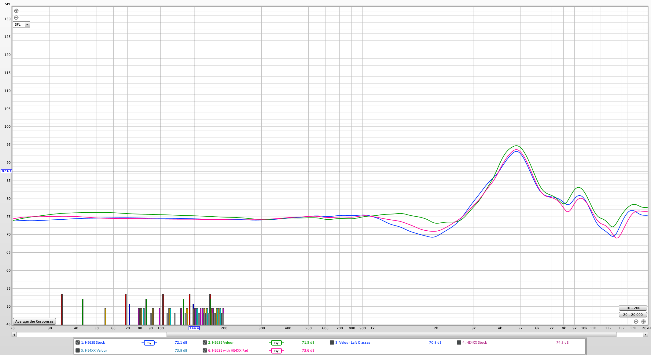

I’ve been curious what’s different between the OG HE6 and the HE6SE. I’ve never had the chance to hear an OG HE6, but from seeing measurements it clearly seems to be tuned differently, with much less of a hole at 2 KHz.
From what I can tell, the OG HE6 shipped with Hifiman’s velour earpads, so I bought some Hifiman Velour pads for 6 bucks, wondering if they’d bring the HE6SE tuning closer to the HE6. Well, here are the results on my E.A.R.S. (with a bonus air-gap measurement).
Despite a very different measurement rig, it’s a very similar result.
In listening, I have no idea if this sounds like an OG HE6, but it certainly sounds very different from the stock HE6SE! I’m not sure which I prefer.
Just for fun, here’s that same pad on the HE4XX. It has a similar overall effect, though it also boosts the treble quite a bit on the HE4XX and depresses the sub-bass a bit. From this, I’m guessing that the HE4XX depends much more on a sealed front-volume to get good bass extension, and that this sealed front volume is also dampening the driver in the higher frequencies.
And lastly, here’s the HE6SE with the HE4XX pads.

wow the midrange improved with the focus a pads? now im wondering why they decided to use the other pads for he6se v2
Yeah, right now they’re my fave. The velours are a bit bright.
Maybe they don’t ship them by default because they’re poorly built and the glue tends to fail within a year? I’m not sure.
i did think of one thing, maybe your stock pads are a little broken in vs your new pads are not? Maybe that could shift the measurements? Its interesting because if you look at resolve measurements of the 2 pads for he6 they are seem to perform close in midrange.
Also great find on the velours, 6 dollars i ordered it, WITH FREE SHIPPING. Not sure how one makes money from that but ill take it
Yeah, the 4xx pads are definitely broken in.

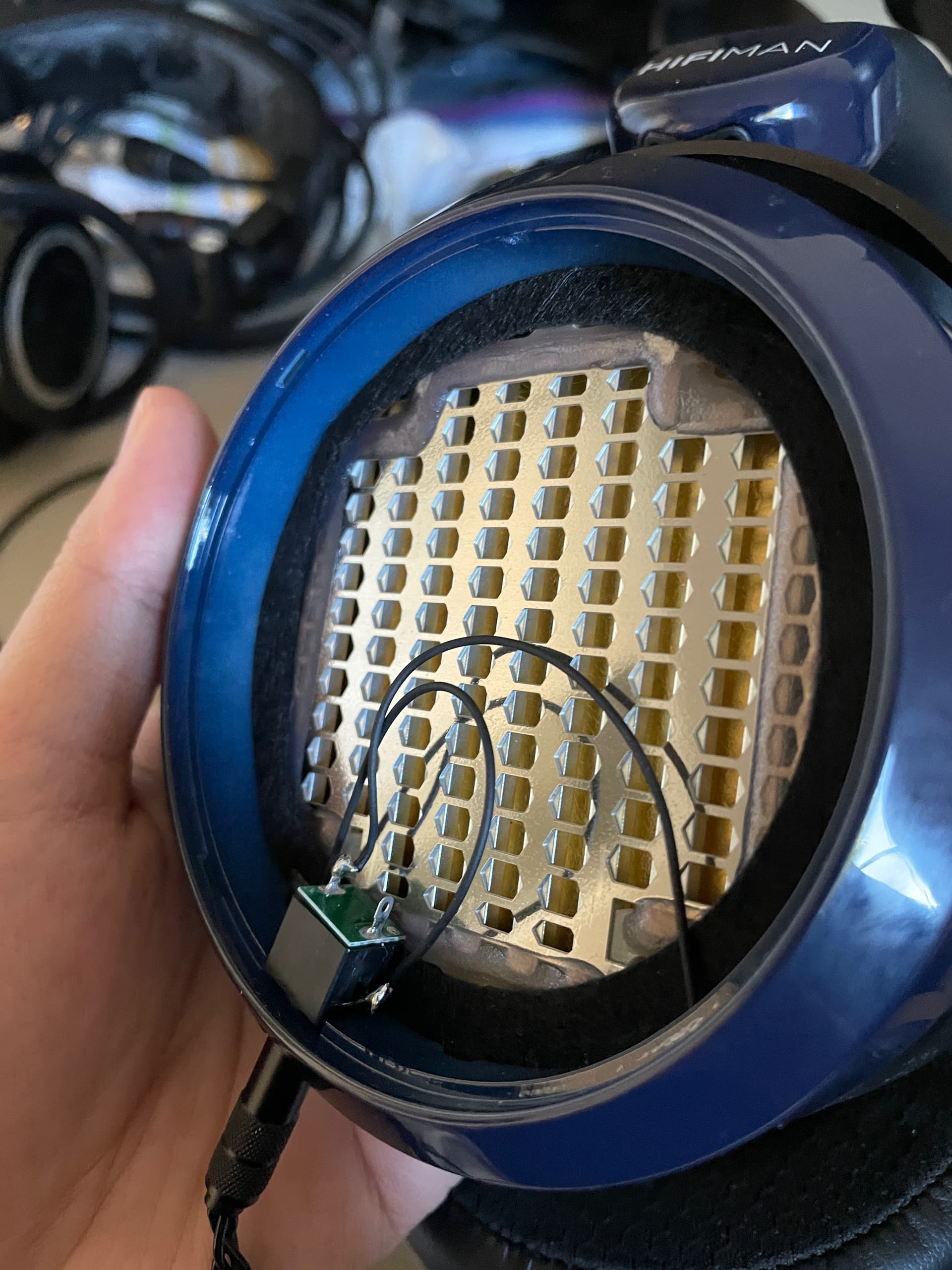

Well, mine just did this too :frowning: Going to try an exchange and keep my fingers crossed. Usually I’d just say f’it and move on, but this sounds too damned good to give up on it.
What happened? Did it come like this and you just discovered it or did something happen? Seems like a common issue
It didn’t come like this. At some point I realized that the one channel didn’t sound right anymore, and thanks to this helpful forum I knew what to look for. I don’t know if something specific triggered this. I’m guessing the issue is that the mounting/tensioning mechanism for the diaphragm failed somehow.
My hope is that if the replacement doesn’t do this within a short time of owning it, it might last for a good while, but without knowing the failure mode that’s only a wish.
Good luck, but don’t let yourself become (another) moth consumed by a flame.
I am taking a guess that this might be a result from the pressure from the cups forming a seal on your head when placing them on your head when rolling leather pads. It may be best to stay with hybrid or velvet pads with the HE6SE V2.
you all scared me so i opened mine up and i guess i’m lucky. I have heard my diaphragm move when i pushed down my ear cup and it seals so much you hear a crinkle in the driver. But mine hasn’t stuck to side of wall after that experience though
