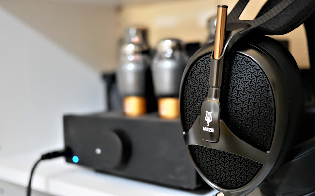

ugh that picture makes me wanna listen to them again. so pretty!

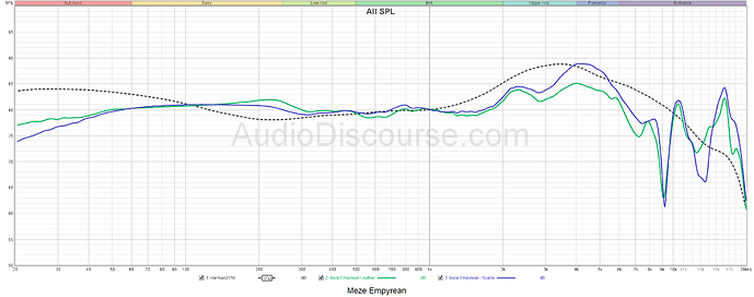

Initial squiggles:
My first impressions yesterday were that it sounded better than my first impressions at Torq’s meet-up last year. It didn’t sound as muddy and weird. I dont remember which pads were used then but I’ve mostly listened to the suede (?) pads thus far.
I had been listening to the new Gold Planar GL2000 just prior to this, and so these were a marked improvement over those. Then I swapped back and forth with the Hifiman Arya, and some of the little things I didn’t like about the Meze came out – that said, I don’t think it is nearly as bad as I recall, so I think I’ll continue to listen to these more and try both pads and give it a proper fair shake.

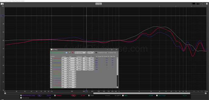

I ran some weird experiements with the pads, and umm even took the pads off and used these as Ear Speakers. haha for some reason, I kinda liked it without pads when listening to some acoustic rock music. That said, they sounded terrible with anything with deep bass hits.
Anyway, these are pretty warmer than what I normally like. The mid-bass bump sure is overpowering. There’s also a peak in the treble/upper treble that really rings on cymbal hits that bothers me a lot. It seems more so on the leather pads than the suedes.
Made a quick EQ and I feel like this smooths it out and its a little more in-line with what I like, and its buttery smooth too.

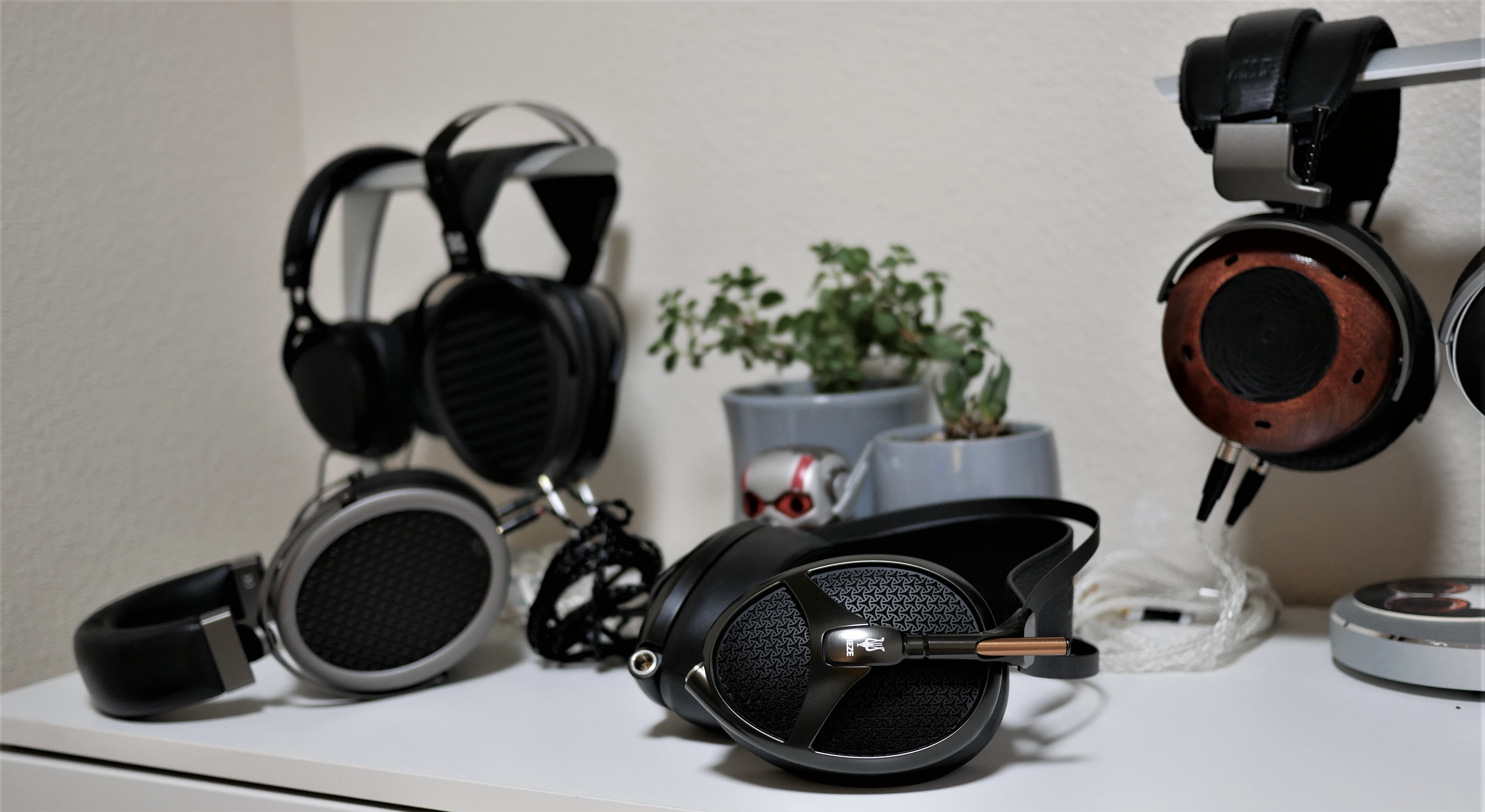

The Meze Empyrean is a stunning unit. It has exquisite build with machined metal cups, an intricately designed grill, and real leather pads and headband. The comfort is among the best I’ve ever worn, and it feels like wearing pillows on your head and ears.
The cable included terminates in mini-xlr and 1/4 inch on the amp side, and is solid and usability is good. It may be a tad stiff, but no where as uncomfortable to use as competitor’s included cables, and this has a lot to do with the upper portion above the split being very lightweight and supple.
The pad options include real leather pads as well as an alcantara suede pad. These pads are easily removed and replaced using magnetic attachments and both provide slightly different tuning variations. For the most part, I preferred the leather pads, and I’ll be doing my review mainly with those.

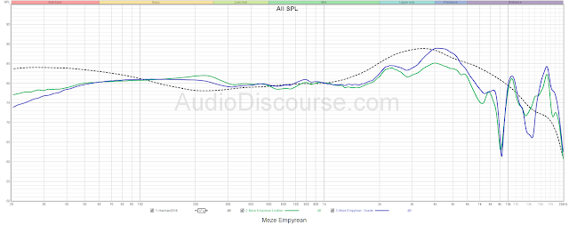

The Meze Empyrean is a warm-tuned planar magnetic headphone that has some sort of middle ground between the typical Hifiman and the typical Audeze sound. For the most part, I found that there was a slight mid-bass bump and a smooth and laid-back midrange and a slight sharpness in treble somewhere that seemed to pop up in cymbals and hi-hats splashes. I wouldn’t call this a V-shaped headphone by any means, even if that description can resemble it to an extent.
On this second go-around with the Empy, I had just put on an hour of listening with the new Gold Planar GL2000 oval-shaped headphone and then swapped to the Empy. In this contrast, I found the Empy to sound a lot better than what I had remembered. It was more dynamic and more open, and had a more powerful low-end and a lush atmosphere around it, especially when compared to the less expensive GL2000.
It was when I started to A-B with the Hifiman Arya that I started to pick apart the areas that I didn’t like about the Empyrean when I first listened to it in mid-2019. It was the over-emphasis in the mid-bass and the splashy treble attack that really struck out. Now mind you, the Arya is a referencey-tuning with a brighter low-treble region and some may find that a bit sharp, and so these two don’t share a lot in tuning.
But preferences lie where they do, and for me, the mid-bass presentation is just a little too much that I found it can muddy up the midrange and give a blunted and overly lush/wet sound that I am not too fond of. Its probably not on the same level of disgust that I originally could not contain within in 2019, but its still a bit there.
While this does not affect every song I listened to, there are other issues that I did not like.
As mentioned already, the mid-range and lower treble is quite nice. Its bold and has a thick juiciness to it that gives much of my rock and jazz music a glowing ember feel, where I’m relaxing by a fire. It’s warm. Maybe too much though, but I am one to like a leaner presentation, generally.
And all the same, leaner presentations generally mean a slightly brighter one. While I don’t consider the Empyrean bright by any means, it has one or two treble peaks that jolt me often. It’s when I hear a crash of cymbals in Fleetwood Mac’s “Dreams” or ringing sounds in the beginning of “Fear Innoculum” from Tool. This could be attributed to the rise past 10KHz and later in the upper treble range that is shown in FR Plots. Its audibly present to me, and not the presents I enjoy, even at low volume listening.
So, despite Hifiman Arya’s brighter presentation overall, it was the Empyrean’s general warm and laid-back nature that cause me more treble heartache. Strange how that is.
I decided to take a chance on trying Empyrean with an EQ more catered to my tastes. Essentially, I got rid of the mid-bass bump, and increased the upper-midrange and treble, and reduced the upper treble and this Empyrean modification seemed to really improve my enjoyment of this headphone.
