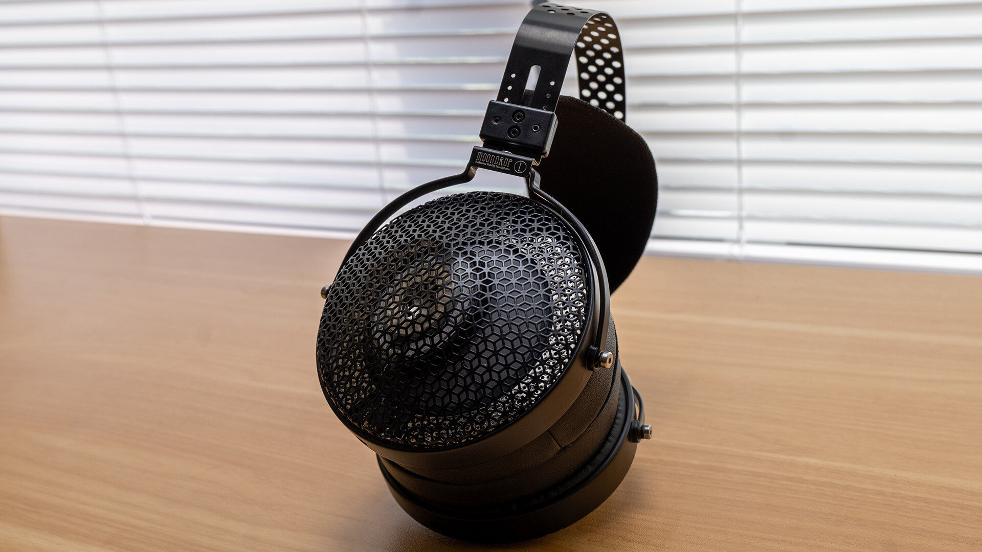

Build, Comfort, Design, and Accessories

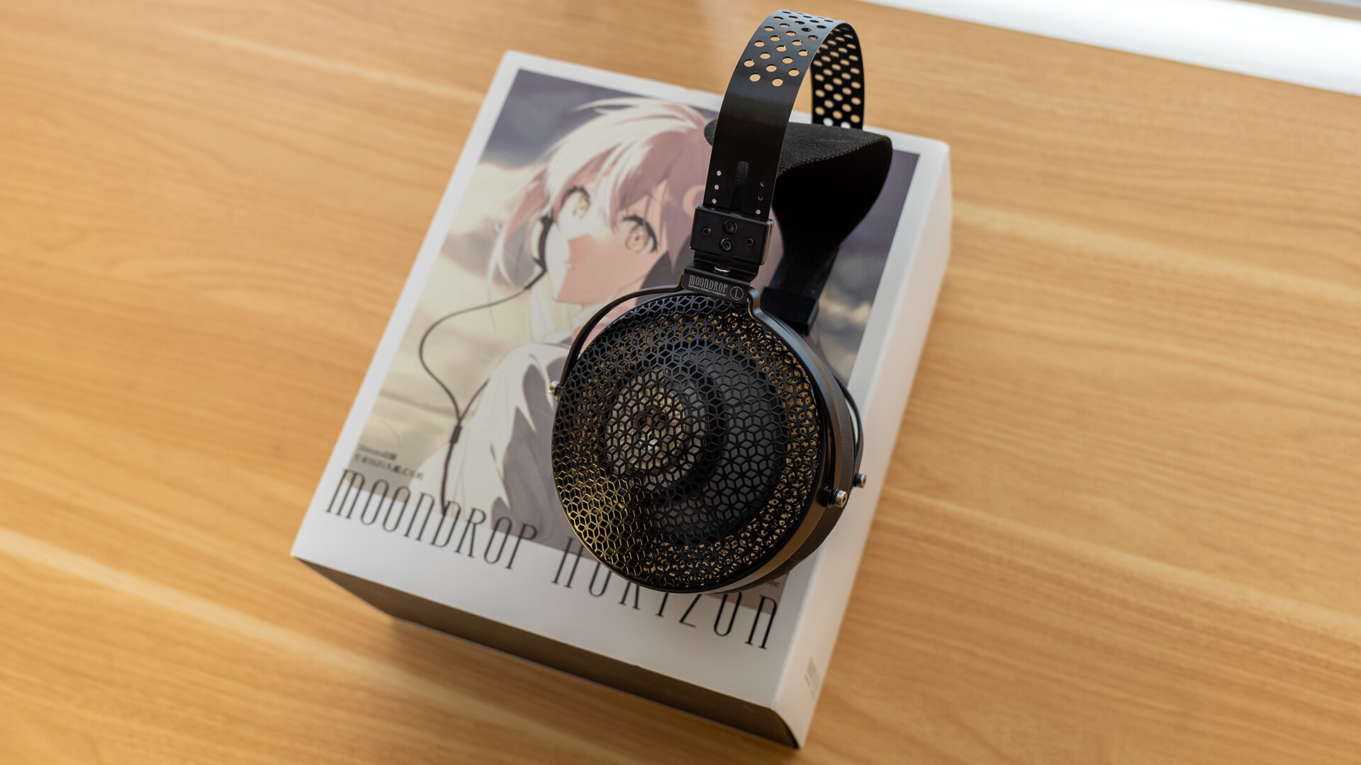

Starting with build, the Horizon is middle-weight headphone at right around 350g, but despite what seems like an all-metal build (aside from the pads and headstrap adjustment), I wouldn’t say it’s the most rock-solid build. The chassis itself makes some sticking noises when the headphone is placed on the head/removed from the head, and the overall assembly feels “headband-heavy” instead of “cup-heavy” in a way that makes the headphone seem a bit insubstantial.

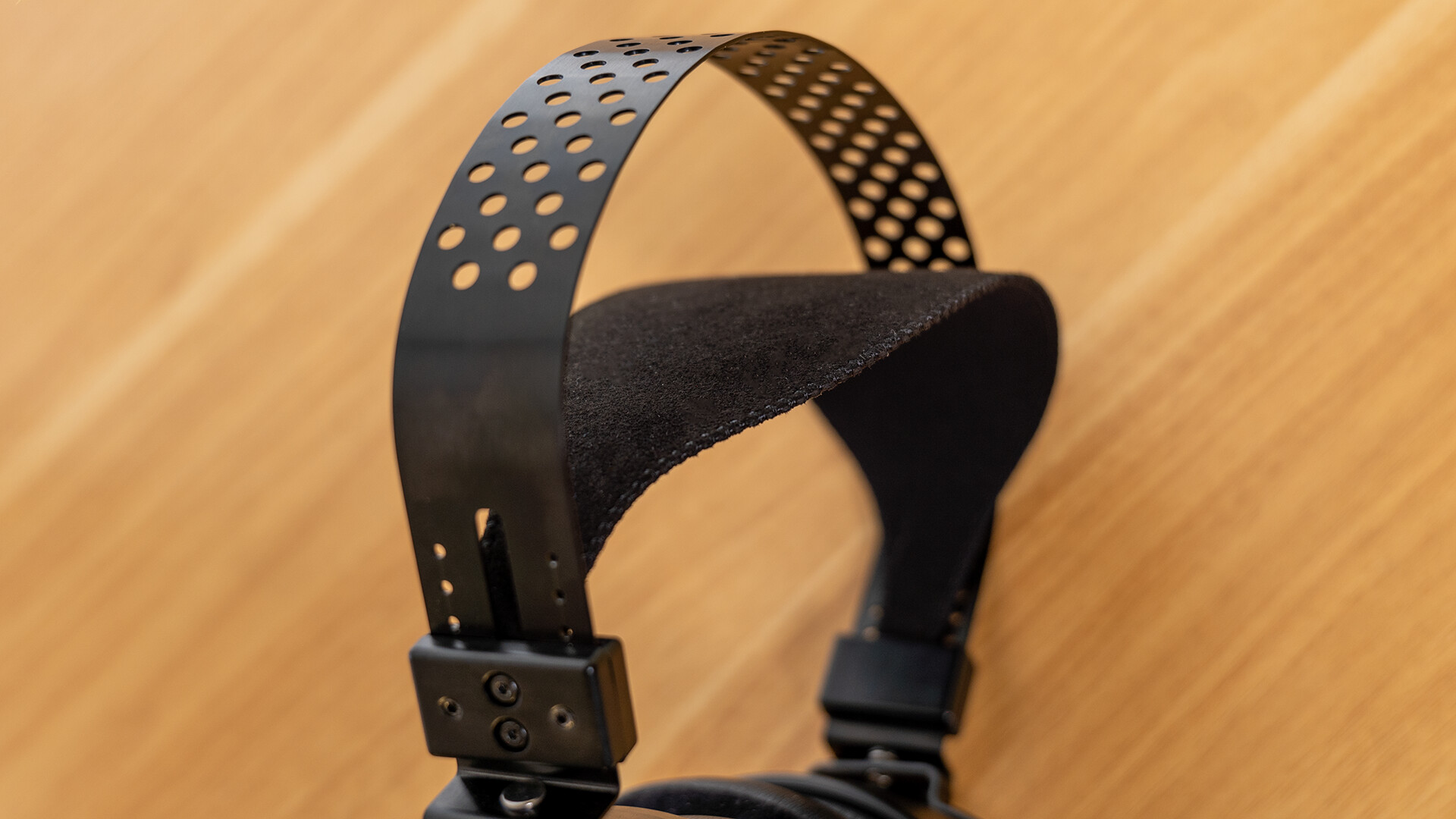

Speaking of which, let’s talk about comfort, where despite it being a fairly reasonable weight, Horizon is really quite bad for me. The headstrap itself is actually great (flexible, conforms well to the head, no hotspots), but they did not fix the issue that also exists on the Cosmo where the overall headband is just absolutely gigantic. I have to wear the Horizon on the smallest setting, and even then it’s a little bit too big for me, and the clamp is incredibly gentle. Gentle clamp is usually a nice thing, but here it’s a big problem.
Pairing the overall hugeness with the lack of clamp means Horizon feels incredibly slidey and insecure on my head, such that I have to constantly monitor the angle that my head is rested at to actually listen to the headphone. Unsurprisingly, this balancing act completely takes me out of the zone, and kinda ruins my ability to enjoy the music. The worst comfort experiences are the ones where you’re constantly reminded that you’re wearing a headphone, and Horizon fits that description to a T.

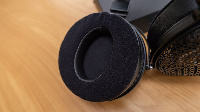

The last comfort nitpick is that the earpads themselves—while likely acoustically necessary for the sound they wanted to hit—are a bit scratchy and too small to fit truly circumaurally for me. However, the biggest annoyance is that either the internal foam or an internal wrapping material causes the pads to crinkle very audibly when you move your head. It’s not something you’ll hear if you’re listening to low dynamic range music, but if the music is paused you will hear it if you move, and this contributes further to the feeling that this is a very cheaply constructed headphone.

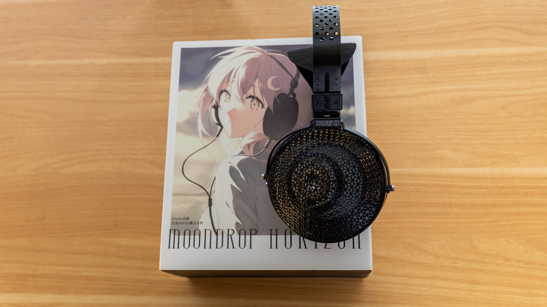

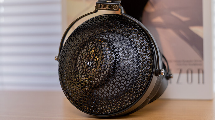

Touching on design, visually I think the Horizon looks awesome. I love the black colorway, and I love the grille design that allows for complete transparency to peer into the rear of the headphone and see the driver. I love basically everything about this headphone’s visual design except for how huge and Cyberman-like the headband is when you’re wearing it. The visual design is the only part of this headphone that I would say punches above its asking price, looking more luxurious than its price would suggest.

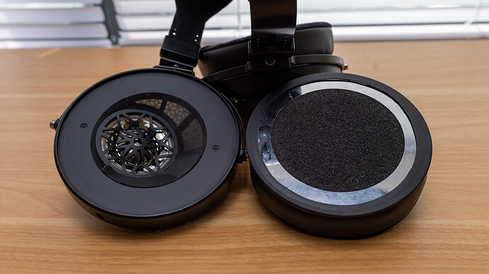

While the usability of this design needs work, there is at least one good cue that this headphone takes from the Cosmo that preceded it: Horizon keeps Cosmo’s pad mounting mechanism, which includes a magnetic pad mounting ring that can be placed inside an earpad to adhere the pad magnetically to the baffle. This also allows for extremely easy pad removal/swapping, and I think this system is very smart. Moondrop deserves some credit for coming up with this idea and continuing to use it on newer, less expensive designs.
However, upon inspection people will notice that the front damping foam placed in the pad (ostensibly used for tuning the headphone) is incredibly thick. I can’t remember the last time I encountered front damping foam quite this thick, and this matters for the sound, so we’ll discuss this later in the article.

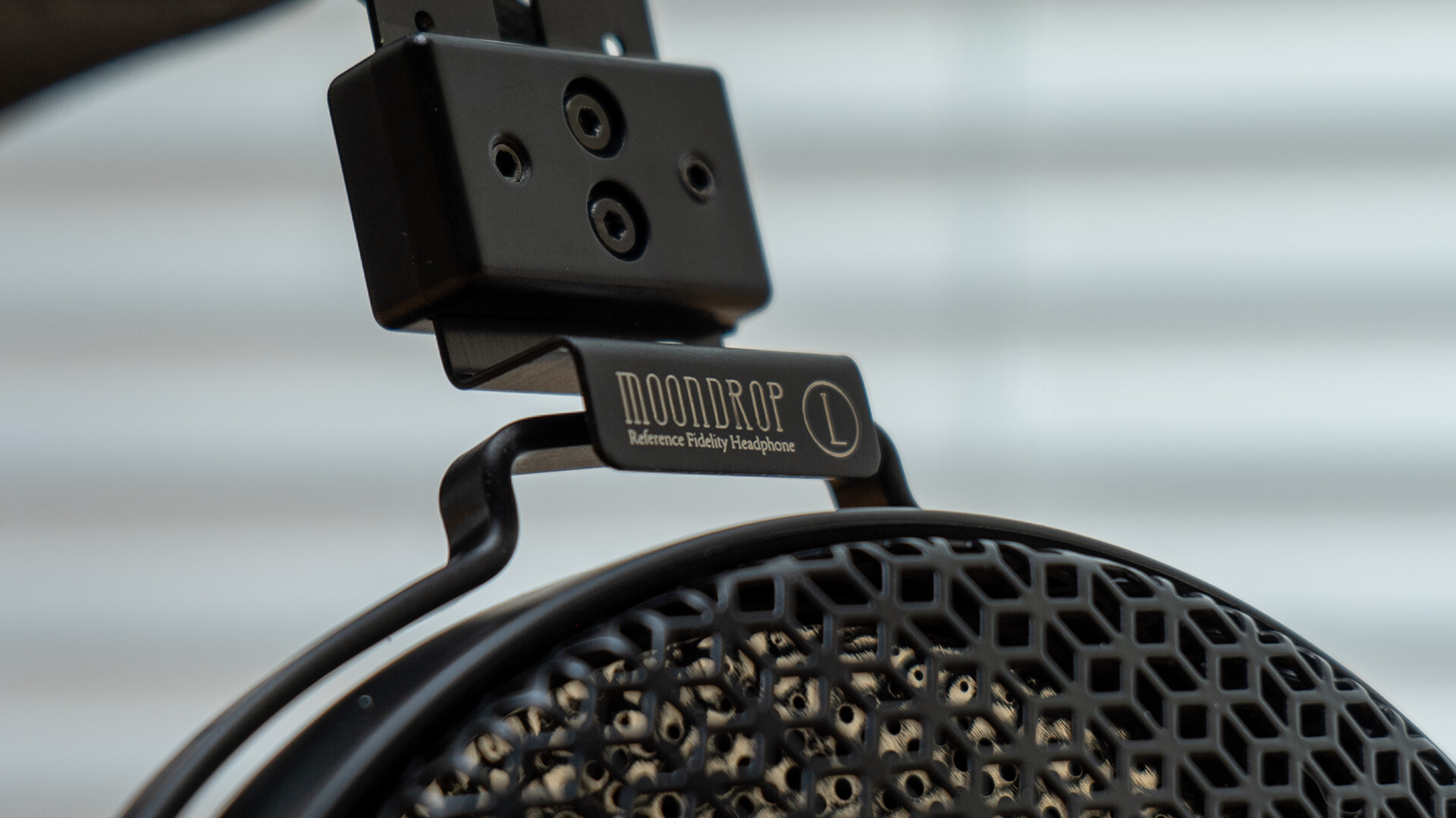

Further commenting on the design choices here, I don’t love the headband adjustment mechanism—it clicks very forcefully but because the piece is a very simple plastic, this strikes me as the first part of the headphone that is likely to break. Additionally, within a few adjustments it will visibly scratch the black paint(?) of the out-facing part of the headband adjustment slider.

Well, my assumption based on the headphone’s design is that they started this project wanting to use an angled driver orientation. Many companies love to advertise that angled drivers have a positive effect on spaciousness or “soundstage”—even though it’s not necessarily true at all—and audiophile consumers often enthusiastically buy into this marketing.
The problem here is that headphones aren’t that simple. When you angle a driver relative to the ear in close proximity like this, you’re going to get a different pattern of contributions from the ear’s anatomy than you would from just having the driver parallel to the side of the head—a different frequency response.
While some people may hear the frequency response differences that arise from this more angled orientation as “soundstage,” what they’re hearing is a frequency response change, not some magical property of the driver being angled by a few degrees.
The typical coloration we’ll see from a headphone with a frontally-placed/angled driver like this is an increase in the low treble, and this (I think) gives us a clue as to why Horizon is so dark. They started with an angled driver, it gave them a bunch of low treble (the 5-6 kHz peak), and the only way to smooth that peak out was by using the incredibly thick piece of front damping foam I mentioned in the Build, Comfort etc. section.
This did damp the lower treble peak enough to be tolerable… but it also had the unfortunate side effect of absolutely nuking everything above this one problematic peak. While for me, a large dip is a lesser sin than a harsh peak, it must be said that if they’d gone a different route with the acoustic design/construction of the headphone itself, this compromise could’ve been entirely avoided.

My hope is that Moondrop discontinues the use of this headband because it is absolutely the weak point with all of their headphone designs. I also hope that instead of focusing on things that are essentially marketing-bait like “driver angling,” Moondrop starts their next dynamic driver headphone project with frequency response tuning being the first and foremost consideration. At this price range, it’s easily the most important thing to consumers.
