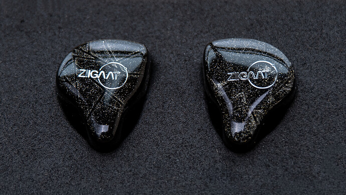

Lush has a shimmery black/silver faceplate with the brand name stamped on it, and I like the colorway but not the branding. The name “ZiiGaat” sounds like a gibberish, randomly-generated Amazon brand name that means absolutely nothing, so I don’t really get how printing it on the shell has any value to consumers. I don’t want people to think I got these on TEMU, but having ZiiGaat printed on it is almost certainly going to project that vibe to anyone who notices.
Otherwise the shell design is fairly standard, standing somewhere between the Thieaudio/Kiwi Ears sets and the slightly larger shells like that of the DUNU DaVinci. It has the overall size closest to the former, while having the rounder, less “pseudo-custom” molded shell and slightly wider nozzle reminiscent of the latter. I don’t find it very comfortable, because the shell does protrude a bit more out from my ear than I’d like and it doesn’t nest neatly into my ear’s native contours.
