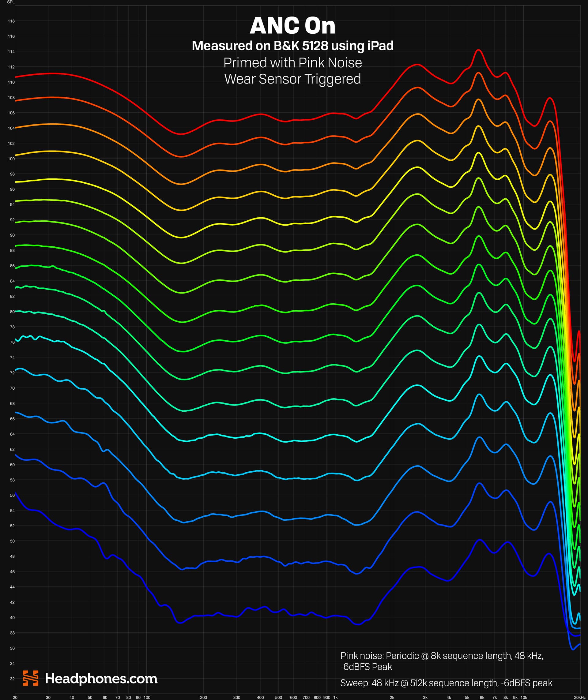

Raw visualization, full volume gradient, ANC On

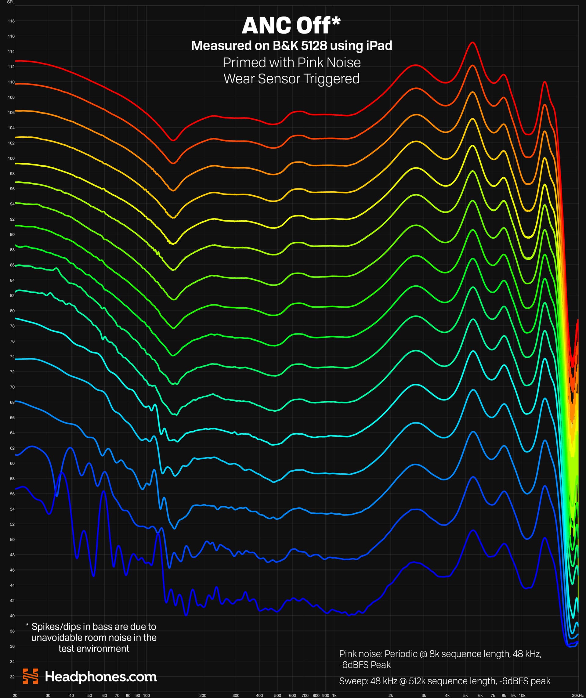

Raw visualization, full volume gradient, ANC Off

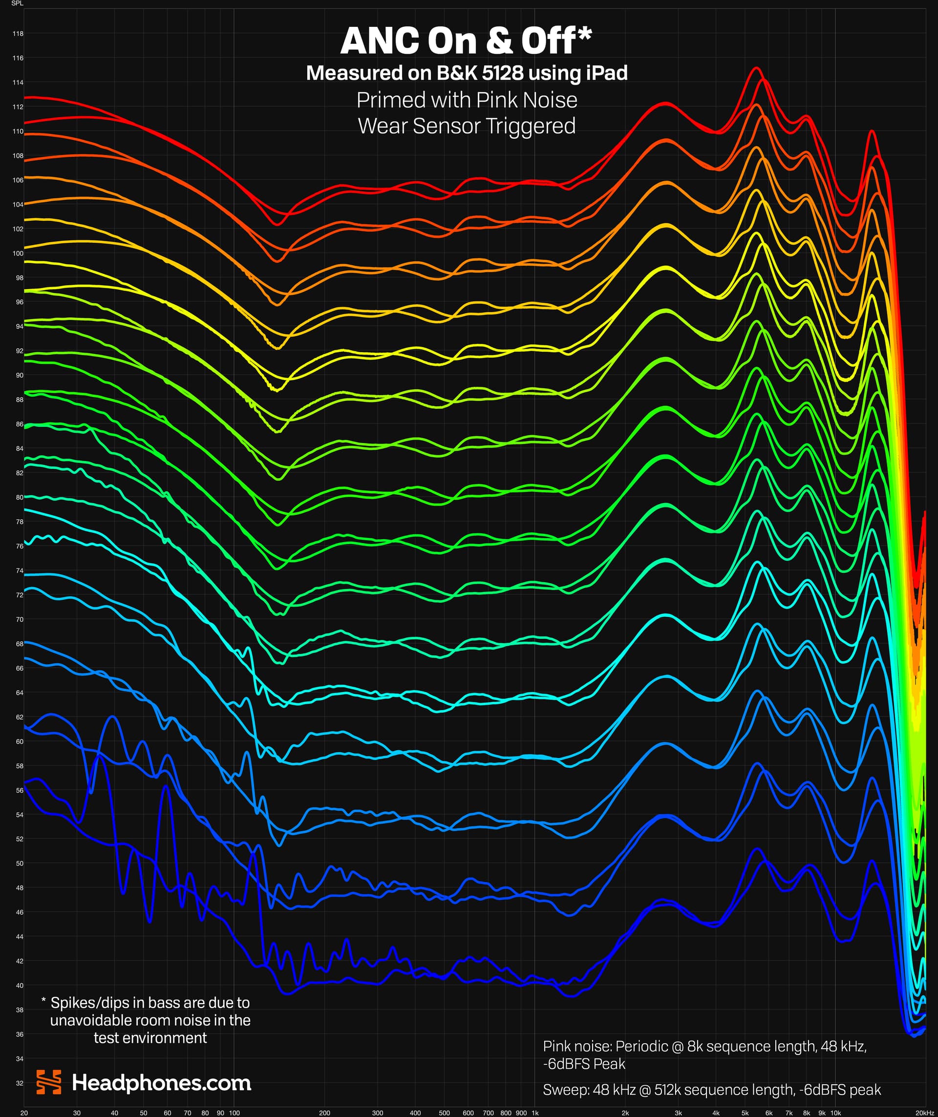

Raw visualization, full volume gradient, ANC On and Off (to check status of priming & difference in frequency response between modes)

A quick note in regards to the above measurements, in particular the ANC off ones, I think that the differences below 1kHz and especially the notches can be explained by the 5128’s tendency to show “rocking” modes that may not occur in real human ear canals, combined with the ANC off Adaptive EQ function working in a different way from when the feedback loop is activated (all other modes), and not having the capacity to apply very fine grained filters to counteract these notches.

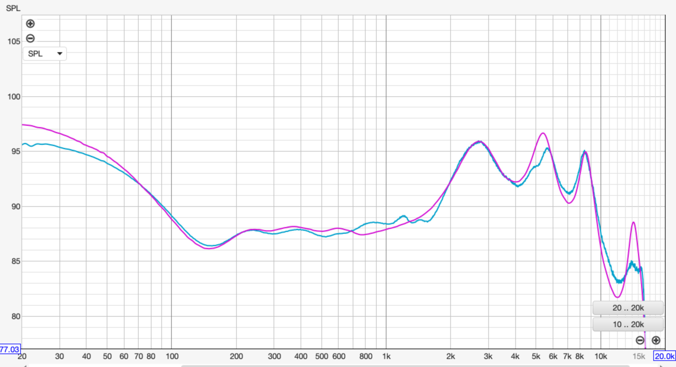

This measurement was done in a clone 711 coupler with putty to stabilise the Airpods to avoid any rocking mode and the difference is lesser.
My thoughts exactly, but thanks for your assessment! Had the same thing happen to me measuring in my 711 setup.

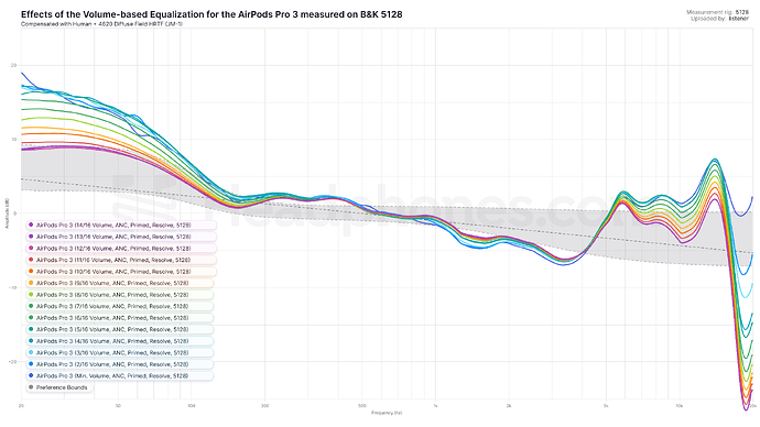

Just posting some data to show the capabilities of the new native Equalizer that Apple implemented for the AirPods lineup. And yes, they are identical regardless of which AirPods product you’re using.
Feel free to ask any questions or ask for any other visualizations if you need it!
