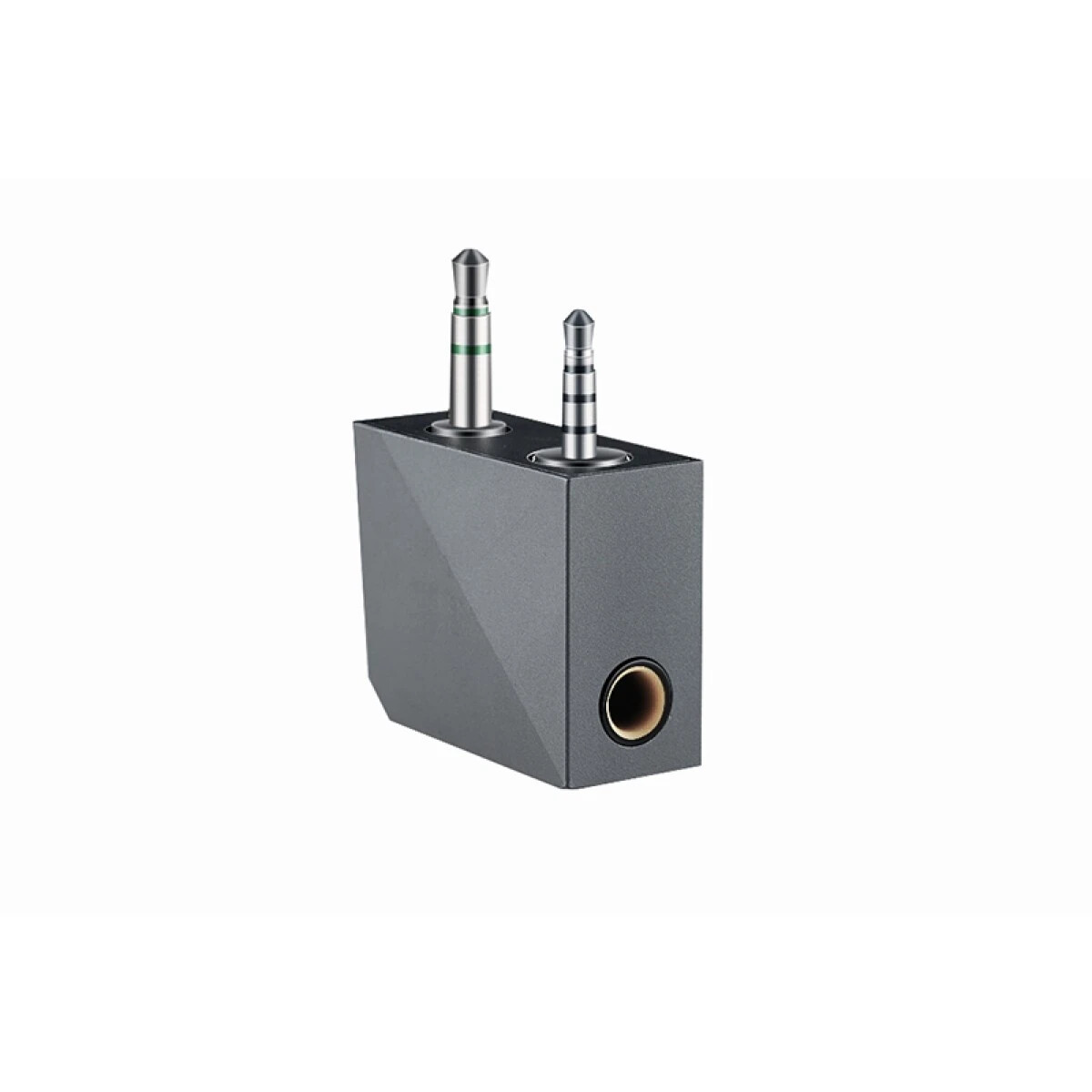

EFFECT AUDIO - AKA BALANCE ADAPTER POUR DAP ASTELL&KERN
hello TORQ, have you seen this article for sp2000,
do you think it will bring out the potential of the sp2000?
It, and adapters like it (there are at least half a dozen of them) are really only beneficial in two situations:
  1. You’re driving an external balanced amplifier.
  2. You want a slightly more physically robust connection for balanced IEMs/headphones than the rather flimsy 2.5mm TRRS.
It won’t make ANY positive difference to the sound vs. just using a 2.5mm TRRS connection for balanced IEMs/headphones as only 4 of the 5 connections that adapter provides will be used.
The 5th is a proper ground, which is sometimes useful for external balanced amplifiers and is the “proper” way to connection them to an A&K player with 2.5mm and 3.5mm sockets.
