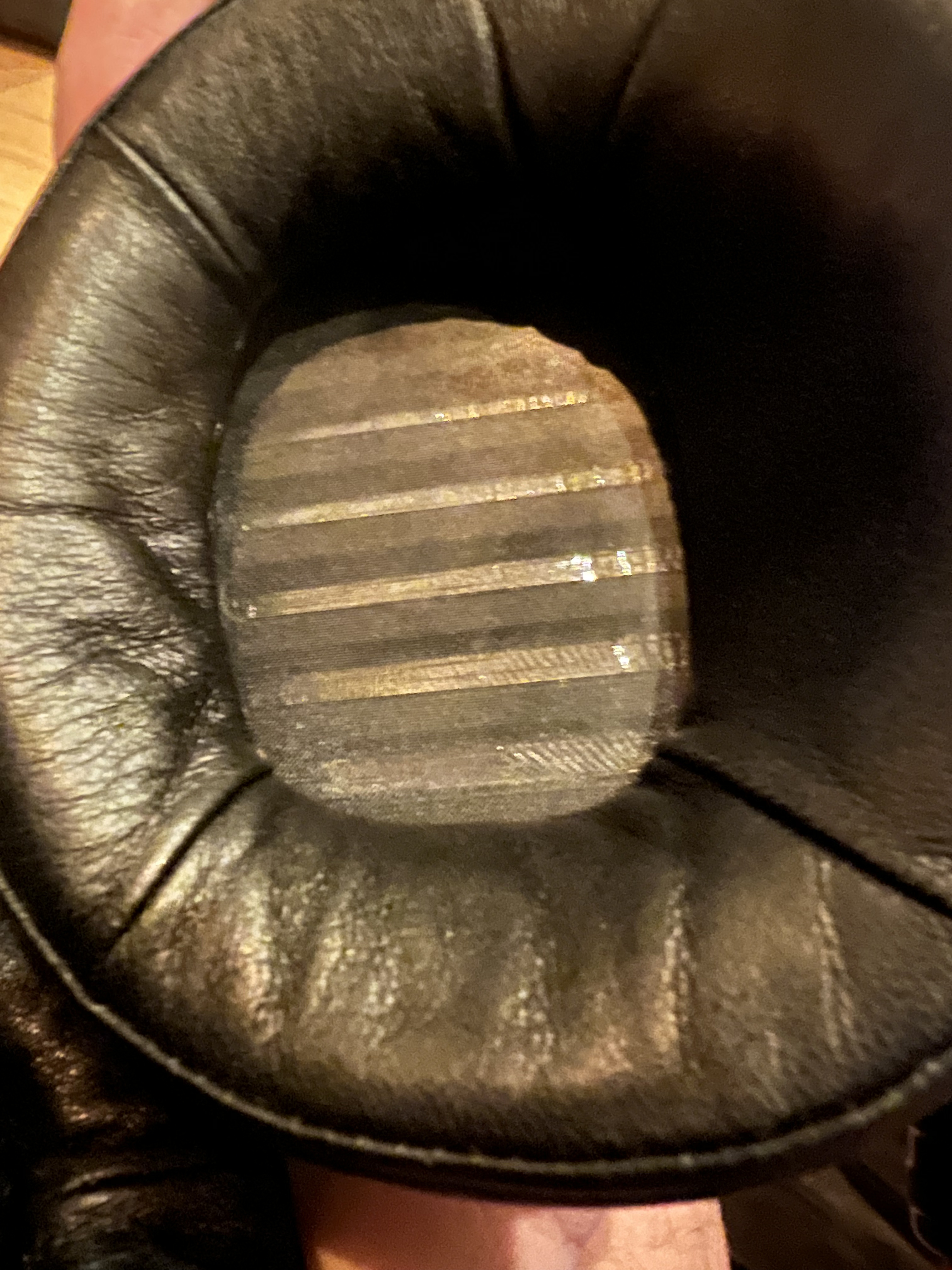

So, after a week or so getting used to my new CRBNs, I went back to the LCD-5s for about an hour on Saturday night, a short period on Sunday (trying to A/B test between the two back to back), and then did zero listening on Monday.
Last night, I put them on to listen to light music while playing a computer game next to my daughter (also playing the same game on another computer sitting next to me). The volume was low so I could hear if she said something and could then quickly mute the volume. I took them off briefly, then put them back on only to hear a crinkling noise that wasn’t there before. So, through the process of troubleshooting the new (concerning) noise, I took them off and tried to make sure everything looked okay, ensure there was nothing in them, etc. After putting them back on again, the right side no longer played anything.
Upon further inspection, I could see wrinkles in the material behind the grill of the headphone on the right side of the image below. Also, I did try swapping the headphone cable to double check it wasn’t the amp or cable in any way. So, the right side is now dead.
I’ve emailed Audeze’s support and have been escalated to someone higher up for help here. No idea what will happen next however.
Unfortunately, I won’t get a fair chance to compare the LCD-5s to the CRBNs before my time runs out to return either the LCD-5 amp, or the CRBNs themselves. My guess is that this repair process will take weeks to resolve. It took a week just to get my CRBNs due to FedEx delaying shipping 3 days. Why Audeze doesn’t ship with a guaranteed timeframe on $4500 headphones is another topic however.
Oof. I was about to say crinkling on totl planars is normal until I saw your pic. Chances are low, but it may be worth an ask to see if you can get a longer return window in the CRBNs so that you can finish compairing.
Sorry to hear about your headphones. I will say that I have communicated with Audeze a few times and that the service and communication that I received every single time has been exceptional.
Ahh man that sucks.
I just put a pre-order in for the January batch. I hope this is just a one-off failure that is quickly resolved for you.
I also hope that this doesn’t become a widespread issue and that these new drivers are found to be very durable.
Keep us posted on what you learn!
Here’s the latest update from Audeze (after asking about timelines and the new headband),
Hey Adam
We’re currently working on a new run of LCD-5s, and don’t currently have any in stock, but we’ll be shipping those out as soon as more become available. We’re looking at probably the second week of January on that new run.
With regards to the clamping force of the headband, with our latest production run we’re officially switching over to the lower clamping force version you may have read about, so your new unit will come with that alteration. I hope you find this change a little more comfortable.
So, for now, we wait. I’ll just have slum it with the CRBNs.
And, no complaints with their support. It’s mostly on par with what I’d expect for a high end product. The only recommendation I’d have for them to make this a better experience would be to keep a stock of warranty units on hand to immediately overnight ship when failures happen.
They also asked if I added excess pressure taking them on / off, or setting them down on their pads. I keep them off their pads 100% of the time (and hung when not in use), and I’ve never thought I was putting them on with excessive force. I’ll pay more attention to the new set, but I VERY MUCH doubt there was anything I did that lead to these failing. I’m pretty careful with my equipment, and seldom have issues. So I’m chalking this up to a defect. And, regardless, Audeze is taking care of me, so we’re good here.
I have found over the years that audeze has the best customer service of all of the TOTL companies
Honestly, I quite like hifimans support as well. They suck to cominicate with because of the time difference for me (they respond to my emails at like 2am my time) but their propensity to just go “just ship us the can and we’ll give you a new one” is pretyy damn nice tbh. I think they rank on a similar tier to audeze in this aspect.
@jlbrach - I agree completely.
