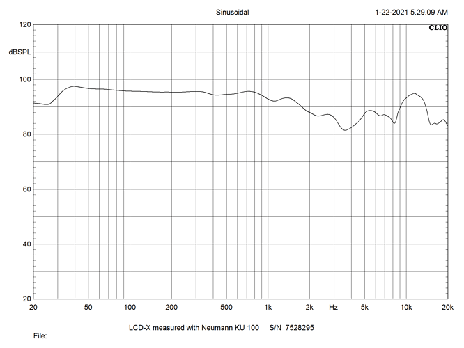

Here is the frequency response I received from Audeze. For your statistics for EQ-ing. Looking forward to it @Resolve (btw, thanks for your great reviews, it helped me a lot to come to a decision=

So it seems like there is still unit variation even in these new units, that’s disappointing… Here’s another “newest model” FR graph from someone on head-fi which has a more prominent 3.5k dip compared to yours. This is similar to the early 2020 model I have, but not as pronounced and has an additional 1.5k bump:

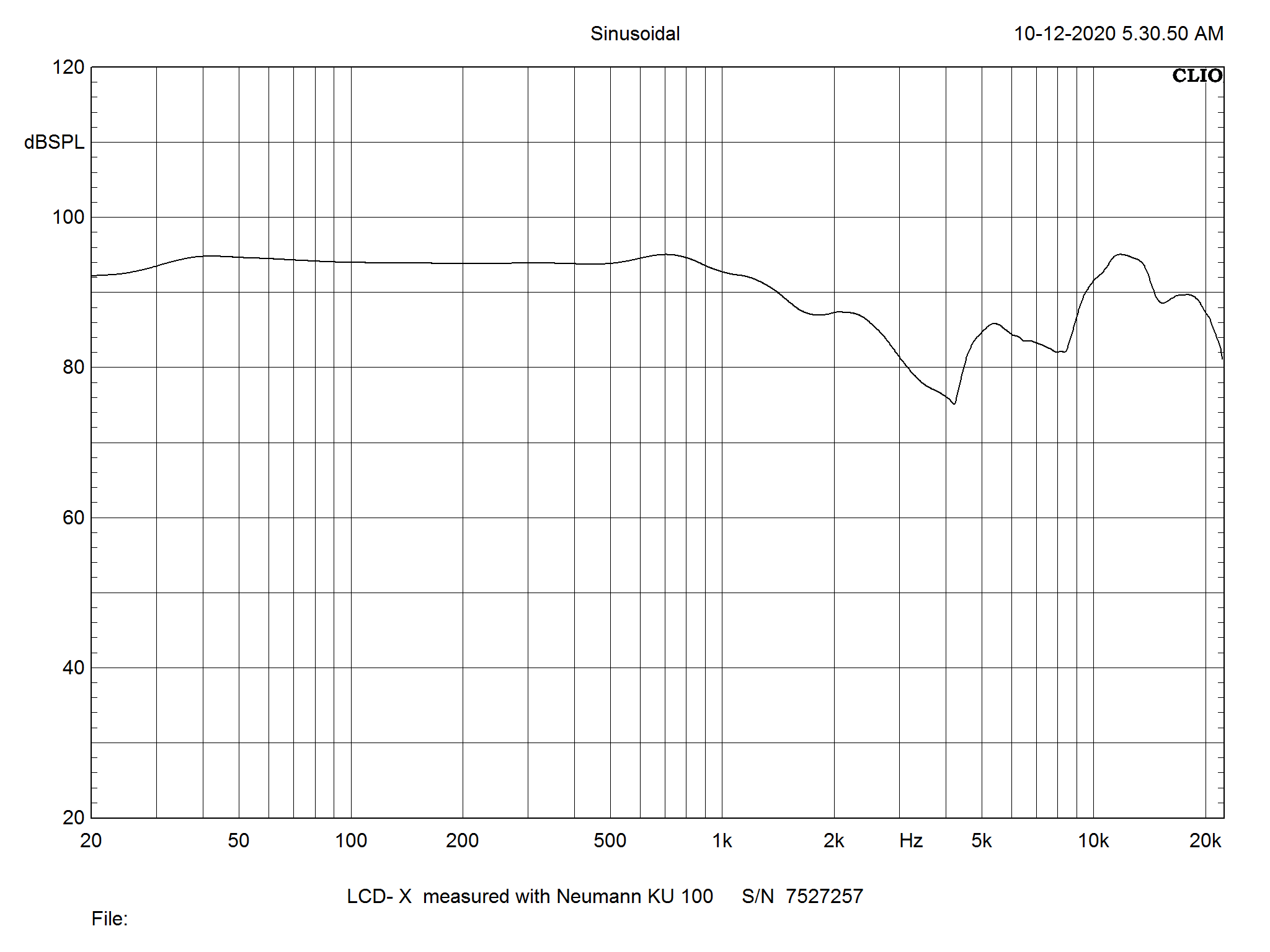

For reference, here’s my early 2020 unit’s frequency response:
I did some testing to try to glean how much of the tuning change was pad-based vs. driver based (for those of us who bought the version with memory foam pads).
The (exciting) results, are posted here.
TL;DR The tuning change seems to be very much pad based, to the point where changing pads on my Oct. 2020 LCD-X made it sound nearly identical to the 2021 pair Resolve measured (on the basis of sine sweeps, anyway).
For comparison’s sake, here’s my pair of Oct. 2020 LCD-Xs with memory foam pads.
I would take any KU100 graph with a giant and massive grain of salt. That is a microphone for QC, and it isn’t particularly good at taking real FR measurements. We can start nitpicking the FRs more when @Resolve has more graphs produced on real 711/60318-4 compliant equipment i.e. GRAS.
Is the KU 100 more, or less accurate than a Mini DSP EARs?
