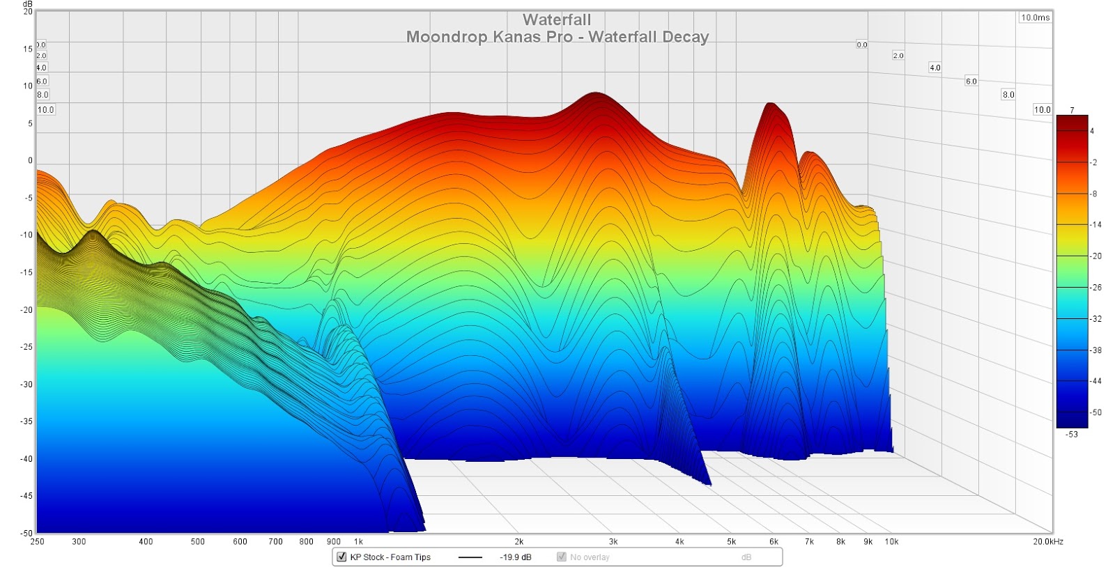

These three IEMs share some similarities in sound but primarily have distinct sound signatures. The most neutral of the three is the Kanas Pro, which strictly follows the Harman Target curve except with upper end emphasis. The T5 is a warm, rich and laid-back sounding IEM which does roll-off in treble significantly, while the DM6 is a U-shaped IEM with emphasis in bass and treble.
The bass response of the DM6 is the greatest, and surprisingly not muddy. It’s generally very clean however elevated. The T5 and Kanas Pro have similar bass responses in terms of punch and impact, but the T5 does have a richer and more filling sound compared to the Kanas Pro. The DM6 is easily the punchiest of the three and also extends well down more than the other two. I like the Kanas Pro signature the best as it’s just north of neutral for me and it’s easily the cleanest and most detailed of the three bass responses. The DM6 is the most fun though.

Like I mentioned, the T5 treble is rolled off and generally very tamed down. This keeps the signature very warm and laid-back and lacking clarity and distinct details. The Kanas Pro finds a good balance in the upper mids and treble hovering around neutral generally until the upper treble where it does spike up. Some people may be sensitive to it, however I am not one that is. The DM6, on the other hand, does have elevated treble and unevenness in this region which can be harsh on many tracks. It has a pretty large peak around 6-7KHz which can sound piercing in some songs. I never found music to be sibilant though, as it does drop off in the sibilance range. Generally, I found the DM6 to be a slightly harsh, especially on bad recordings or treble-focused songs.

The Kanas Pro has already been heavily reviewed by me and was given high marks. When comparing it side-by-side in detail with these other similarly priced contenders, I find no reason not to continue to recommend it as a great all-around IEM for many listeners. It strikes a great balance in sound and should work across many genres, giving users a very clean, detailed, and balanced sound signature.
