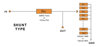

Whatever JDS is doing, here is a brief primer on how to do a stepped attenuator with resistors. All of the following is copied from Khozmo Acoustic, but I imagine you could find similar material at various electronic tutorial sites.
1. Series. Main reason to use this is invariant input impedance presented to source. Volume steps up as fewer resistors stand between input and output.
2. Shunt. Advantage here is that only a single resistor is in the signal path. Disdavantage is that now the source sees a varying input impedance.
  1. Ladder. Advantage is that it presents constant input impedance to the source while still leaving only one resistor in the signal path. Disadvantage is that it requires 2 resistors per step.

The question is whether the volume is adjusted in the digital domain, not whether it’s controlled with some digital electronics. The optical encoder could easily be used to switch relays that bring resistors into or out of the signal path. That would work for any of the resistor-based approaches (series, shunt, ladder).
