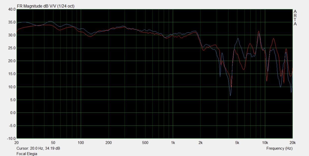

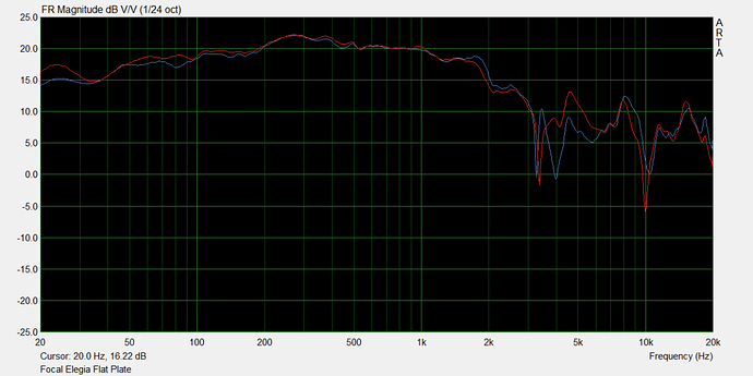

I took some measurements with my EARS and flat plate coupler:

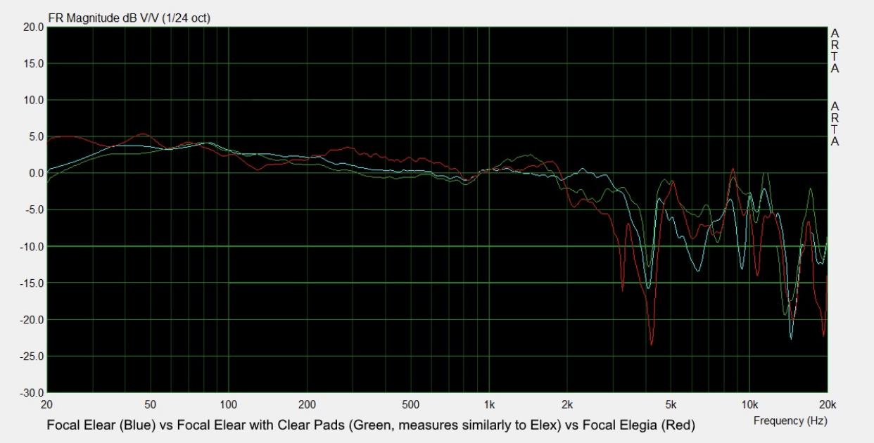

Here’s a FR measurement comparison with the Elear, Elear with Clear pads, and Elegia:
As you can see, the presence region past 5kHz is closer to the Elear with Clear pads (which measures identically to the Elex) than the stock Elear, but it does seem to have a bigger upper midrange dip which I honestly don’t think is as severe on the Elegia as the Elear, but I could be wrong.
