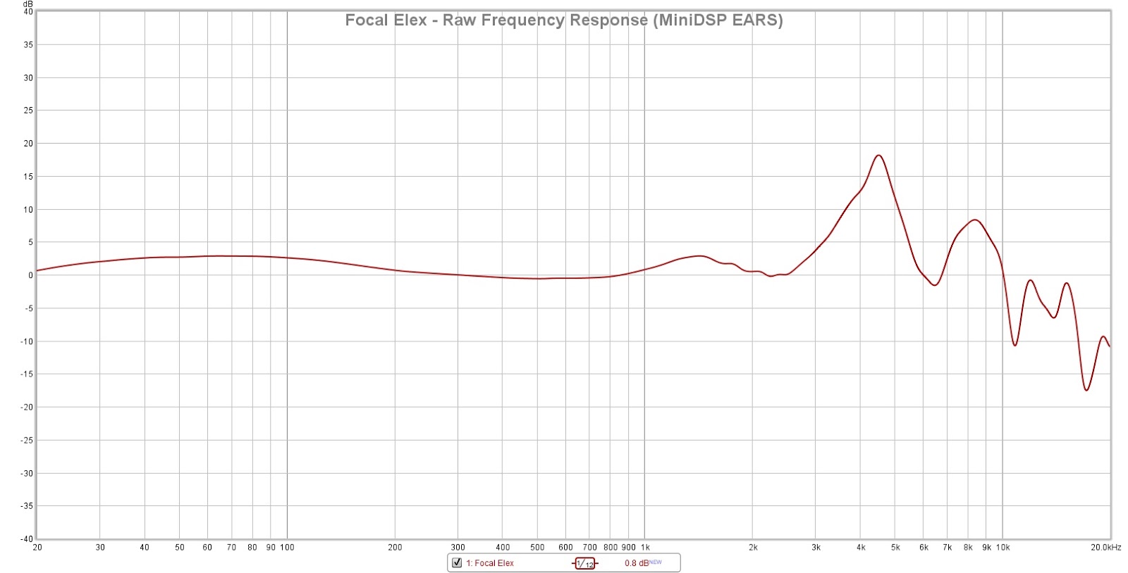

Frequency Response (snagged from Head-Fi/Massdrop)

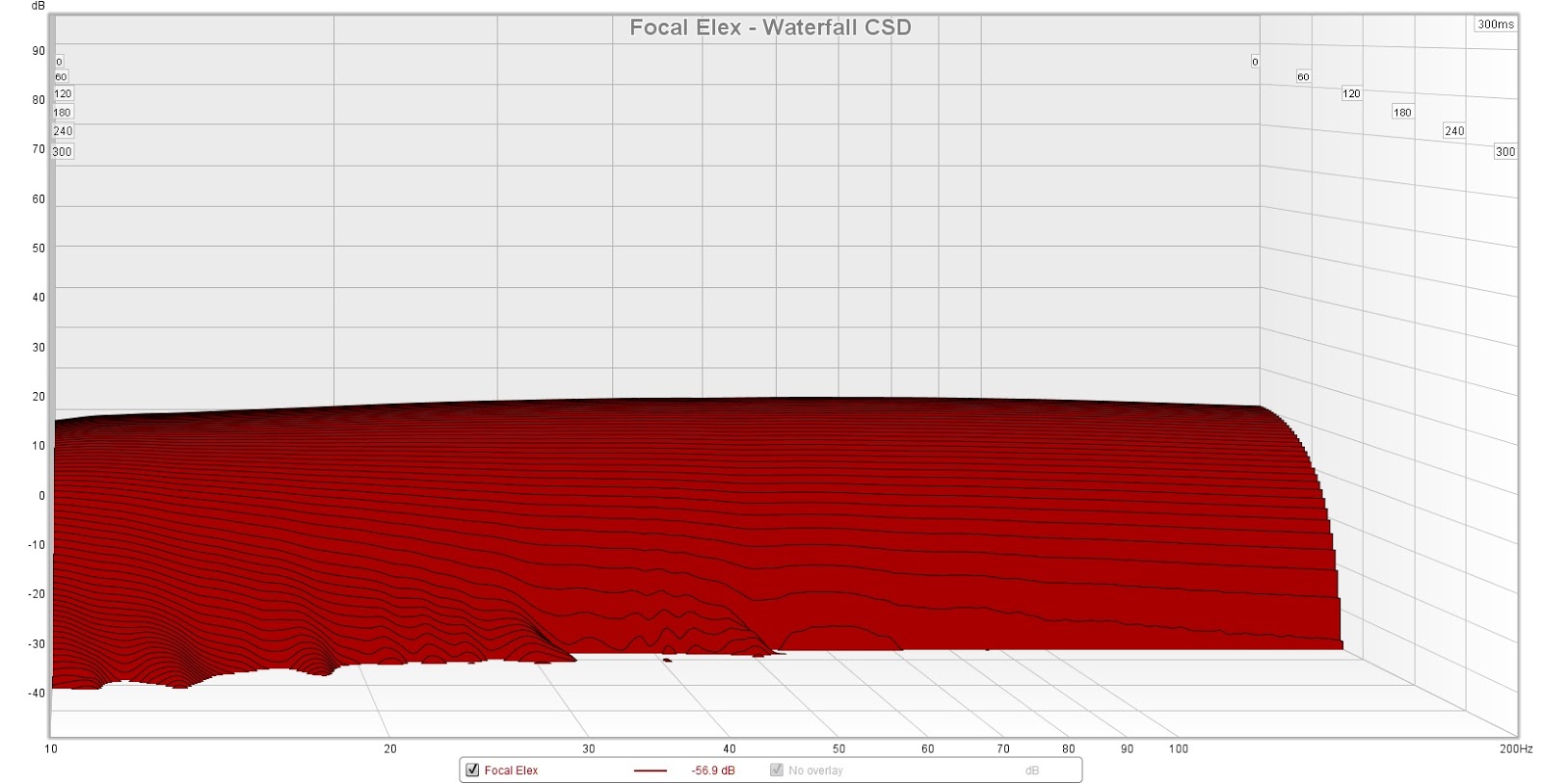

THD(snagged from Head-Fi/Massdrop)

Speaking of the two, in my measured MiniDSP EARS responses, they look very similar, outside of the region between 1-3KHz. In this area, the HE560 becomes a little recessed, putting vocals slightly back, while the Elex moves them forward. The bass and the treble response are very similar besides that.
