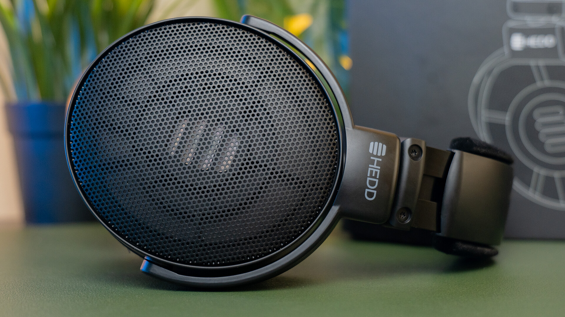

HEDD Audio HEDDphone D1 - Frequency Response Measurements & Discussion Thread
This is the thread for measurements and discussion of the new HEDD Audio HEDDphone D1, an open-back dynamic driver headphone retailing for $800 at Headphones.com.
Check out our reviews of this headphone done by Resolve on YouTube, as well as by myself on our blog The Audio Files.
Below you’ll find measurements of the HEDDphone D1 done on our Brüel and Kjær Type 5128 HF-HATS.
