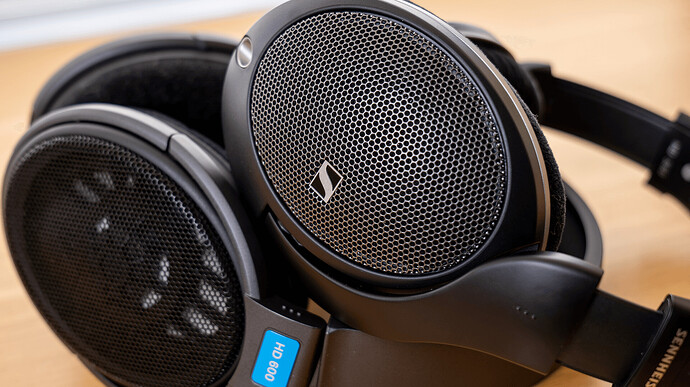

  • It’s very lightweight, under 250g, and I find it quite comfortable. Big earcup openings.
  • Not a big fan of this chassis design, especially with the awkward yoke style. I much prefer the HD 600 pivot design.
  • Easy to drive, but single entry cable with its locking mechanism is less than ideal for me.
  • Sound is very neutral, balanced and natural if a bit on the analytic side of things. I personally prefer a bit more bass, but the extension here is decent. The midrange is particularly good, and it reminds me of the HD 600… in a good way. The treble is also well done, with just a hint of stridency in the lower treble, but significantly better than the treble of the HD 560S
I really like this headphone a lot. It’s the best Sennheiser release in years, and one that will likely stand the test of time. I’d take the HD 550 over the HD 660 S2 any day, and I’m glad to see them go in this direction.

I’m going to keep this brief because the comfort and accessories are literally identical to the HD 505 that I just reviewed, so if you want all of the details, feel free to check out that review. HD 550 shares the same chassis as far as I can tell, the same pads, the same headpad, the same cable, and the same bag.
Touching on visuals, to be honest I prefer the look of the HD 505. This more muted grey and black probably works better for the people who want their headphone to be minimally distracting, but it also (partially due to the swirly single yoke design) looks much more dated and austere than the HD 505. Even if it doesn’t necessarily make me want to use it less, the HD 550’s somewhat drab visual design may well have that effect on others.
All of my notes on comfort from the HD 505 review could be pasted here with no changes, though. I actually kind of like the ear comfort of this chassis now that the clamp has been reduced, but I really dislike the headband pad. No notch in the center of the headband and insufficient padding make it among the less comfortable “lightweight” headphones I’ve tried for comfort.
I will note here that I wear the HD 550 the same way that I wear the HD 505: pushed as forward and low on my head as possible, which involves the flange of my pinna tucking underneath the backside of the earpad slightly. This has been a common recommendation for as long as I’ve been in the hobby, and it’s also how I measured the headphones to best reflect the response I may have gotten when wearing them.
Credit to Meier Audio
Unfortunately though, not everyone is going to find this position comfortable or natural, and as a result other people may get a different (likely brighter) sonic result listening to HD 550 than I get. All I can do is review the headphone as it naturally sits most comfortably on my head, so apologies to those who feel this review doesn’t accurately reflect their use condition with the headphone.
