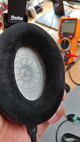

I took off my HD58X’s pads for cleaning a couple of days ago and noticed that the foam covering the drivers on the inside is surprisingly dense and thick. I’ve heard some people report positive improvements from removing foam, though I had always assumed they were talking about the rear foam which in my experience doesn’t change the sound. So today I removed the front foam and it does indeed transform the HD58X, bringing the upper mids and treble up, and the mid and upper bass down a tad, bringing the response more in line with something like an HD600 (except with better sub-bass extension).
Hello clarity, hello detail! Keeping the foam out isn’t a permanent option because it’s there to keep dust out of the driver. Time to find something acoustically transparent that I can use as a dust shield. Suggestions welcome!
Oh wow! I decided to use some sheer curtain fabric to protect my driver from hair and such. It’s not completely acoustically transparent, but it actually brings the lower mids and bass back up to stock and leaves the upper mids and treble open and airy (with less of a peak at 8 KHz). This sounds frickin’ amazing and looks slick too!
I see a business opportunity here. :smile:

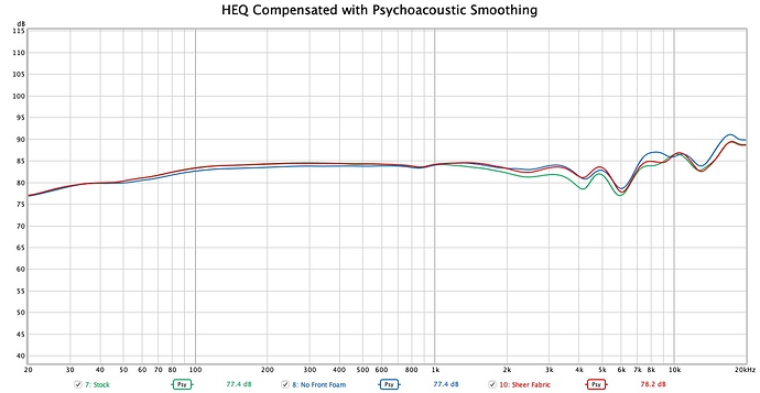

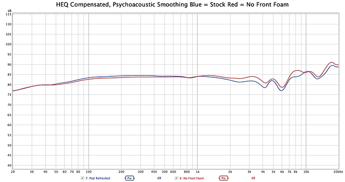

@antdroid asked how this compares to an HD600. Here are some measurements (E.A.R.S. HEQ compensation, psychoacoustic smoothing). Sadly I don’t have the HD600 on hand anymore to do listening comparisons.
