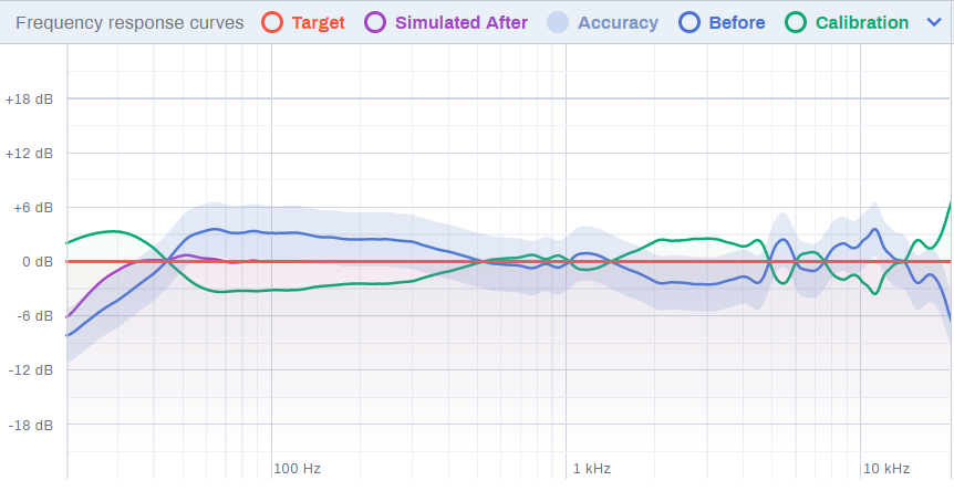

Nevertheless, this is what Sonarworks considers for “correcting” the 58X:
Their fix makes the 58X sounds shouty (and boring) in the upper mids. I’ll give a simple track as example: Back to Black from AC-DC. Not to mention that if the curve about is accurate, there’s minimal to none EQ needed on this can. And for less than $200.

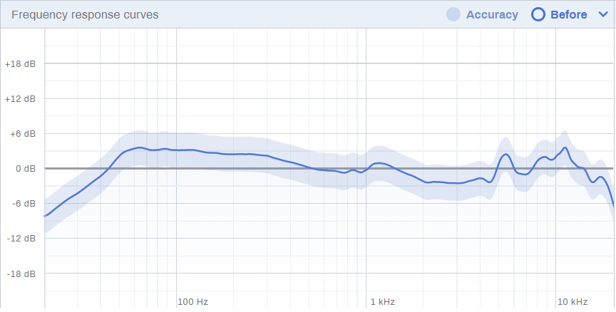

I’m not familiar with either of the other two, sorry. Is that the frequency response after EQ has been applied, or is that the EQ curve being applied? Or is it just the 58X’s FR?
Bingo. ![]()
Note the Bollinger Band around the measurement. That is a variance of roughly 6dB in the whole spectrum*. In the end of the day, a custom EQ tuning will always be the best choice.
* Once again, assuming those measurements are accurate.

Reference 4 DSP boosts/cuts frequencies (green curve) according to “their” target (0 dB red curve):
Concept is quite simple. The question is, what is the target for them? I don’t know.

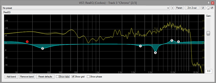

I’m routing the signal into my DAW (Cockos REAPER) and can apply different DSPs to the music as individual tracks. So, before making a judgement into your settings, I would like to know if this is the expected correction curve (the turquoise filled line), or maybe I missing something*?
* For terminology, I believe what you call Peak, REAPER calls it as Band. Hopefully it’s the same thing. If Band it is, there’s still 2 variations of it, which may produce slightly different EQ curves in REAPER.

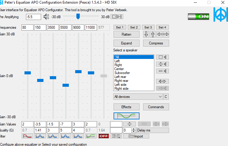

What options does it give you per band? In Peace what I call “peak” is the type of adjustment filter I add to a band.
My EQ curve looks like this:

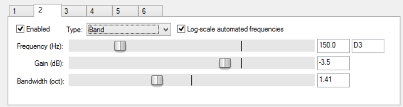

Thanks. Definitely not apples to apples. This is the band parameters, for instance:
Thanks for posting your curve. It has very subtle adjustments and now I can sleep in peace (pun not intended).
Seems like you can adjust the same settings, hopefully it sounds the same! Let me know what you think

I’m happy someone already had similar doubt before. Too bad REAPER stock plugin truncates the calculated value so there’re still a small variation. Looks now much closer to yours though:
