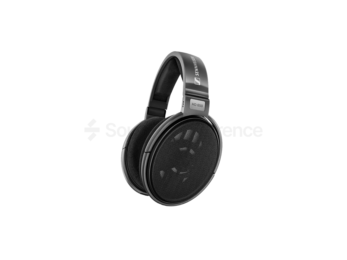

I think the Sennheiser HD 650 sounds excellent with no EQ on the majority of recordings. Probably one of the most neutral headphones at any price.

Nope, too much mid bass. Way too much mid bass and not enough oomph in the vocal range.

Not according to the Soundworks measurements. In fact, just the opposite of the statement.
Then Soundworks is full of cr*p. Your ears matter. Measurements are secondary. Always. This is perception science, not subjectivism.
From a science perspective, the Sonarworks article is a lot more accurate and backed with evidence than one’s opinion. Check out the measurements. The HD 650 measures quite a bit better , or closer to neutral, than many headphones available.
Listener’s preferences are all over the map, and often don’t line up with measurements regarding neutrality. Horses for courses.

Sonarworks is measuring headphones to a standard the touts a minimal amount of frequency deviation from 20 to 20 KHz. . Their definition of neutral frequency response is as good as any other reference. The headphones I’ve owned or auditioned that are supported by Sonarworks measurements have demonstrated (to me) that their EQ works well.
I’ll stand by the assertion that the HD 650 is one of the more neutral headphones as measured on the market. That assertion has no connection to what a given listener prefers. Many well regarded headphones, such as the Abyss 1266, has some significant frequency deviations.

When shopping for my first serious headphones I demoed the HD 650 but bought the HD 600. This followed from the overly thick bass and rough perceived character of the 650, as well as a zillion reviews circa 2014 saying that the HD 650 has a warm tilt. Here’s a Google AI output for “Is the HD 650 neutral” – it indeed replicates a zillion reviews from 10 years ago and parallels my direct experience too (highlights in original):
The Sennheiser HD 650 is widely regarded as a mostly neutral headphone with a slightly warm and musical sound signature. Its tuning emphasizes a natural and engaging midrange, making it an enjoyable headphone for long listening sessions. However, it is not perfectly “ruler flat” and exhibits some deviations from a strictly neutral reference sound.
The HD 650’s sound characteristics
  • Warmth and midrange focus: The HD 650 is known for its “laid-back” and “musical” sound signature. It has a slightly elevated mid-bass, which provides a sense of warmth and fullness. The midrange is a standout feature, praised for its accurate and lifelike reproduction of vocals and acoustic instruments.
  • Rolled-off bass and treble: Compared to a perfectly neutral target, the HD 650 has a noticeable roll-off in the deep sub-bass and the upper treble. The bass is present but lacks deep extension, which can make some bass-heavy music sound less impactful. The upper-treble roll-off contributes to the headphone’s smooth, non-fatiguing character and is sometimes referred to as the “Sennheiser veil”.
  • Calibration for accuracy: For users who desire a more accurate and linear frequency response for critical mixing or mastering, the HD 650 is an excellent candidate for digital calibration software. Applying a custom EQ can flatten the frequency response, improving sub-bass extension and overall neutrality.

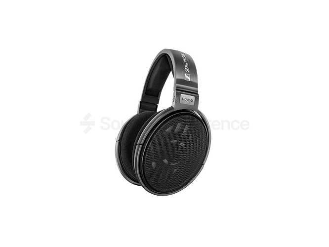

From the Sonarworks Blog:
“Sound
Sennheiser HD 650 are pretty much the most neutral headphones available on the market. However, their sub-bass response is lacking (frequencies below 100 Hz) and high-mids (around 2-5 kHz) need to be tweaked a bit. Otherwise, they are pretty much good to go straight out of the box.
Channel balance
You would expect from headphone manufacturers perfect matching between left and right drivers. Unfortunately, in the real world, this doesn’t happen too often – pretty much every other pair of headphones have channel inconsistencies even among the well established pro headphone brands. By contrast, Sennheiser is a true expert in offering headphones with matched left and right drivers so that soundstage stays consistent across the spectrum. With some minor exceptions, Sennheiser HD 650 has hardly any inconsistency between the two drivers. On a rare occasion, pairs have slight differences in bass and sub-bass region, but the magnitude is low enough to not cause audible issues with imaging.
Sennheiser HD650 vs HD600: what’s the difference?
The HD650 is the more relaxed sibling: warmer low mids, smoother treble, and a touch more bass body. The HD600, by contrast, has a leaner bass profile and a more forward presence region (~3–5 kHz), making it feel crisper and sometimes harsher on poor recordings. Think of the HD600 as a surgical monitor and the HD650 as the more musical long-term companion. For critical neutrality → HD600. For fatigue-free listening sessions → HD650.”
