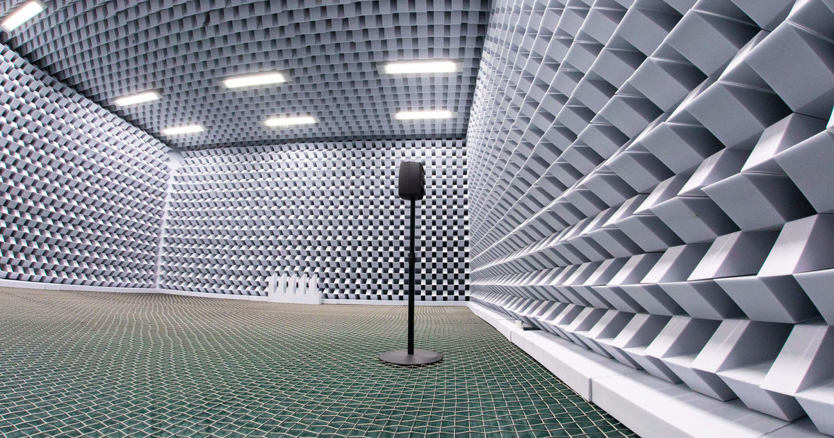

Studies like this one by Genelec and Aalto University suggest that delays on the order of a millisecond may be detectable at certain frequencies.
Delays in this range will also exceed the period (difference in time between consecutive peaks in phase) of higher frequency signals. The period of a 4 kHz signal is 0.25ms, for example. While a 10 kHz signal has a period of only 0.1ms.
