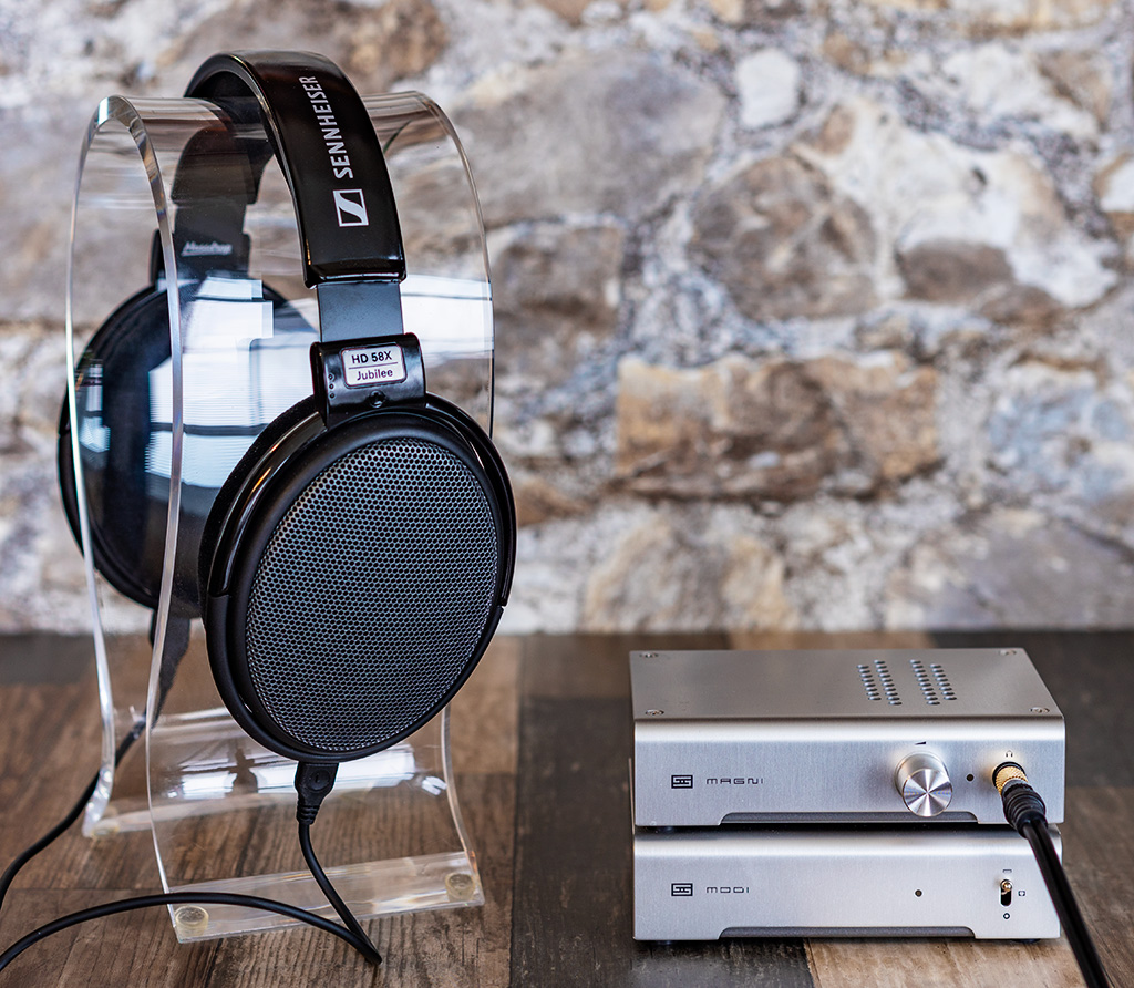

Well, again, DAC-wise, Modi 3 and SDAC are both easy-to-match and well-performing (subjectively and objectively) DACs. Amps like the JDS Labs Atom, Liquid Spark, Magni 3 and Vali 2 will all do proper job with most headphones in terms of drive-ability.
I don’t think there’s a bad combination possible with those components.
I still like the SDAC + Liquid Spark + HD58X as a setup, as well as the Modi 3 + Magni 3 + HD58X, and personally I’d lean to the latter here as I like the matching stack and prefer the Modi 3’s performance over the SDAC, but in real terms, again, any combination of those components will be good:
Now, the SDAC + Liquid Spark will be a bit warmer sounding than, say, Modi 3 + Atom. But the Modi 3 + Atom is the technically most proficient pairing out of these units … at least per measurements. For me, probably not enough for me not to just go for matching components and if doing the Modi 3 it’d be a Magni 3 or Vali 2 I’d pair with it … but if aesthetics aren’t a big concern the Atom is a better amp.

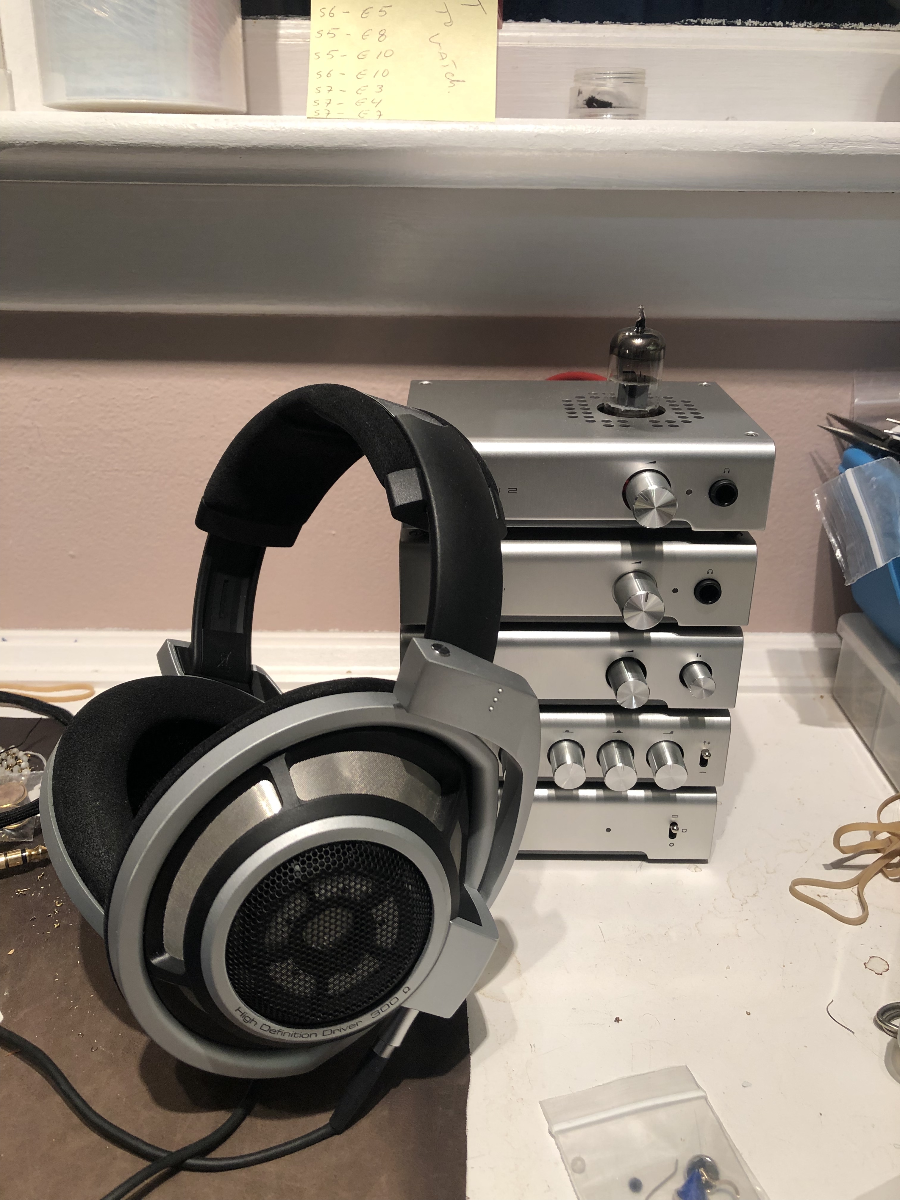

Modi 3 - Vali 2 is my studio set up and I love them with the HD800. Magni 3 is great, I just find myself connected to Vali 80% of the time. Schiit has a “B stock” department and you can save a few. I got Modi and Vali for $190 plus shipping . The downside of B stock is you lose the 15 days return policy .
Your photography skills are exceptional. You make all the gear look so beautiful. Respect.
