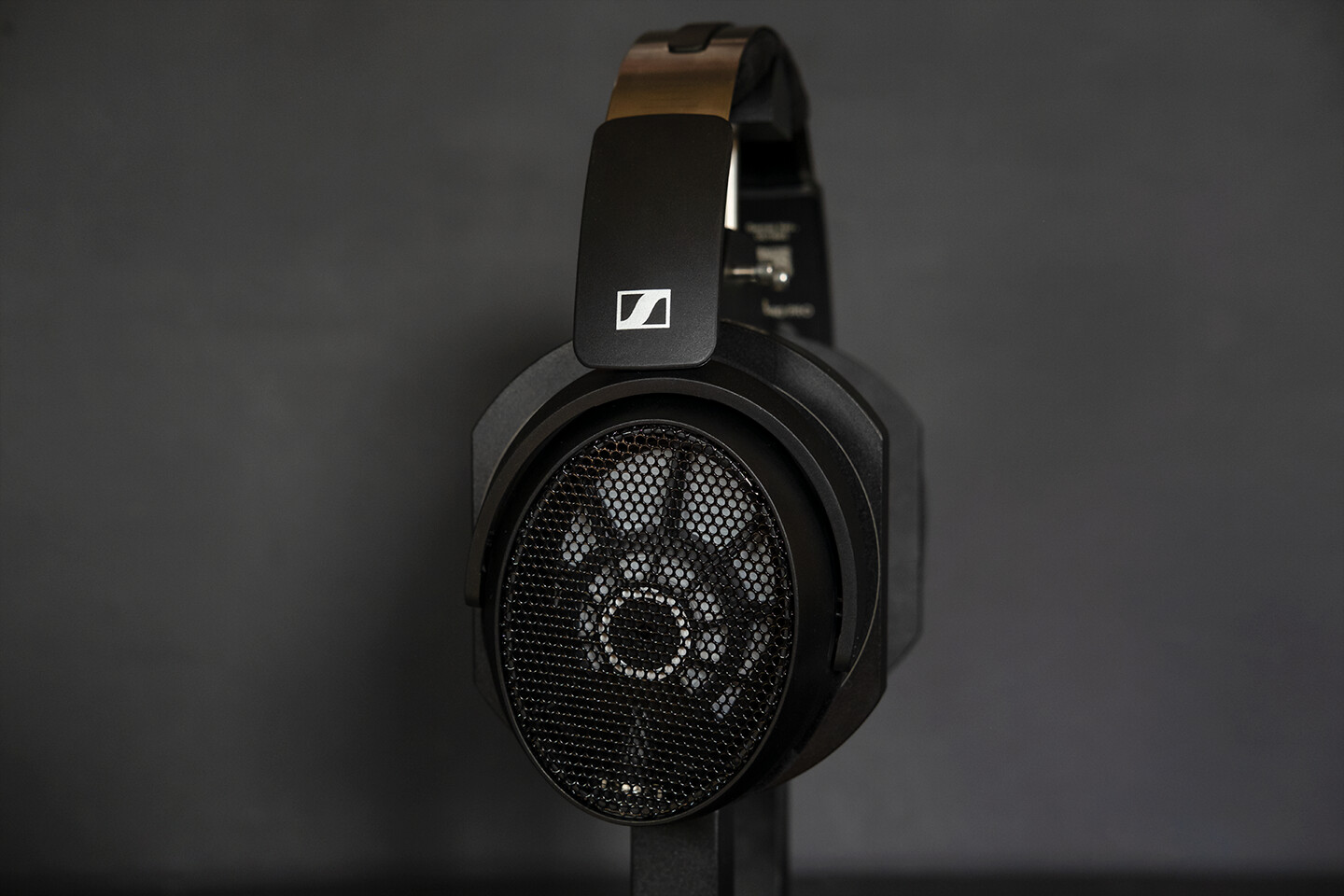

Perhaps the most interesting thing about this release is that this is the first time we've seen a brand new chassis from Sennheiser in what feels like a very long time.
I actually quite like the approach to visual design they took with this. They’ve blended elements of the modern 6 series with design cues from the more consumer-oriented Momentum series. It looks cool, but not ostentatious, and on the head it doesn’t jut out obtrusively like many audiophile headphones do.
It also happens to be the most comfortable design they’ve released since the original HD 800. HD 490 Pro is very light overall, weighing a modest 260g, but also feels rather sturdy in the hand. The main headband piece is made of metal, and the headband arm-length adjustments click up and down very satisfyingly, in a way that reminds me of the Austrian Audio headphones. The ear cups swivel a full 180°, and they conform to the natural angle of the temple/side of the head rather easily.

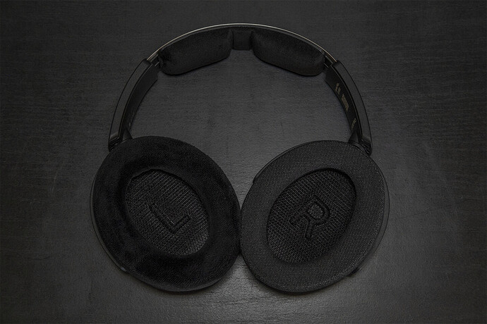

I’ve still got some comfort nitpicks though, my first being the depth of the ear cup. The drivers are oriented at an angle such that they interact with the ear on a more parallel plane, which is a good step towards making sure the rear part of the ear doesn’t touch the dust cover (like mine does with the HD 6 series headphones). However, a little bit more cup depth and height would have gone a long way towards making it more comfortable for me. With the Mixing pads in particular, my ears start to touch the dust cover in front of the driver slightly, and it bothers me. It’s especially annoying because the Producer pads—which I don’t prefer, sonically—don’t have this issue, and are… insanely nice.
Whatever fabric they used for the Producer pad is the softest, most luxurious I’ve ever felt on a headphone pad. I want every ear pad to feel like this. These pads are also the quickest to get hot, causing my ears to get a bit too warm with extended listens, but it’s still very comfortable overall. The Mixing pads by contrast are made of a backpack-like material, which is less soft to the touch, but much more open—and therefore cooler. I much prefer the feeling of the Producer pads, but as we’ll get into, I prefer the sound of the Mixing pads.
My main gripe with this design in terms of comfort would probably be the lack of suspension strap. After all these years, I remain surprised that Sennheiser isn’t interested in exploring one. But here we get a slightly different take on the “two nugget” headband padding that you find on the HD 5 series, and we get two versions (in the Plus version of this headphone) of the headband pad included in the box. They’re both soft for sure, but a little bit too thin overall—both in thickness and in width. They’re just comfortable enough to allow someone to use the headphone for an hour or two (but not much longer) without getting a hotspot.
In its current state the HD 490 Pro is probably about a 7 in terms of comfort, which is still pretty great compared to most headphones, but if it had a suspension strap and a smidge more room for the ear, it would be an easy 9 for me. Comfort is where I had the highest hopes for this design, and while it didn’t necessarily blow me away, I gotta give credit where credit is due: it’s a pretty comfortable headphone, certainly more so than the prior HD 5 or HD 6 series chassis.

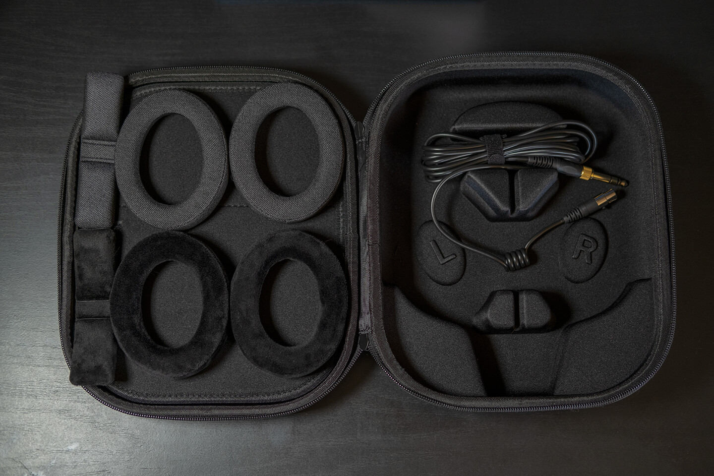

With the HD 490 Pro, we get two pairs of pads, and the differences between them are such that both options are actually valid choices, while being overall rather different presentations.
The Producer pads end up outdoing many of Hifiman's less expensive planars like the Sundara or HE400SE in terms of raw bass extension. However, it’s not exactly heard as having “huge bass,” in fact I’d say the opposite is true—if I had a word to sum up the sound with these pads, it would be “thin”.
