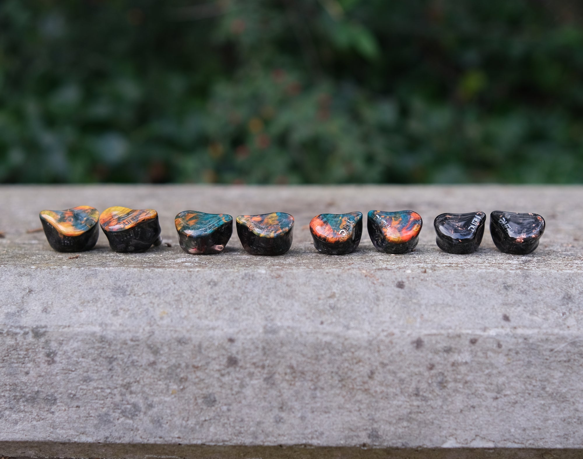

Several of the prototypes that I provided feedback on.
The next several iterations of the collaboration IEM steadily improved, but showgoers that listened to those prototypes at CanJam Socal 2022 and NYC 2022 mostly had mixed feedback. I certainly wasn’t satisfied, and I consistently sent us back to the drawing board. A complication that became evident was balancing comfort with sound quality, as the two are often inversely correlated. Think of some of the best sounding IEMs like the Sony IER-Z1R, the Symphonium Helios, and the Subtonic Storm - they all sport relatively large shells.
Currently, Mirai utilizes a metal nozzle that is hand-fitted. We tried implementing a 3D printed nozzle instead which was stouter and which would have dramatically streamlined production. But I had to shoot this down because the performance sound-wise wasn't comparable.
This complication required fastidious revisions of the Miria’s nozzle integration. But finally, the hard work and unwillingness to compromise paid off with the last couple rounds of prototyping. We had a version that I thought sounded great, and a final, small adjustment to the tuning on DUNU’s end brought something to the table that I wasn’t sure was even initially possible.

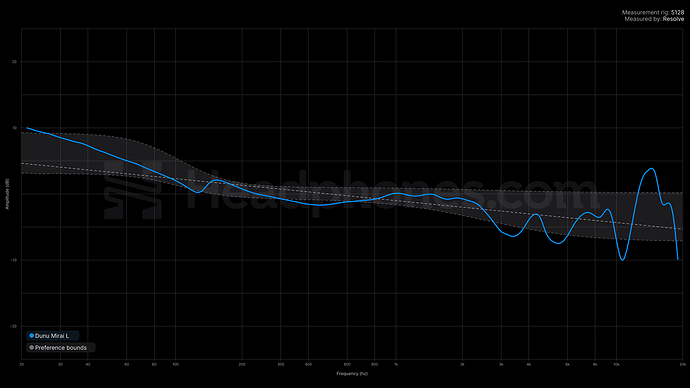

This measurement was taken on the newer B&K 5128 system. The preferences bounds indicate the range for the sound profile that most listeners would prefer based on our research.

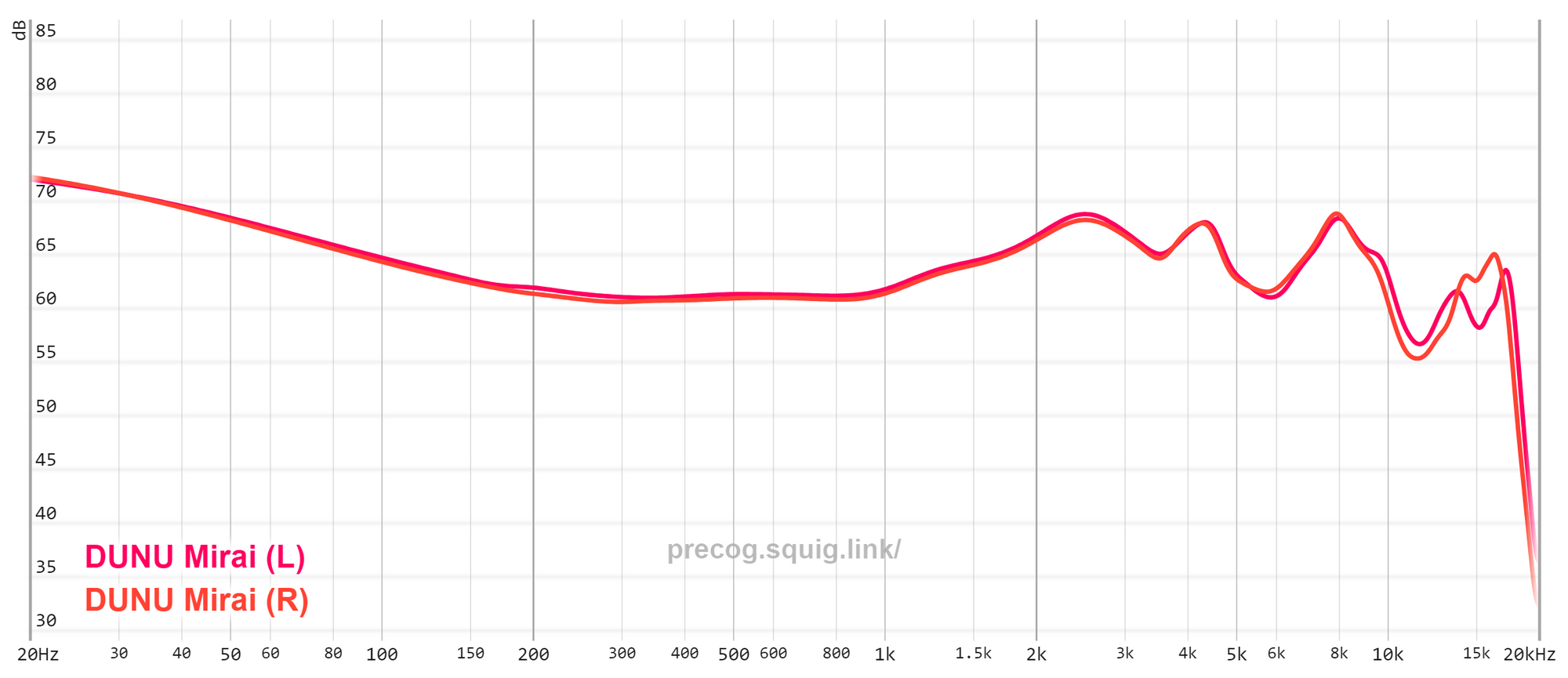

This measurement was taken on my personal clone IEC-711 coupler. It can be used as a comparison to hundreds of other IEMs that I have measured and uploaded to my SquigLink.
A criticism that I had with earlier prototypes of the Mirai was the bass response. The early prototypes lacked appropriate quantity in the sub-bass and they tended to be shelved too early (with minimal mid-bass). Thus, we steadily ramped up the bass. The current iteration has ~10db of sub-bass over 1kHz with a smooth taper into the mid-bass that ends at ~250Hz. It sounds neither disconnected (like a sharp recession to bass at 200Hz will create) nor muddy from excess mid-bass. Bass is present when called upon, controlled and highly coherent for a hybrid IEM.
But the magic behind the Mirai’s sound mostly lies in its transition from the upper-midrange to the treble response. Conventional tuning strategy says that these regions should mostly fall in line with each other or follow the declining trajectory of a parabola. Comparatively, the Mirai’s tuning not only reduces the presence region from 2.5-5kHz but also sports a series of small peaks in the treble (most noticeably at ~10kHz and ~15kHz).
So why did we choose to disregard conventional tuning strategy? There’s several reasons:
- A sense of shouty-ness often results from an overly forward 3-5kHz region. Too much energy in the 6kHz region can also result in sibilance. By giving the Mirai a more “polite” response in these regions, we are able to circumvent these common pitfalls.
- A slight bump of energy at 4kHz brings back some of the ‘bite’ that might be missing if these regions were entirely reduced.
- As frequencies rise, especially in the upper-treble, our ears become less adept at distinguishing between individual peaks. If peaks are kept in quick succession, or they have similar amplitude between them, listeners will hear something closer to a linear brightness.
These tuning decisions were influenced by my experience with IEMs that not only have superior treble extension (think IEMs like the Symphonium Helios and Elysian Annihilator), but that also have unusual peaks and valleys (think the 64 Audio IEMs). The common denominator is that all these IEMs are standouts for subjective technical qualities like resolution and imaging.
In essence, treble response past 10kHz has a crucial effect on imaging performance; appropriate quantity creates the sensation of instruments “floating” around the stage. A sensation of openness to the soundstage can be further enhanced through the use of recessions in frequency response, hence the Mirai’s more polite 3-5kHz region. Finally, the more polite 3-5kHz region relative to the more energetic upper-treble increases dynamic contrast and engagement factor.
The end result? To my ears, the Mirai particularly shines with female vocals, as it’s non-fatiguing while maintaining a strong sense of ‘edge’ (or detail) to midrange transients. Tracks with high-frequency content sound more immersive; musical content positioned at the center of the soundstage pops out and seems to have more room to breathe. The Mirai aims to spice things up for seasoned listeners as much as it aims to impress those dipping their toes into the world of high-fidelity.
