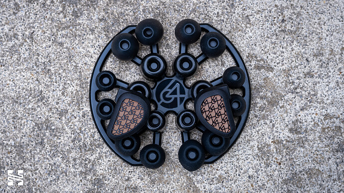

The packaging of the Solo is standard 64 Audio, so no surprises here. We get:
- A black round 64 Audio carrying case
- A puck of foam and silicone ear tips (9 pairs in total)
- Cleaning tool, cleaning cloth, and shirt clip

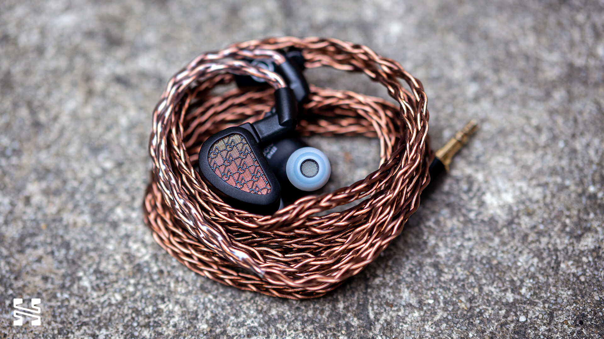

- Two 2-pin copper braided cables - 3.5 mm and 4.4 mm

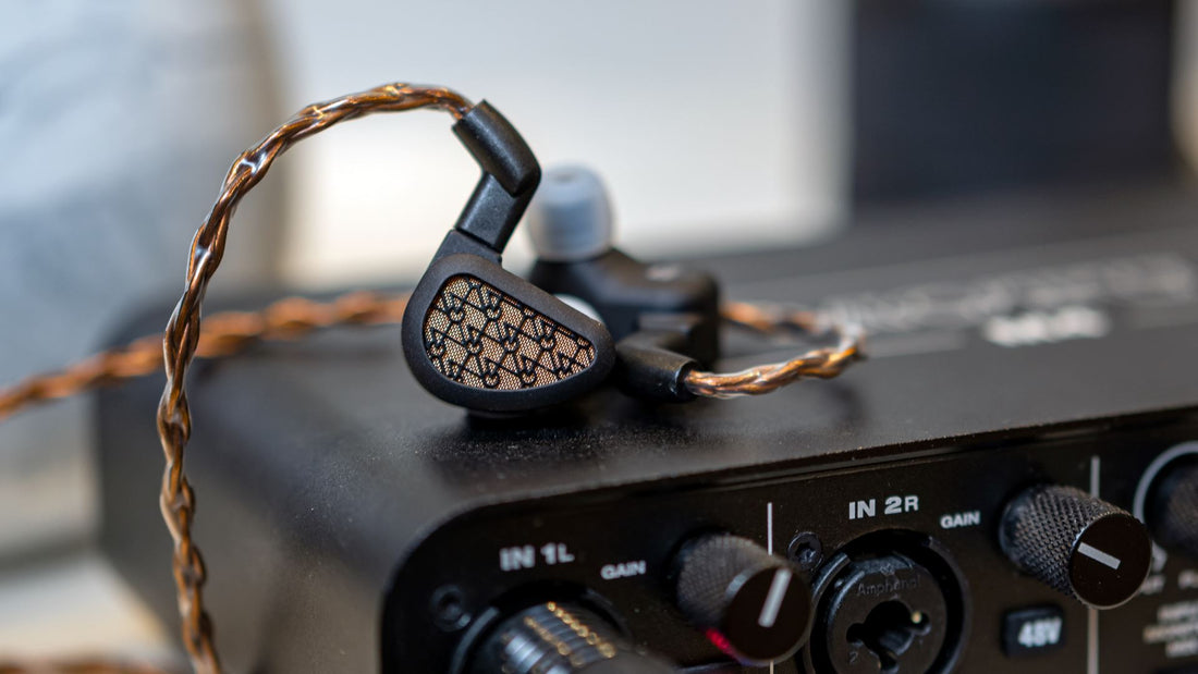

- The Solo itself. It’s made fully of metal with a slightly coarse feel instead of a completely smooth polish.
Personally, I think the Solo is one of 64 Audio’s most beautiful IEMs. I love the copper grill set within the bold black metal shell and repeating 64 Audio logo accents. The copper cable it comes with completes the overall aesthetic. It’s also the best stock cable that 64 Audio has ever included with their IEMs, though the pessimist in me will say that it’s not any different to a $25 aftermarket cable from Aliexpress.
The comfort of the Solo is quite good. Since it uses the standard 64 Audio shell, it’s ergonomic for my ears. Like the other 64 Audio IEMs, there’s also no pressure build-up at all due to the way they’re vented. However, I would recommend using other tips than the stock ones as I find they don’t seal quite as nicely in my ears.
