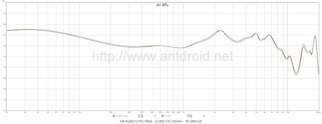

The U12t is a 12-balanced armature monitor that is part of their Tia line. It has 1 Tia high, 1 high-mid, 6 mids, and 4 low BA drivers per side. The tubeless Tia design also features the 64 Audio Apex and LID technologies. The Apex tech allows pressure relief through swappable modules that reduces air pressure during usage, with some slight changes in tuning depending on the module. The LID is 64’s linear impedance design, which allows the IEM to sound similarly regardless of the source impedance.
To test this LID technology out, I used my IEC-711-style coupler to measure the frequency response of the U12t with a near zero ohm output impedance source and then placed a 75 ohm impedance adapter between the source and the IEM cable and re-measured the FR. As expected, the measured response barely changed at all, so the LID technology works! I re-ran the same test with a couple other multi-BA IEMs in my staple (qdc Anole VX and Hidition Viento-R), and they all had significantly varying frequency response measurements at the two impedance values.

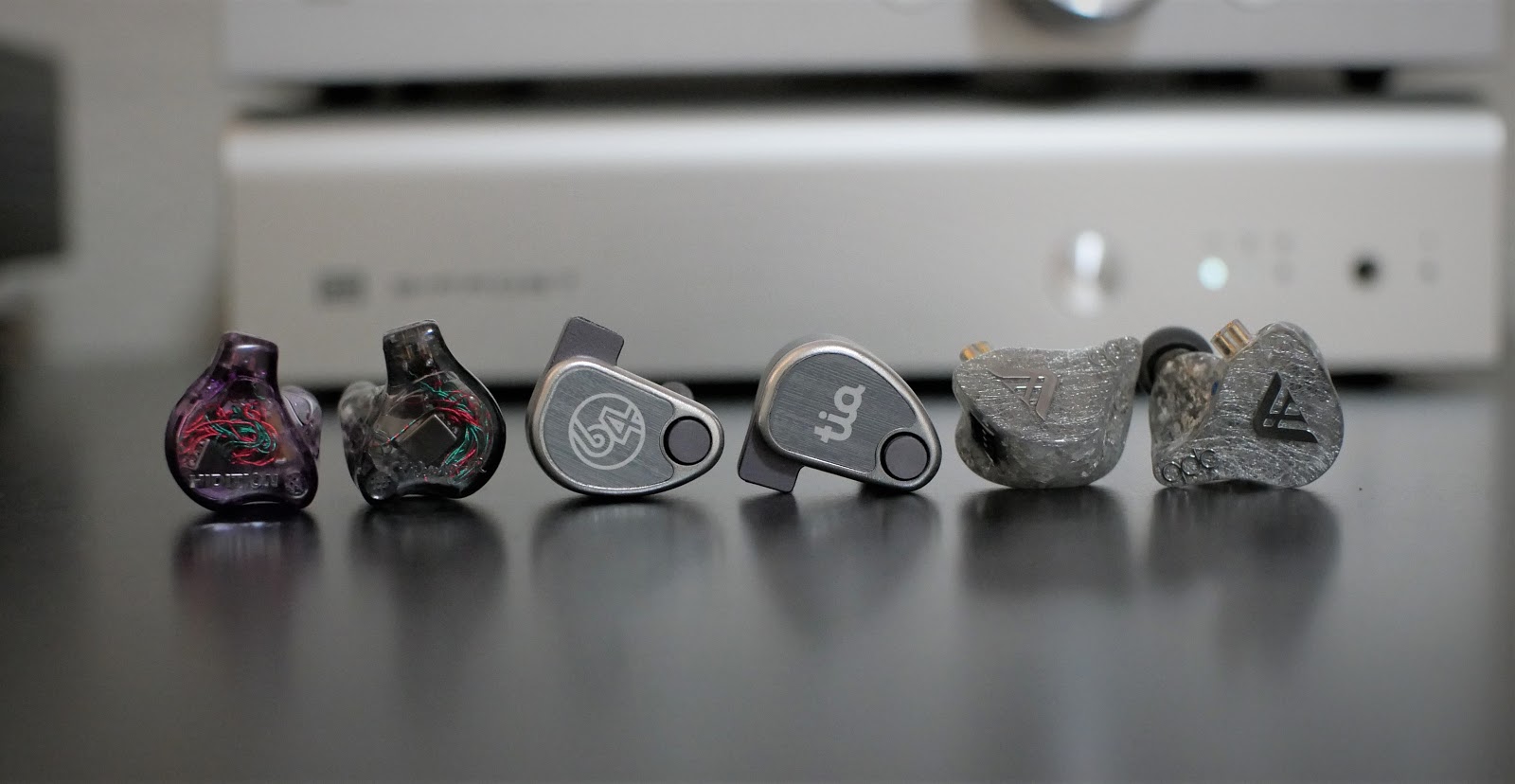

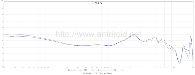

The U12t comes in a rather large box for how small the IEMs are. Within the packaging are the two sides of the IEM, a black 2-pin cable, various tips, 2 Apex Modules (M15 and M20), cleaning brush, clip, and a plastic carrying case with slots of each item. I wasn’t a big fan of the included cable, as it’s not the most ergonomic and easy to use, nor was I a fan of the case. It’s quite utilitarian in that it has slots for everything include the module and cable tie posts, but I found it to look and feel quite mediocre and rather unfashionable, especially compared to the cases that come with other IEMs which are fabric, leather, or jewelry-style boxes.
The IEM has a teardrop-like shape and rather simple contours; however, the fit is very comfortable in my smaller and sometimes finicky ears. I had no issues putting them on and wearing them for hours. I chose to use Spinfit CP100 (small) tips with this IEM as I found it was the best pairing for fit and seal, as well as sound.

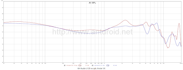

qdc Anole VX
When comparing this with the qdc Anole VX, I find they have some similarities as they’re both somewhat U-shaped IEMs. They both have rises in bass, a small dip in the mid-range and what I consider a good amount of pinna gain in the upper-midrange/lower treble and a small amount of treble extension. The U12t has more extended and bigger sub-bass performance, and you feel it with the lengthy rumbling decay, while the Anole VX isn’t exactly shy there either, but it is tamer, and more mid-bass focused with a little more more slam.
I found the VX to also have a little bit of warmer mid-range compared to the U12t, however I found the natural timbre of the U12t to be more correct in this area. The VX treble can be a tad hot at times, depending on the track, while the U12t is much smoother and toned down in the upper frequencies, and can reduce the energy and excitement factor in comparison.

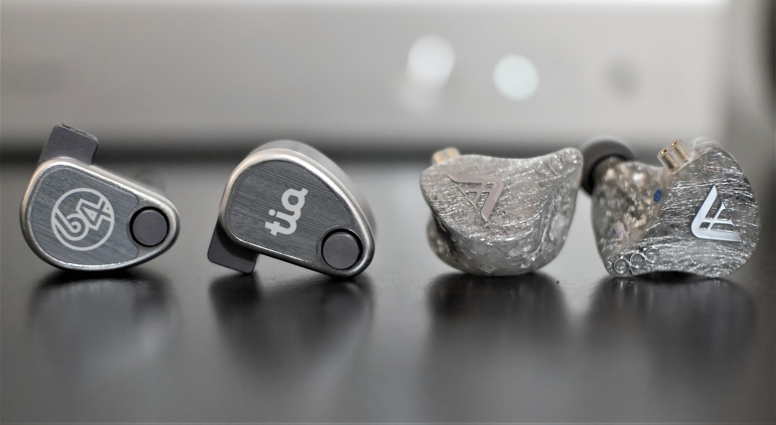

Hidition Viento
With respect to the Viento Reference Universal, which is the switched model of the Korean reference in-ear, I found the U12t to have a bigger feeling bass region compared to the Viento-B tuning, which I believe is the closest matching to the U12t’s total sound. That said, they don’t really match a great deal. The VIento-B is more agile and coherent through the mids with a really nice signature that never feels totally disjointed ever. It is a tad shouty and can be sometimes sibilant, at least in the universal fit, but this is only a problem with bad recorded pop music. The Viento’s pinna boost is much larger than the U12t and also has a more elevated treble range, though also has similar extension capabilities.
