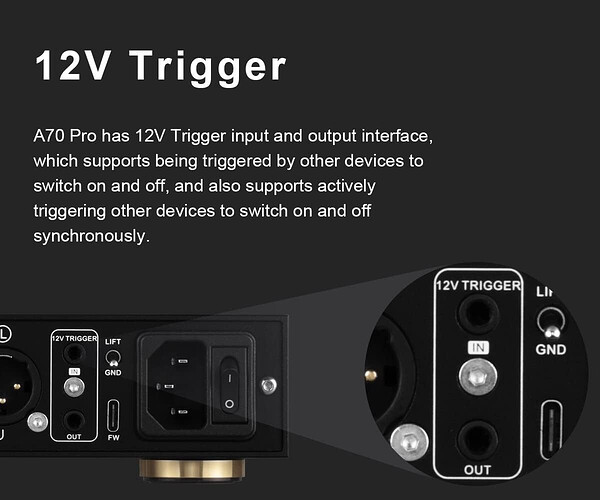

Pure speculation, but I’m guessing the 12V Trigger or one of the switches/buttons is defective or suffering from interference. This will remain speculation unless it stops when moved away from other cables and devices, or until the unit is taken apart and checked by a qualified technician. Per the Amazon page for the A70 Pro:
@hottyson may chew your ears off regarding Topping issues and service.
@generic it’s not doing it anymore, I moved it around and nothing to date. Has to have been what you suggested.
