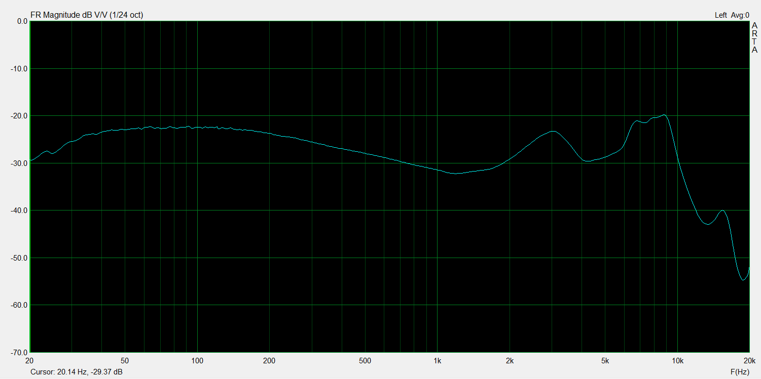

Alright, sorry about the wait guys. I’ve got the EQ file here.
https://cdn.discordapp.com/attachments/535786870995419137/598284353868529705/Final_E2000_Fix.peace
Just click on the link and it should download. I had uploaded it to a channel on a Discord server I’m in. Note, this file will only work in Peace. It won’t work with vanilla EqualizerAPO, or other PEQ’s. Just import the file into peace and it should work.
This is the EQ I use for my Final E2000 since it had come with very little 3KHz energy. Unit variance on these are a little nuts.
The after results. I’m still trying to figure out why the second resonance peak (or hump) looks like that. Perhaps I might need to recalibrate it.
