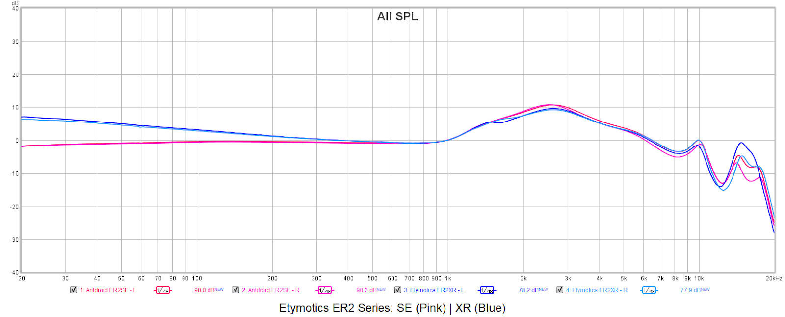

I have both the ER2 SE and XR in my possession now and here’s my measurements of both of the units:

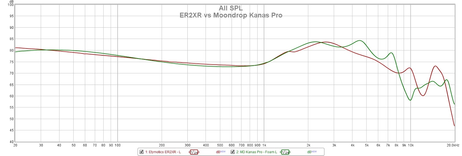

I wanted to touch base with a few other IEMs in this price range that I really like a lot. Namely, the Moondrop Kanas Pro and the BGVP DMS. They are considerably different than the ER2 but worth looking at.
Moondrop Kanas Pro
First the Moondrop Kanas Pro is a more Harman Tuning than the Diffuse Field tuned ER2SE, so right off the bat, you’re going to hear a lot more bass quantity and more recessed mids in the Kanas Pro than the ER2SE. The XR variant, however, does have a warmer bass boost, and actually results in a richer mid section that’ll make male vocals more thick and natural. The Kanas Pro will beat both variants in terms of soundstage and air, and gives it a much more open space. That said, the ER2s meet or exceed the Kanas Pro in details and just general tonality.
