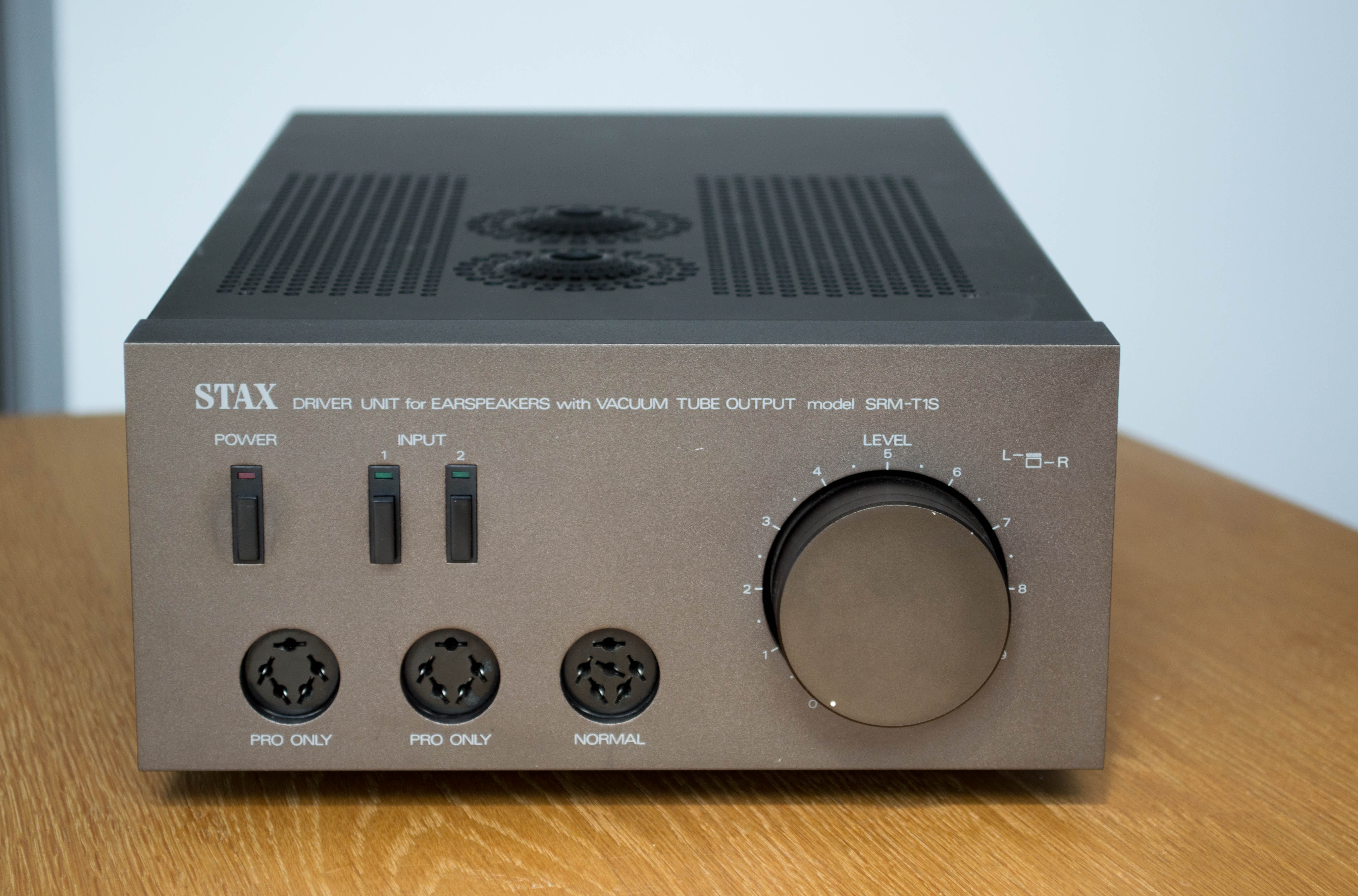

Well you convinced me. I’ve decided to go and buy a used but refurb/upgraded amp
https://mjolnir-audio.com/used-amplifiers/ This link works, but he took down the amp after I bought it.
The SRM-T1S shown here. It has normal bias for my existing STAX, and pro bias for any future STAX I may buy. I’ve corresponded with Birgir Gudjonsson- and invited him to the forum here. I think this is the best deal for my proposed use; I’m looking forward to trying it out. I’ll probably even write about it some.
If you follow the top link, Birger describes what he has done with it, using some of those KG parts where indicated in place of the original STAX setup.

I’m not planning on the flagship STAX phones until I pick the proper lottery numbers. But a modern lesser set is always possible.
Birger tells me that it has GE tubes that are perfectly good, but he finds the original Toshiba ones to be better, but hard to find. I’ll probably stay with the GEs for a while. I live only a few miles from a factory that used to make RCA tubes. There last products were TV tubes, cathode ray, and maybe some tubes for green or amber monitors. They were next to a FISHER plant that made VCRs.
