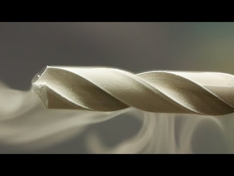

@Torq can I ask you something else? What about that cryo treatment of some cables? Is it esoteric, too or does it have any purpose? Is there an audible (or measurable) difference when cryo treated? As always: thanks

And I should note that I’ve heard responsible materials scientists say that there is no directionality in piece of wire. But I don’t think I’ve heard a clear discussion of cryogenic treatment. Anyone who can reply with serious pointers please do. I’m personally of the I’ll believe it if it’s superconductive school.
There are visible changes before/after cryogenically treating some materials when viewing the grain/boundary structures under an electron microscope. Proper cryogenic processing can, as with annealing processes, “relax” the structure and reduce the number/size of such boundaries (see prior discussion about these as related to OFC/OCC conductors), resulting in improved thermal and electrical conductivity and reducing internal reflection.
And certainly there are reasons for annealing or cryo-treating materials in engineering … usually to do with improved strength/resilience/consistency in extreme applications.
In terms of measurable electrical changes? Not really at audio frequencies, lengths and applications.
Audible changes? I would say not.
Most people cannot reliably hear distortion in musical material even as high as -60 dB. That’s about 0.1% distortion (and I’ve seen supposedly “trained” listeners blow that same test at -33 dB, which is 2.2% distortion).
Put that in perspective, the changes resulting in cryo-treating are going to be down around the same levels as Johnson noise, which for a human voice centered frequency, in a typical room temperature commercial conductor, is somewhere around -140 dB (or 0.00001% distortion …). When we care about such things, we actually OPERATE the conductor in cryogenic state rather than just treat it and then use it at room temperature.
And ALL of that assumes proper cryogenic processing … not the quick, relatively high-temperature, processes that bulk-processing of non-critical materials often entails.
As to why I did it on my own cables … it’s relatively inexpensive (smaller commercial processors charge by size/weight), people ask for it and it doesn’t do any harm. But then I also didn’t sell such cables with any claims of audible benefits.

For more info on cryogenic treatments:
