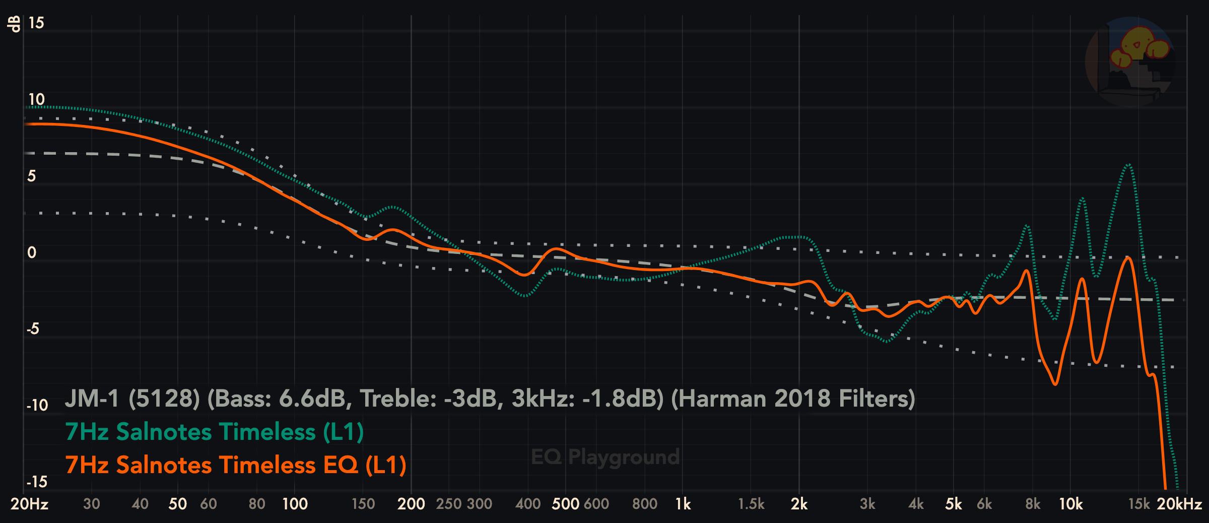

7Hz Timeless
Confidence: LOW
Uses data from B&K 5128
Preamp: -0.6 dB
Filter 1: ON LSC Fc 270 Hz Gain -2.3 dB Q 1.200
Filter 2: ON PK Fc 2000 Hz Gain -5.0 dB Q 1.100
Filter 3: ON PK Fc 3050 Hz Gain 3.2 dB Q 2.000
Filter 4: ON HSC Fc 7500 Hz Gain -7.5 dB Q 0.700
Filter 5: OFF LSC Fc 105 Hz Gain 0.0 dB Q 0.700
Filter 6: OFF HSC Fc 2500 Hz Gain 0.0 dB Q 0.420
Adjust band 4 for air
Adjust (and enable) band 5 for overall bass
Adjust (and enable) band 6 for overall treble

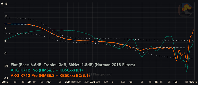

AKG K712 PRO please~!thx

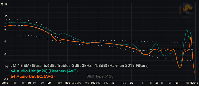

Hey, I know you were a big fan of the U6T. Do you use any EQ for it at all? I haven’t seen anyone share any presets for it anywhere so I thought I’d come here and ask the reviewer who still like them. Thanks.
AKG K712 Pro
Confidence: EXTREMELY LOW
Sidenote: This headphone is known for exceptionally-wide unit variation. Proceed with caution and tweak based on your impression of the sound.
Uses data from GRAS KB50xx and HeadAcoustics HMSii.3
Preamp: -4.6 dB
Filter 1: ON PK Fc 20 Hz Gain 2.4 dB Q 1.400
Filter 2: ON LSC Fc 82 Hz Gain 2.4 dB Q 0.700
Filter 3: ON PK Fc 250 Hz Gain -5.7 dB Q 0.400
Filter 4: ON PK Fc 1300 Hz Gain 2.4 dB Q 1.100
Filter 5: ON PK Fc 2100 Hz Gain -6.3 dB Q 2.000
Filter 6: ON PK Fc 3000 Hz Gain 3.5 dB Q 3.000
Filter 7: ON PK Fc 4225 Hz Gain -2.0 dB Q 4.000
Filter 8: ON PK Fc 5300 Hz Gain 3.6 dB Q 2.000
Filter 9: ON PK Fc 8000 Hz Gain -7.5 dB Q 1.000
Filter 10: ON HSC Fc 10000 Hz Gain 3.0 dB Q 1.000
Filter 11: OFF LSC Fc 105 Hz Gain 0.0 dB Q 0.700
Filter 12: OFF HSC Fc 2500 Hz Gain 0.0 dB Q 0.420
Adjust band 9 for sibilance
Adjust band 10 for air/sparkle
Adjust band 11 for overall bass
Adjust band 12 for overall treble
All I can do is give a preset based on one head because VSG’s measurement fixture doesn’t have a DF HRTF.

64 Audio U6t
Confidence: LOW
Preamp: -2.0 dB
Filter 1: ON LSC Fc 125 Hz Gain 1.8 dB Q 1.000
Filter 2: ON LSC Fc 240 Hz Gain -3.0 dB Q 0.800
Filter 3: ON PK Fc 2050 Hz Gain -1.8 dB Q 2.700
Filter 4: ON PK Fc 3250 Hz Gain 0.5 dB Q 2.000
Filter 5: ON PK Fc 4925 Hz Gain -4.2 dB Q 3.000
Filter 6: ON PK Fc 6450 Hz Gain 3.0 dB Q 1.400
Filter 7: ON PK Fc 14700 Hz Gain -9.0 dB Q 3.000
Definitely play around with every band’s gain, especially in the bass and treble.
Think its from WoodenEars or DMS, can’t remember, sorry!
THANK YOU ! Thanks. Thanks.
Thanks. I will try them out later when I can swap the modules to m20.
