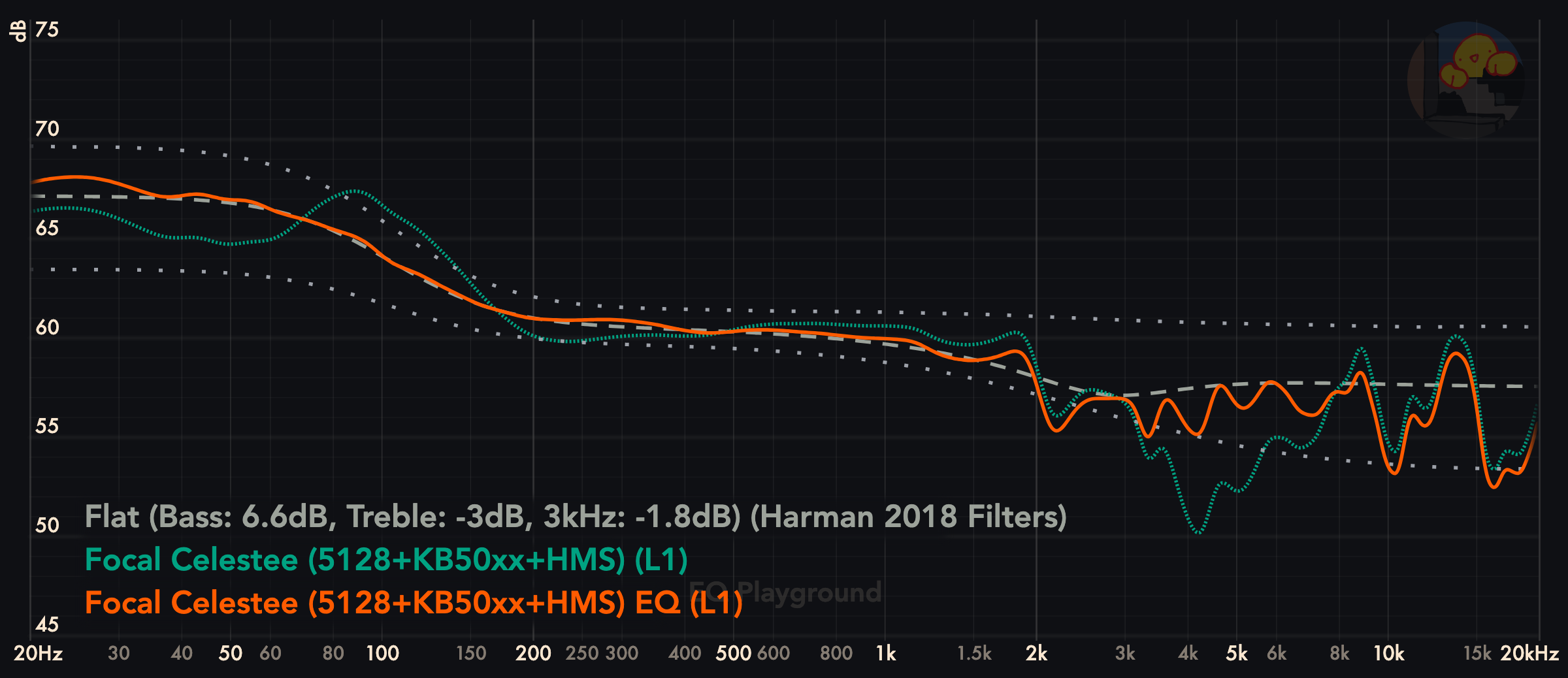

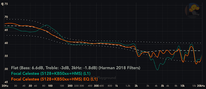

Focal Celestee
Confidence: VERY LOW
Uses data from B&K 5128, GRAS KB50xx, and HeadAcoustics HMSii.3
Preamp: -6.1 dB
Filter 1: ON LSC Fc 71 Hz Gain 3.6 dB Q 1.400
Filter 2: ON LSC Fc 160 Hz Gain -1.4 dB Q 1.400
Filter 3: ON PK Fc 210 Hz Gain 2.0 dB Q 0.600
Filter 4: ON PK Fc 1900 Hz Gain -0.5 dB Q 2.000
Filter 5: ON PK Fc 3100 Hz Gain -3.0 dB Q 1.400
Filter 6: ON PK Fc 3450 Hz Gain -1.0 dB Q 5.000
Filter 7: ON PK Fc 4175 Hz Gain 7.8 dB Q 1.200
Filter 8: ON PK Fc 7000 Hz Gain 1.0 dB Q 2.000
Filter 9: ON PK Fc 8800 Hz Gain -1.8 dB Q 2.000
Filter 10: OFF LSC Fc 105 Hz Gain 0.0 dB Q 0.700
Filter 11: OFF HSC Fc 2500 Hz Gain 0.0 dB Q 0.420
Filter 12: OFF HSC Fc 10000 Hz Gain 0.0 dB Q 0.700
Adjust and enable band 10 for overall bass
Adjust and enable band 11 for overall treble
Adjust and enable band 12 for overall air
