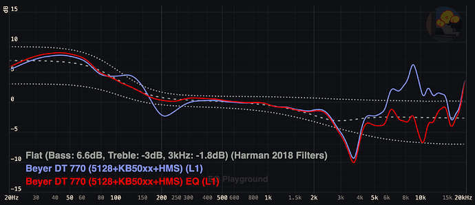

Could you make a profile for beyerdynamic DT 770 PRO 80 Ohm as well?
Thanks!
Beyerdynamic DT 770 Pro:
Confidence: VERY LOW
Uses data from GRAS KB50xx, B&K 5128, and HeadAcoustics HMSii.3
Just so we’re clear, the DT 770 is known to be a leaky boi, so bass will vary. It is also known to vary significantly with pad wear. I advise tweaking judiciously.
Preamp: -2.6 dB
Filter 1: ON LSC Fc 45 Hz Gain 0.5 dB Q 0.700
Filter 2: ON LSC Fc 110 Hz Gain 2.0 dB Q 1.410
Filter 3: ON LSC Fc 160 Hz Gain -2.0 dB Q 1.410
Filter 4: ON PK Fc 204 Hz Gain 2.6 dB Q 2.400
Filter 5: ON PK Fc 9500 Hz Gain -9.0 dB Q 1.410
Adjust filter 1 for sub-bass leak compensation
Adjust filter 2 for bass shelf size (gain) and shape (Q)
Adjust filter 5 for treble cut
Hey, this sounds pretty good ![]()
