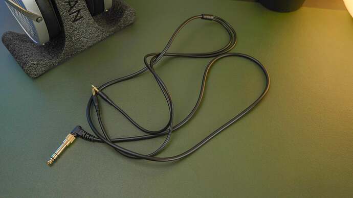

The cable is the big surprise here… I honestly really like it. It’s probably the best stock cable I’ve received with a headphone anywhere near this price. It’s not especially “luxurious” in its look, since it’s just a simple black rubber-sleeved cable, but the feel in the hand is actually quite soft for a rubber cable, and it avoids tangling very well and also has a very forgiving shape memory. While the accessories package here may not look all that impressive, every part of the package is well-considered and offers great value with a headphone that ultimately isn’t that expensive. Good start.

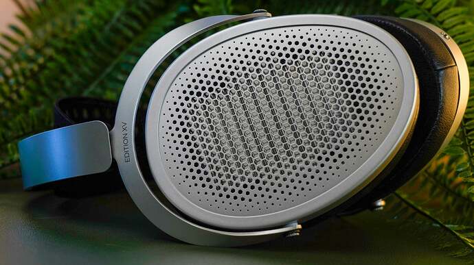

Visually, I much prefer the new “hexagonal hole” grille design to the old “grill marks” grille design, especially since the color scheme has been simplified to only silver and black and the headband’s outer face now matches the color of the grilles/earcups.

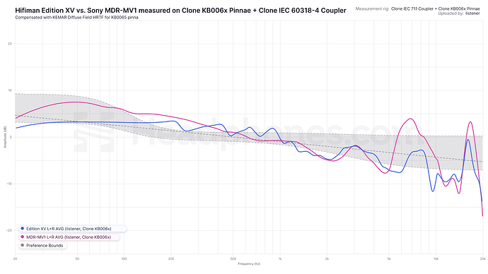

MDR-MV1 is my favorite “V-shaped” headphone, both because the way it handles delivering that kind of sound is the best I’ve heard but also because its weight, comfort, and industrial design are pretty exceptional.
I fear that, at least sonically, the Edition XV is a clean sweep here too. It’s a more linear midrange presentation, the mids balance much better against its bass than the MDR-MV1’s comparatively boomy bass, and the treble is way smoother and less problematic than the MDR-MV1’s.

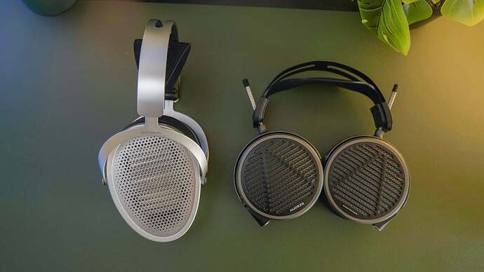

Vs. Audeze MM-500
Despite the price differential… Another clean sweep.
For one, the MM-500 is very uncomfortable, being both heavier and clampier than the Edition XV while having an even worse head-strap (in stock formation, I have the Capra Strap on the MM-500 right now).
But also I feel like Edition XV accomplishes the “warm neutral” thing way better than the MM-500 does. MM-500’s main strengths are its relaxed treble and its linear midrange, but the truth is that its midrange is overly lean thanks to the forwardness in the 1 kHz region, which means the linear bass comes across too thin and limp. Additionally, for me its treble is both too dark in some spots (4-6 kHz) and too bright in others (13-14 kHz).
Edition XV has basically none of these problems. The warmer midrange—thanks to the 2 kHz dip—brings forward the bass to be more prominent, enough so that it no longer sounds bass-light, and also makes the presentation overall sound less small and shouty.
The more impressive thing is that the XV executes the “dark treble” archetype way better here too, fixing the biggest treble issues, filling in the low treble enough to no longer be an issue, cutting the uppermost treble, and keeping the darkness I prefer around 10-12 kHz. All of this works together to flat out unseat the MM-500 as my default “smooth” planar. Many people called the MM-500 the “HD 600 or 650 of Planars” upon release, but honestly, that title is probably much more fitting for the Edition XV. Speaking of which…

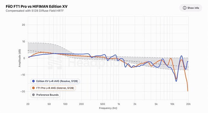

Great review! How would you compare these to the FT1 Pro?
Really interested in this comparison. I’ve been looking for planar headphones that are as neutral as possible, but still have that strong bass slam in the Audeze style. My only experience with Hifiman was with the Massdrop x Hifiman HE-35X, and honestly, they were a complete disaster — to be fair, they were dynamics, but the treble was absolutely unbearable.
I would say the main difference that kind of dictates everything is the treble difference here. Because the XV is darker in key spots around 5 and 10 kHz, the treble response sounds a lot smoother and more relaxed relative to the FT1 Pro. What this also means is that the midrange and bass sound louder relative to the treble, so the Edition XV is both a more midrange-focused headphone than the FT1 Pro, as well as one with a more compelling, full bass presentation thanks to the lower and center midrange being relatively much more pushed. I don’t find the FT1 Pro particularly impressive in any subjective aspect but in basically all of them I hear XV to be a meaningful improvement (but again, this could very well be down to how much better its treble works on my head vs. other headphones)
Hope that helps!
