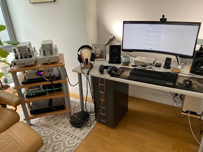

Understanding this may not be possible or practical for everyone, I keep an audio rack next to my desk (rather than having my gear on my desk), thus theoretically avoiding such issues. My important equipment is not sharing (nearby) physical space, electrical connections, or data connections with my desktop equipment. It’s a magnificently quiet setup.
@andris It looks like you are the recommended 3 feet from sources. Looks nice and yet still handy
